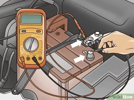

You might consider checking for a parasitic load by removing the neg(-) battery cable and placing an ammeter between the cable and the battery terminal.
Use the highest amp range first (typically 10A) to avoid a blown fuse in the meter.

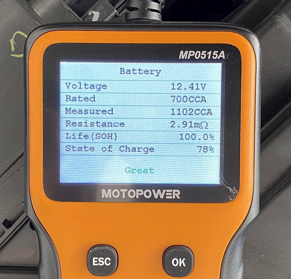

I bought a cheap battery tester from Amazon. Here is my status after 5 weeks and 1200 miles on the Enhanced Flooded Battery.
Ford Bronco Sport 2024 BS Badlands -- Delivered with enhanced flooded battery Dec21.JPG

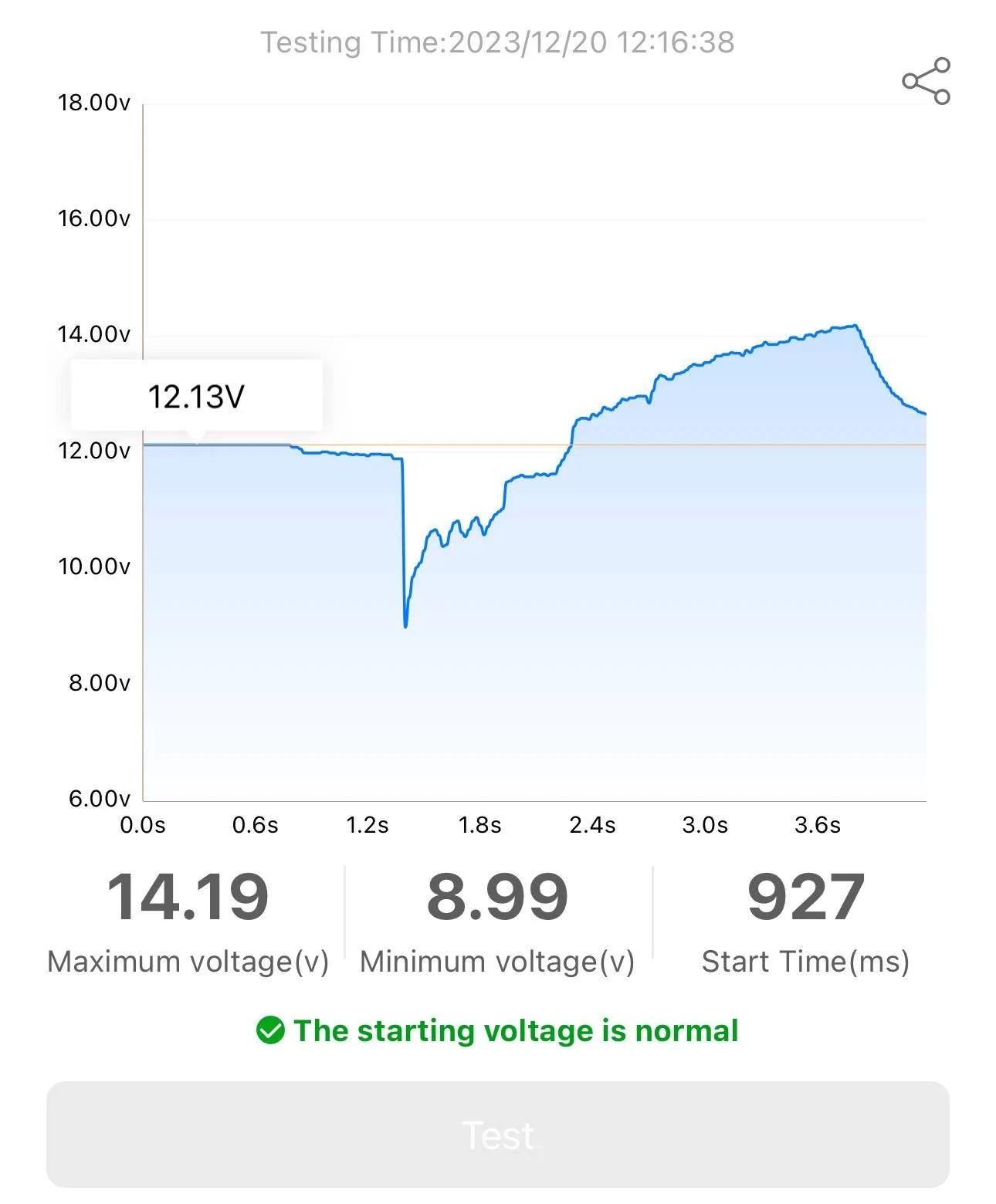

Either something is severely wrong with the battery or there's a large parasitic draw. I haven't hardwired anything that isn't factory. The 12V "cigarette lighter" powerpoint below the radio turns off within 5-10 seconds of ignition off door open, but just to rule out a cause of any non-factory load, I've unplugged it. Putting the battery back on the charger.Called the dealership back and the first person who answered couldn't find any customers they've service for parasitic draw at their location. She told me she would circulate the issue with a more senior technician and have them give me a call back.
Bear in mind this test is this morning, 41 hours since charging it with a wall charger.
Car off, battery tester directly to the battery:
Ford Bronco Sport 2024 BS Badlands -- Delivered with enhanced flooded battery IMG_6751
In car, accessory power on, engine off. It quickly declined from 11.6 to 11.3 volts. At 11.4 volts my radar detector spoke "low battery".
If the issue goes away with the accessory power unplugged, I at least have some control of it until I can work out when to get a fix (maybe a software update for whatever module controls the powerports). I am doubtful this is the case but it's the easiest thing to test, and if it is the case, my splitter has a physical on/off switch I can use when entering/exiting the vehicle.
If the issue does not go away... this is a bumper to bumper service issue.
Unless of course, the wonderful mice who kept nesting in my car have chewed on something to cause damage. I don't see any obvious nesting material, signs of mouse presence, or damage in the engine bay, but that does not mean that the mice could not have chewed on something that is in a difficult to see or impossible to see (without removing parts) area of the car...
My $18 aliexpress battery tester (convenient and pocketable) can test for voltage state of charge and a cranking test... but it does not do a load test. So off to Amazon I go to spend $21 on a different one (with a small LCD screen, no bluetooth) that will do an alternator test and an actual load test to see if it's the battery or not. I realize the dealer can run a load test, but for the price, convenient enough to just keep around home.
EDIT: Dealer tech tells me that 11.98V is basically 12V so that's "normal" which... contradicts every other resource I've ever seen. I'm probably just going to either battery load test it myself or go to an auto parts store to see if the load test fails.

Check the specs on both battery test devices (the one you have and the one you plan to order). If they spec readings at +/- 0.1V a reading of 11.95 could be 11.85 to 12.05 which is a range of ~34% to 50%.
