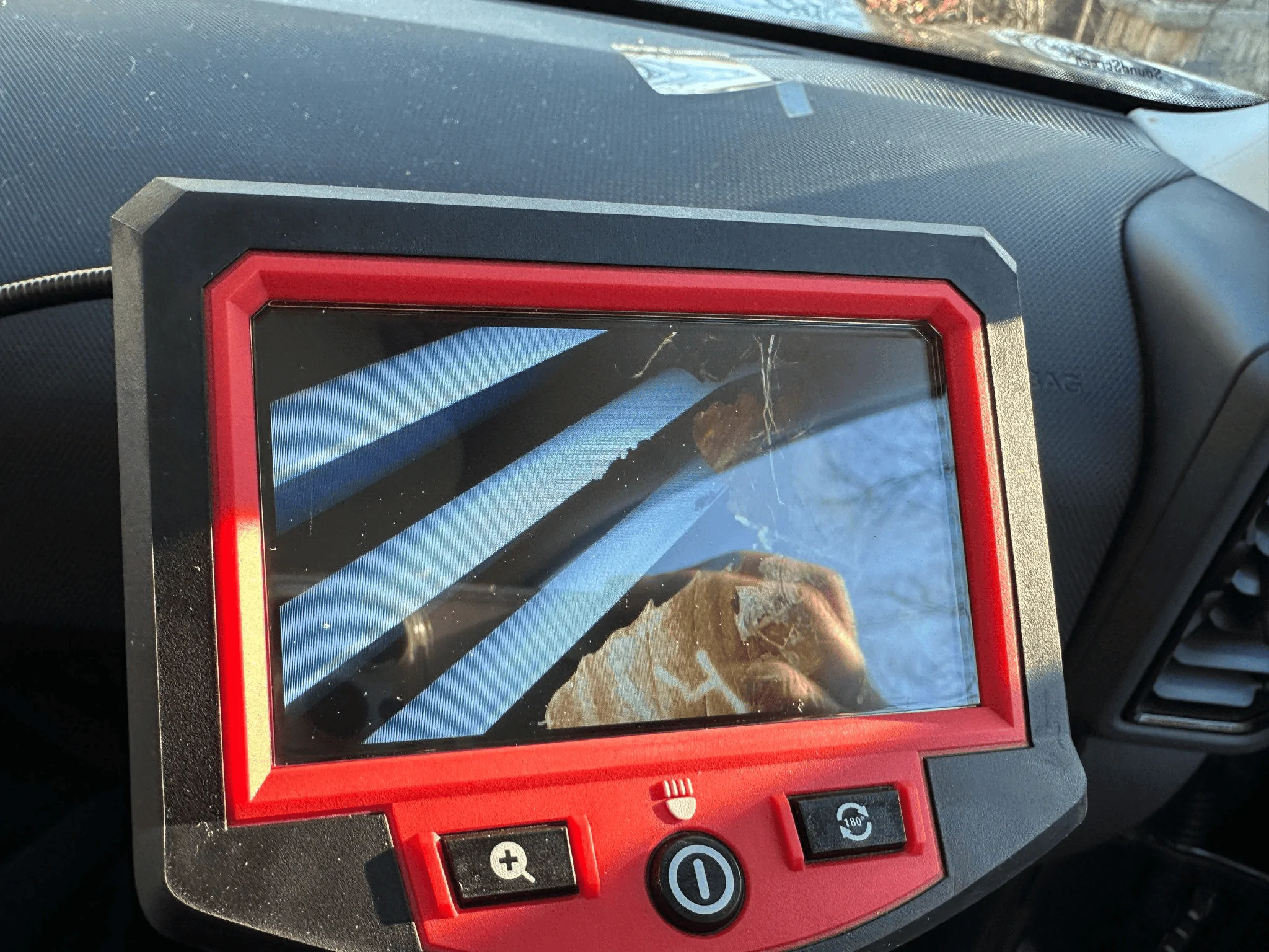

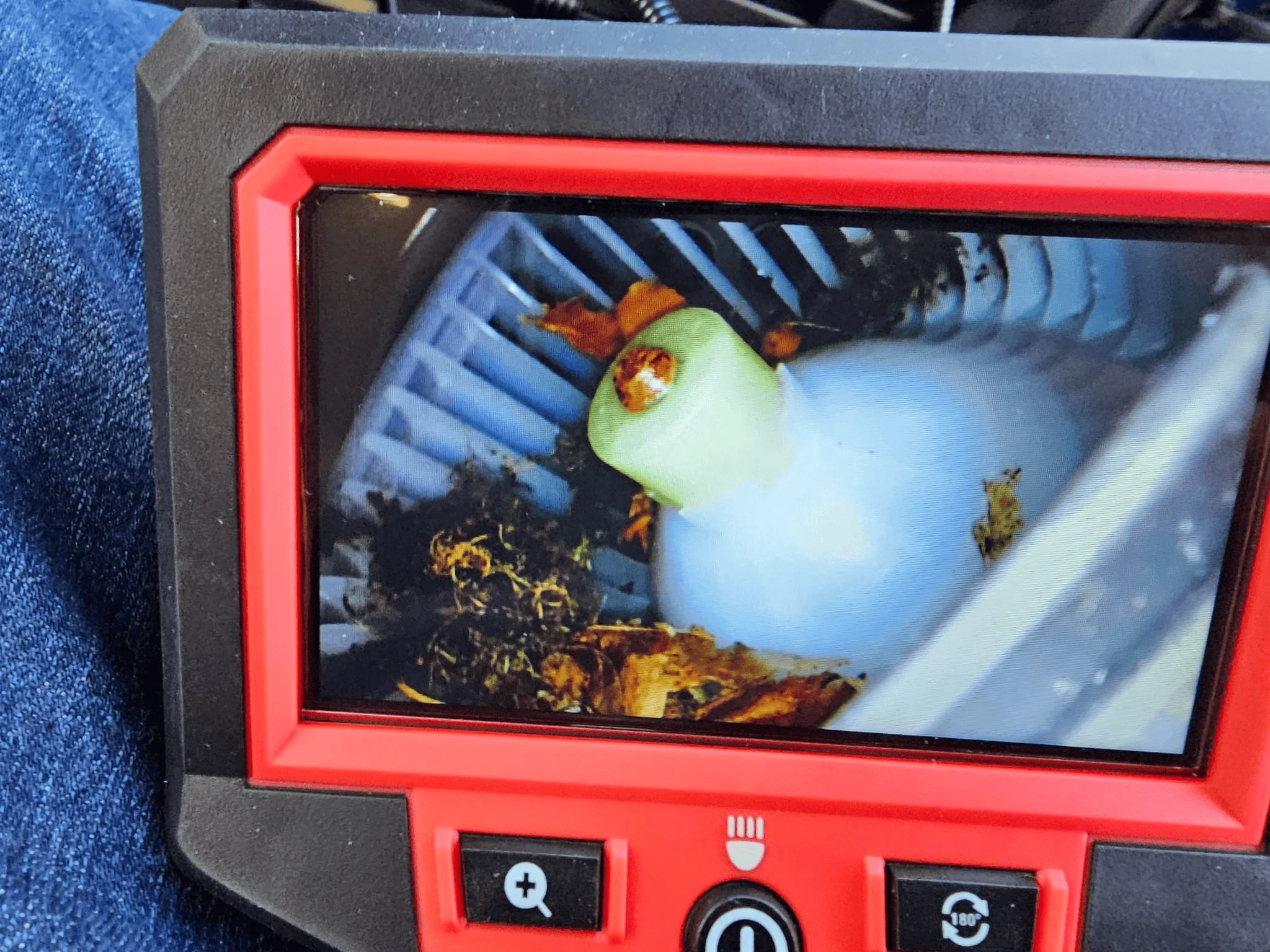

Finally bought a fiber optic inspection tool at the home depot to inspect the fan and housing below the air filter. I'm not sure if it's material that was on top of the filter that fell when it slid down, or if the mouse was nesting down there:

Either way, signs of the mouse/mice being present below the air filter are present. At least one chewed on the plastic fan blade:

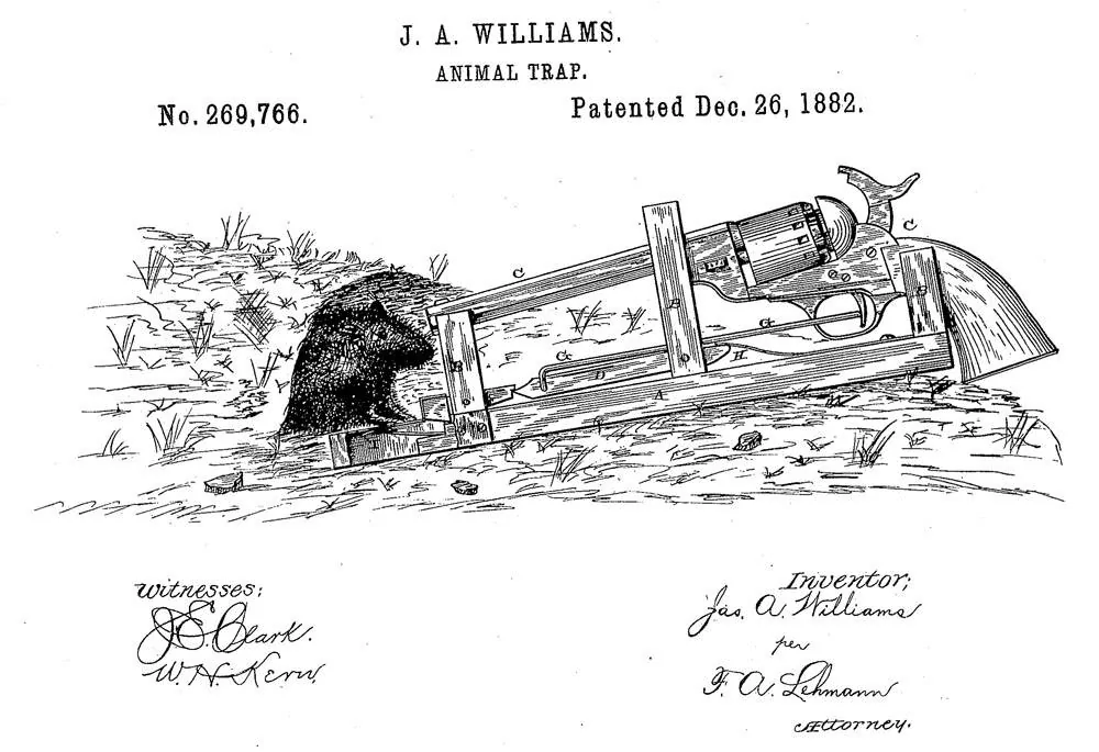

Humane mousetrap that kills instantly? How about one of these?
Just kidding, of course. :crackup:
Ford Bronco Sport Deterring mice from the BS (nesting on cabin air filter) gun-mouse-tra

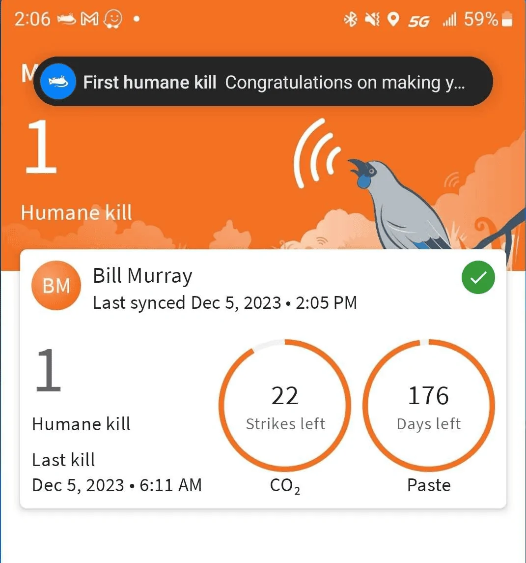

So an update on the war on mice: A combination of trapping and baiting has killed three mice in total. We are unsure if there is still an issue. One mouse died outside another vehicle in the driveway (bait/poison), one died underneath the passenger seat of a vehicle (bait/poison), one died in a fancypants trap:
Ford Bronco Sport Deterring mice from the BS (nesting on cabin air filter) 1702225209378
(The trap has been named Bill Murray in tribute to how the groundhog drove his character nuts in Caddyshack.)

The smart mouse trap has claimed four mice thus far, with three of those in the last week. It seems that merely automatically feeding bait above the mechanism isn't enough, and prebaiting on the stand so the mice get to taste the nut butter and are jonesing for more is the optimal approach. The fact that the trap alerts me when the mice are being humanely killed has given me some insight (all of the mice have died between 5AM and 7AM; colder nights seem to increase their hunger.) The trap is waterproof and did fine with the three inches of torrential rain (which will likely increase mouse activity, as existing nests are likely flooded out).
A nice plus is that the trap automatically re-arms, although this seems to not matter as it seems that I'm only getting one mouse a day tops anyways, because the mice are hungry enough to eat all the prebait before going into the trap mechanism. Also because the trap is at an angle and automatically resets, the mouse drops into the base of the stand, and I can dispose of it without handling the trap. The trap is ungodly expensive, but I do take solace in that I'm killing the mice in the most humane way possible (versus a trap like the rinnetraps lid, where you're either trying to dump live mice somewhere else, or subjecting them to drowning if you make it a kill trap).

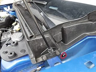

I did use the fiber optic camera to confirm a theory: the most likely source of ingress to the cabin air filter. These two holes go directly below the windshield cowling and are plenty big for mice to get into. If you park your BS BL outside, I would strongly consider covering these holes with metal mesh (which will still permit drainage, but the mice won't want to chew) so you might avoid the escapades I have experienced, at least to the extent of them nesting directly on the cabin air filter:
