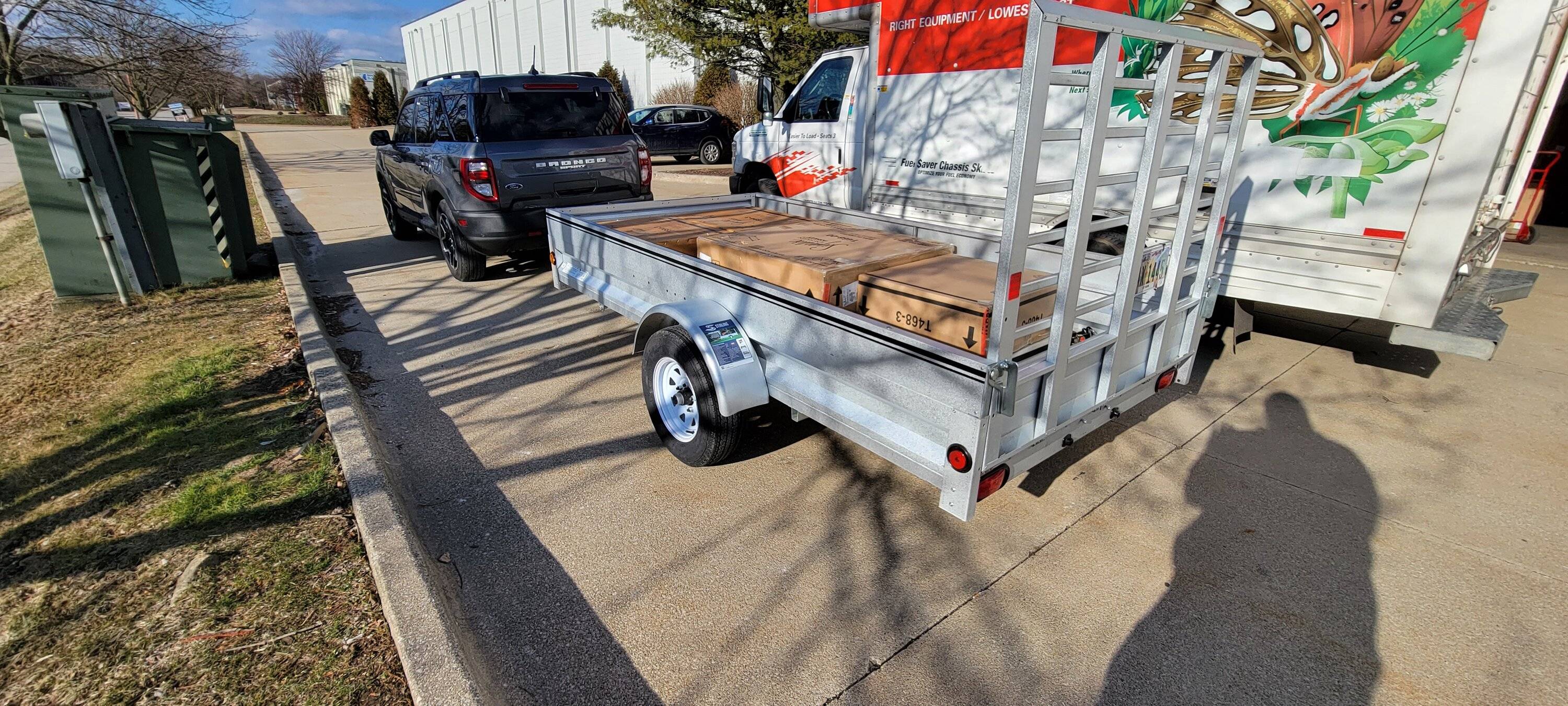

Made my reservation last night. Opted for the 4x8 trailer over the 5x8 out of an abundance of caution with the first tow. Nervously excited to see how this goes this weekend - West Lafayette, IN to Greensboro, NC.
