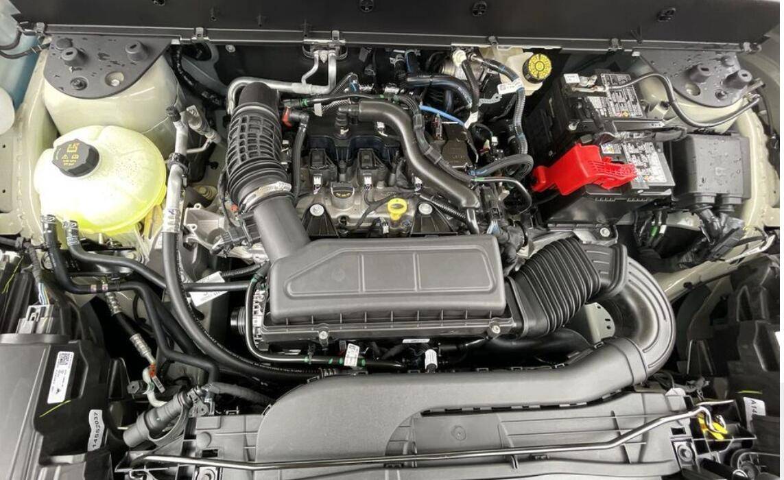

Being that I do not experience this noise, this thread inspired me to open up the hood to look out of curiosity. I found that my coolant level is extremely low… Bringing it up to my dealer tomorrow morning to have it looked at. Praying that it isn’t a water pump or anything ??

Good news no leak detected everything looked great! Pressure test showed no issues luckily. They even test drove it to make sure they didn’t smell anything or see anything weird and nothing came up and coolant level stayed the same after the drive. He said it actually wasn’t even low quite yet before they topped it off but they added a little anyways to be safe.
