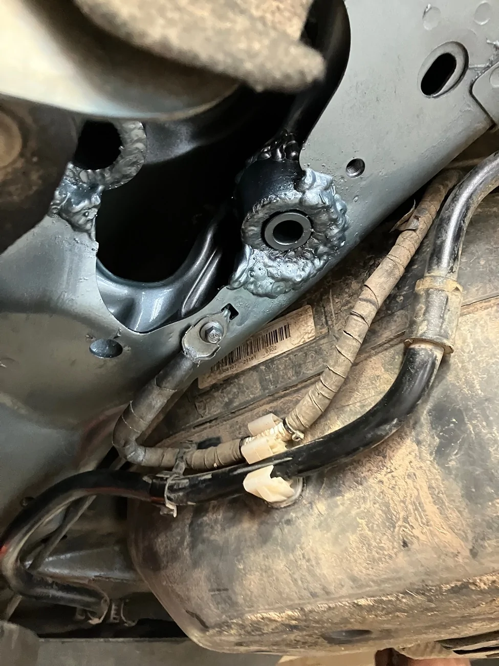

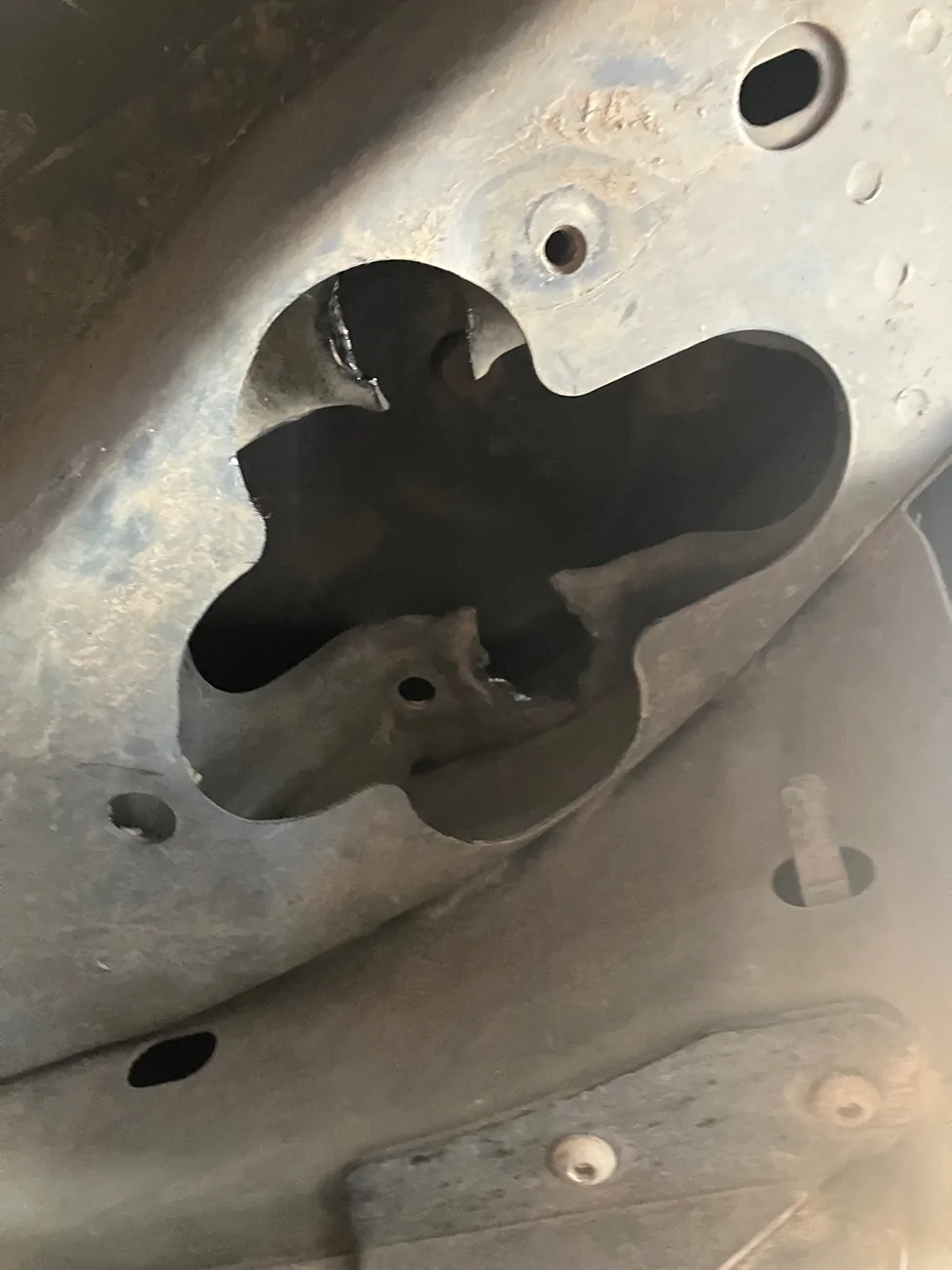

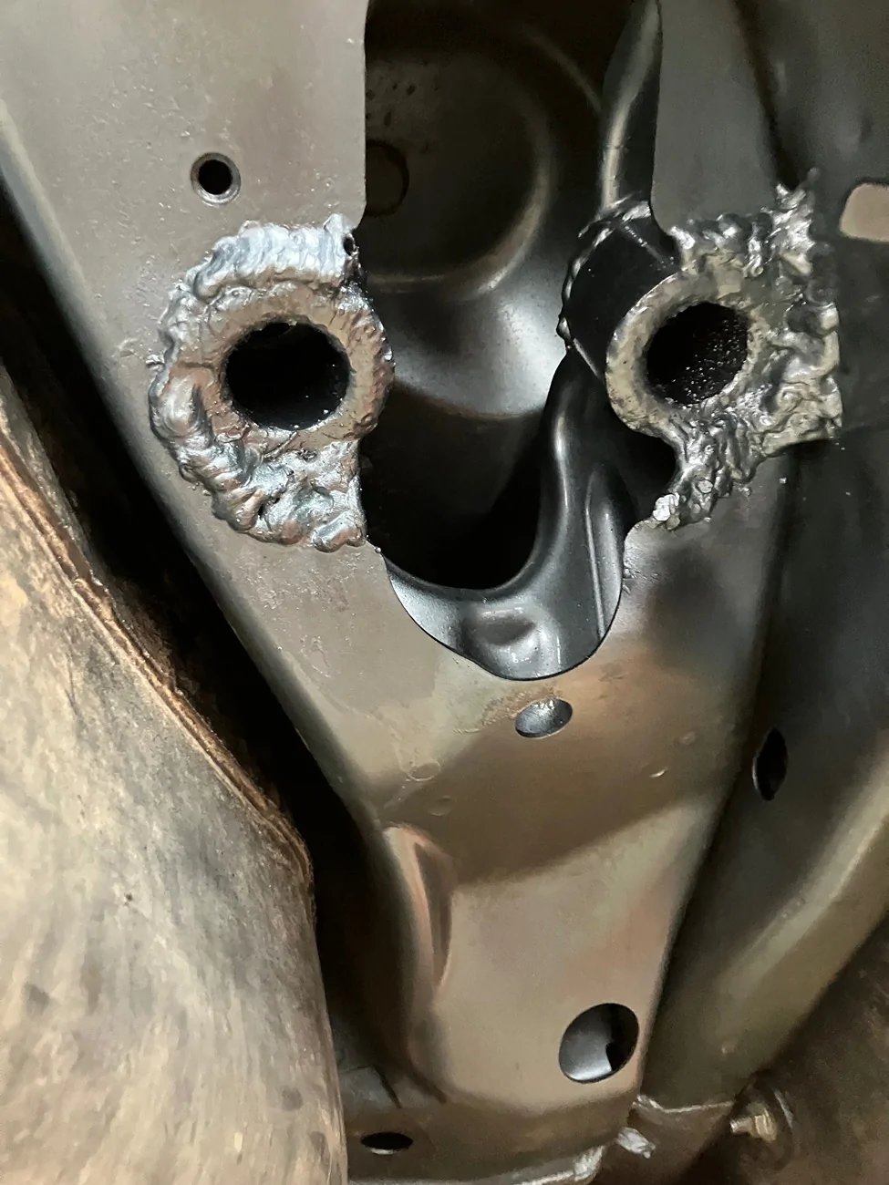

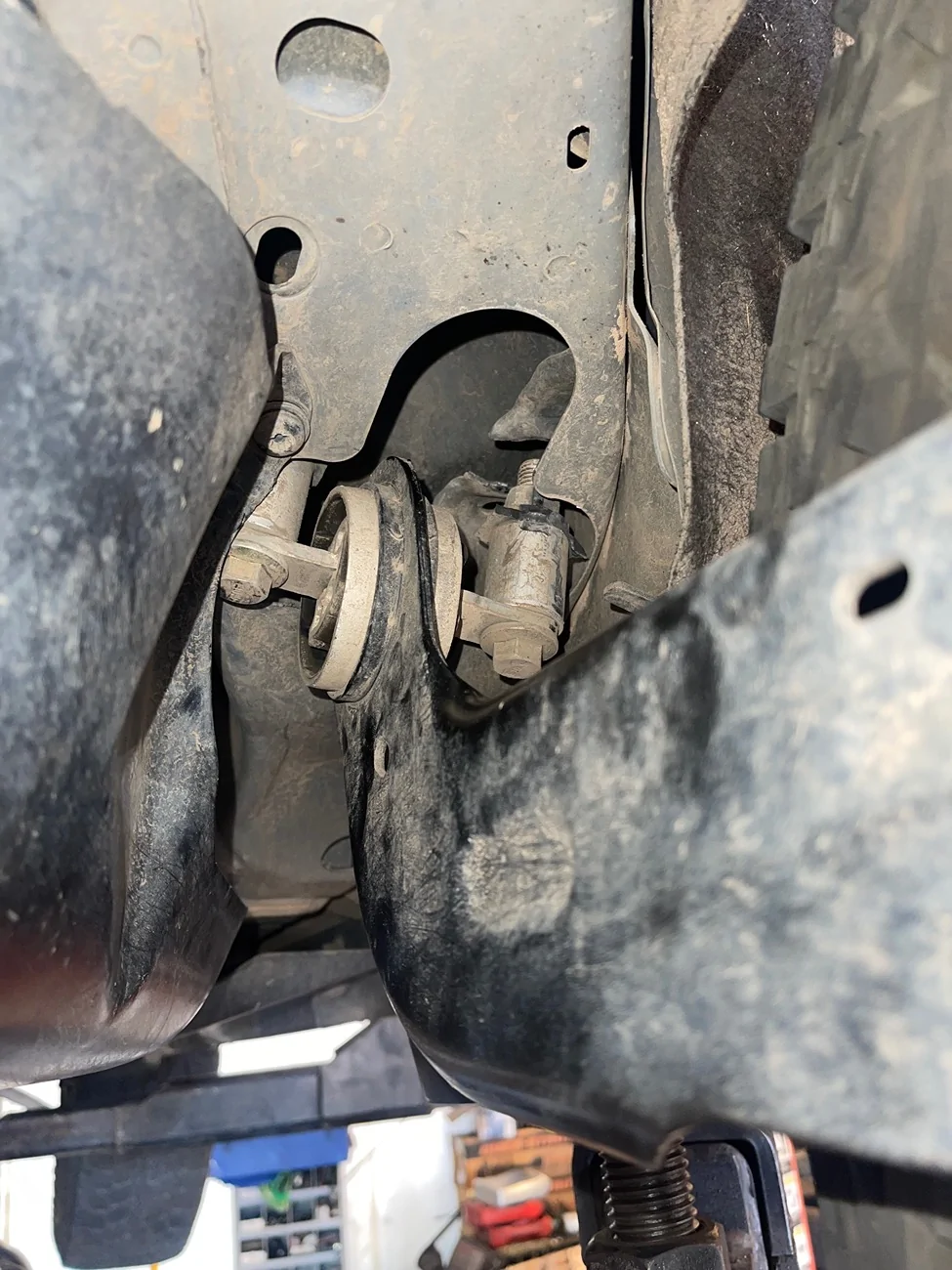

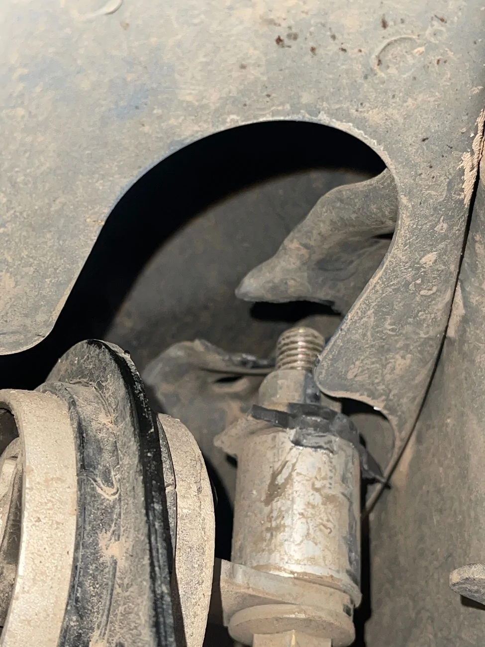

S’up Sportsters! It all ends well but I want to share my experience of really breaking BOTH my rear trail arm/knuckle attachments to the unibody rails.
Disclaimer: This is NOT the recommended “factory fix” from FORD. The views and thoughts expressed here are not that of FORD or given as expert advice to a permanent fix. This is my own experience for educational and anecdotal purposes.
This year, 2025, I attended the Bronco Safari in Vernal, UT. I was the only Sport at the event. I ran trails rated 2, 3, and 4. I had a great time and judiciously picked my lines. They are organized for safety and have great Trail Bosses as well. Besides some pinstriping, rock sliding, and a smashed exhaust pipe with some bumper bumps - all was good, no issues.
Heading back to CA, I stopped and did an overnight in Dayton, NV at a friend’s. I decided to do a night run up in the Pine Nut Mountains, BLM, This is where I think the FINAL breakage occurred. I feel this breakage was a result of a series of events that led to that night. Possible hairline fractures were caused at Bronco Safari or at my other previous off-roading adventures. “Ticking time bomb” comes to mind.
The Sport has its limits and I have pushed it hard. I have gone over this in my head and I have concluded this: Any vehicle, AWD or 4x4, will break something if pushed beyond what it was designed for. Social Media has 100’s of thousands of videos and posts to prove that. Driver error or design flaw can also be debated. I admit I was the one who broke my Bronco. Many times I should have been “Crawl’n” rather than “Baja’n”. You will see in the photos the “paper thin” metal that the trail arms are bolted to. Descriptions of “weak point”, “weak support”, and “designed not for off-roading” were heard from others who inspected it.

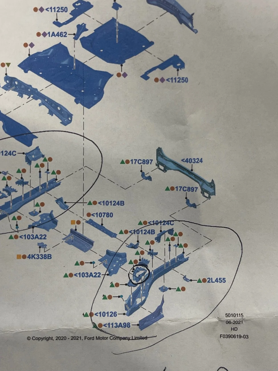

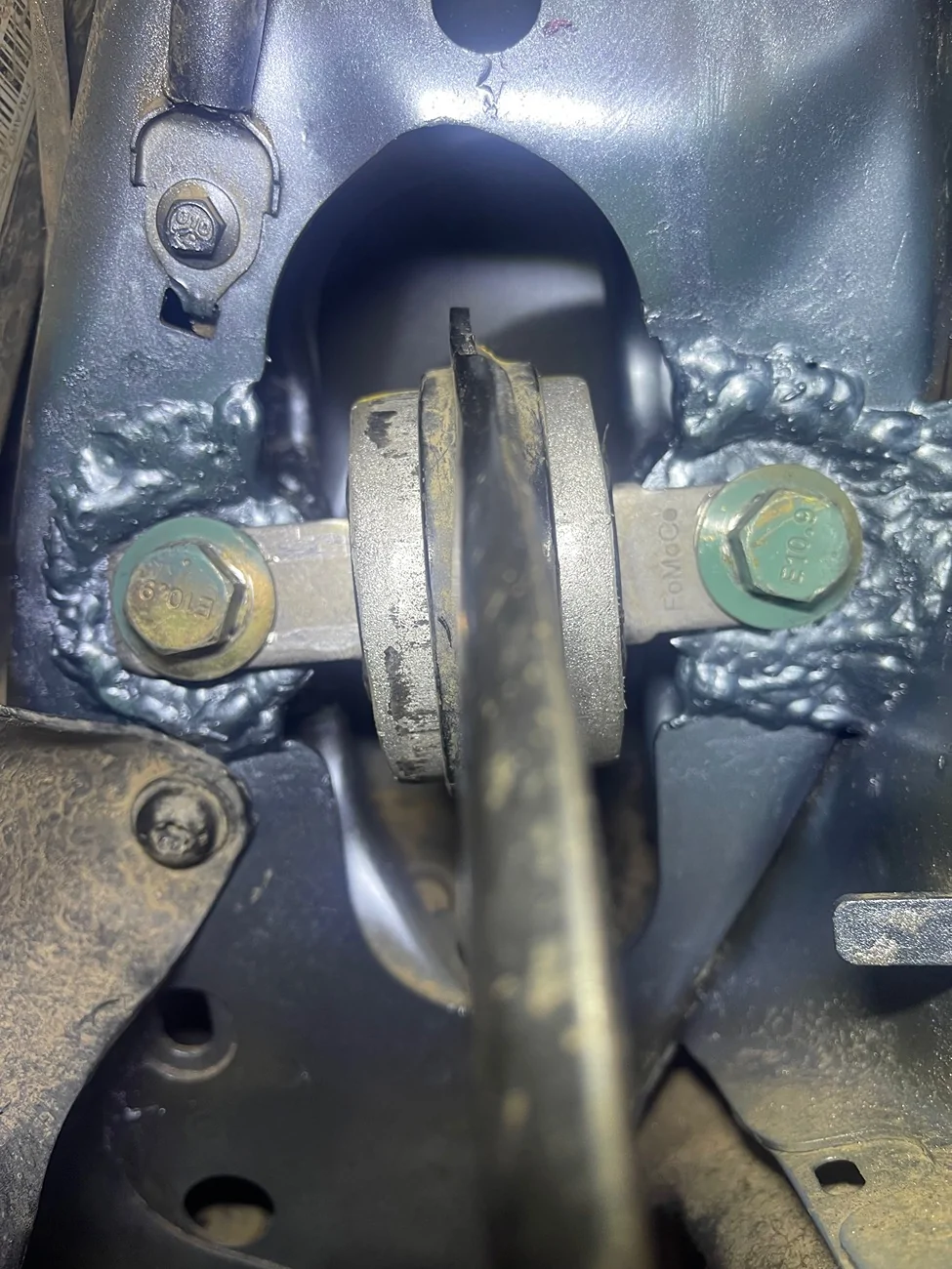

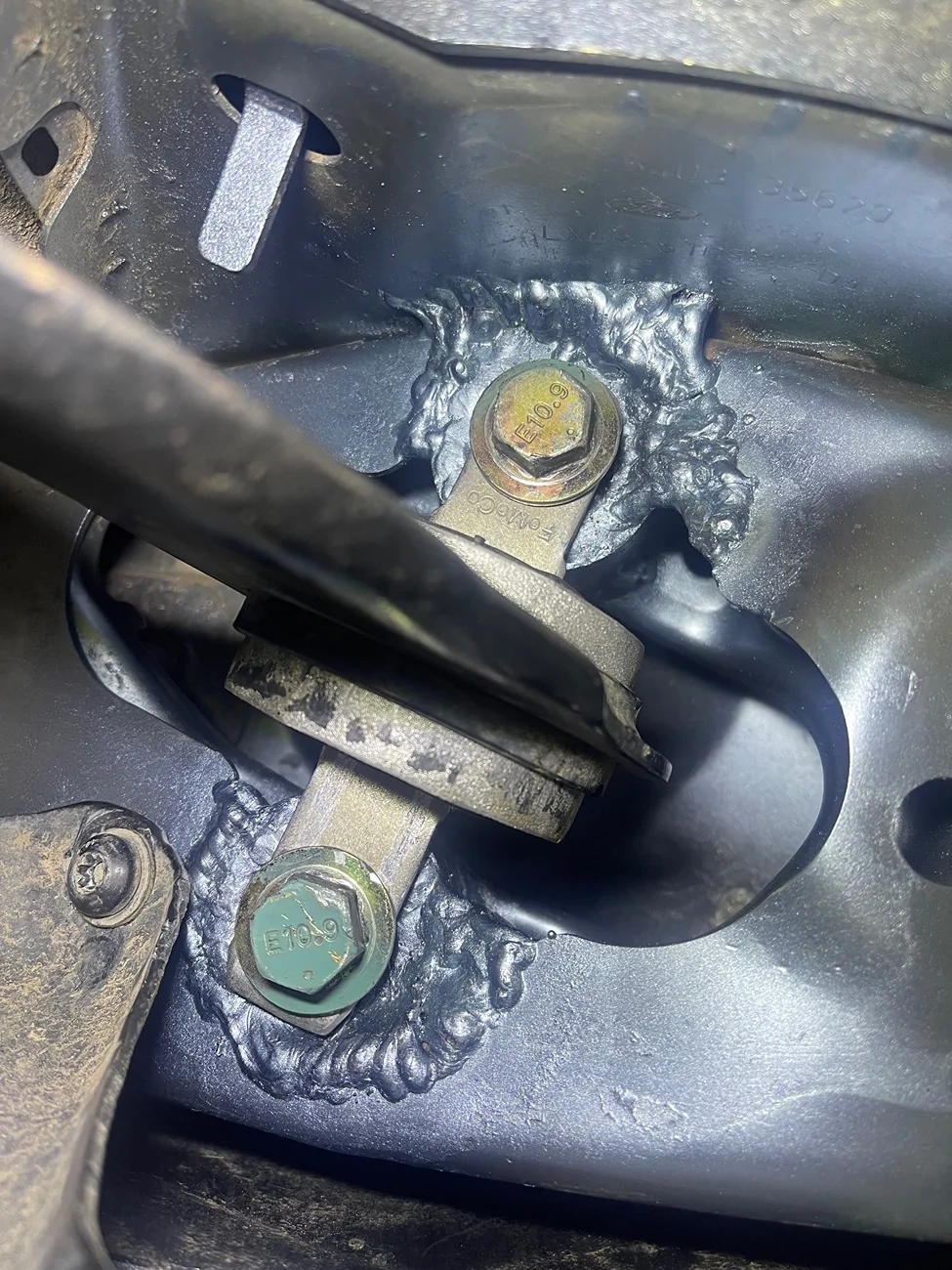

I was told the “factory fix” is to remove half the vehicle to get to the rails that need to be replaced along with all the trial arm components, etc. There was a high possibility the costs would have totaled my Sport out. I started looking for alternative fixes with or without my insurance coverage. Fortunately, I was able to get an experienced fabricator / car restoration shop to do the repairs in such a tight space. (See Photos).

Sheesh, that’s rough! If I’m understanding correctly it sounds like the breakage is more from repeated hard impacts on the rear suspension from going a wee bit too fast through some rough areas?

Pretty easy to see why that came apart... it work hardened that sheet metal and snapped off like the tab on a beer can. With your fix secured at both ends of the bolt it should be way stronger. Seems like it could have easily been built that way from the beginning. Must have been a real b-word to weld in that tight area.

Your fix depending on the actual weld prep and penetration should be way stronger than originally designed.
Aye, aye!

Was the Body lifted to weld ? The saying " ya gotta pay to play " comes to mind .
Have you done a four wheel alignment ?

Yes it's a unibody . but what had to be removed to get at it ? The paint job & how dirty it was before the repair & the repaint seems to match up real good . Was anything removed from above the welding area in the interior to protect it .
Was any reinforcement done besides weld ? What a job to get at .
I’m gonna answer both your posts here.
you describe the FORD factory fix by taking half the vehicle apart and replace the broken u-channel and railing.
So all welding was done without removing body parts. . Of course all the rear components were removed. Nothing was removed from the interior.
He welding at 3 different points for reinforcing
Planing to do an alignment next oil change and rotation.
Still rides solid .
