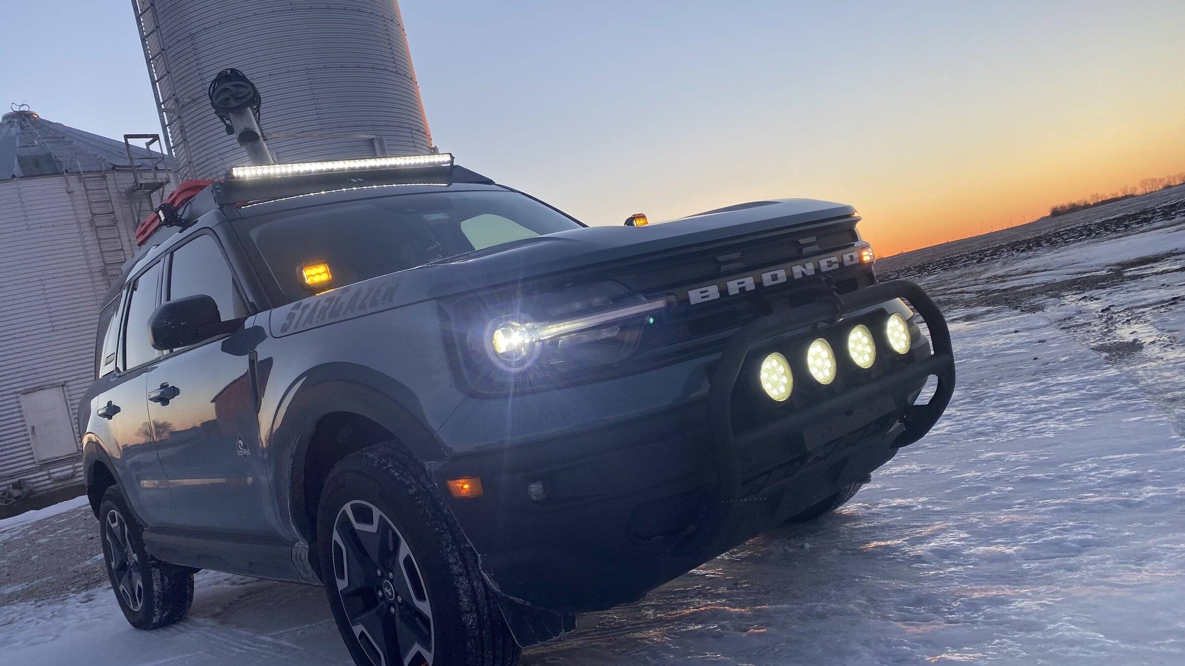

So here is my experience. I had ordered the Rough Country lift kit when they releaed it and after seeing multiple people complain about them and how cheap it was i returned it. The kit was not as nice as this kit I got from HRG Engineering in my eyes. HRG's kit is made in the USA and works amazing. It only took me about 2 hours to get it installed. So if anyone is looking for a good kit I would recommend HRG Engineering. We also made a video as we are building this Bronco to wheel and take places our other vehicles wont.

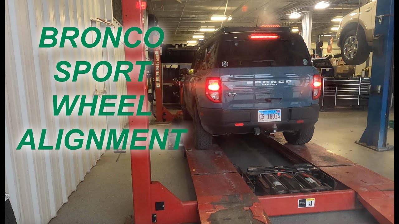

We live in Pontiac Illinois. We can do the install but you will still need to do the wheel alignment. We have ours in the shop as i am typing this and plus the tires come in today so we are getting the new tires installed as well. So whole new change to this beast.
