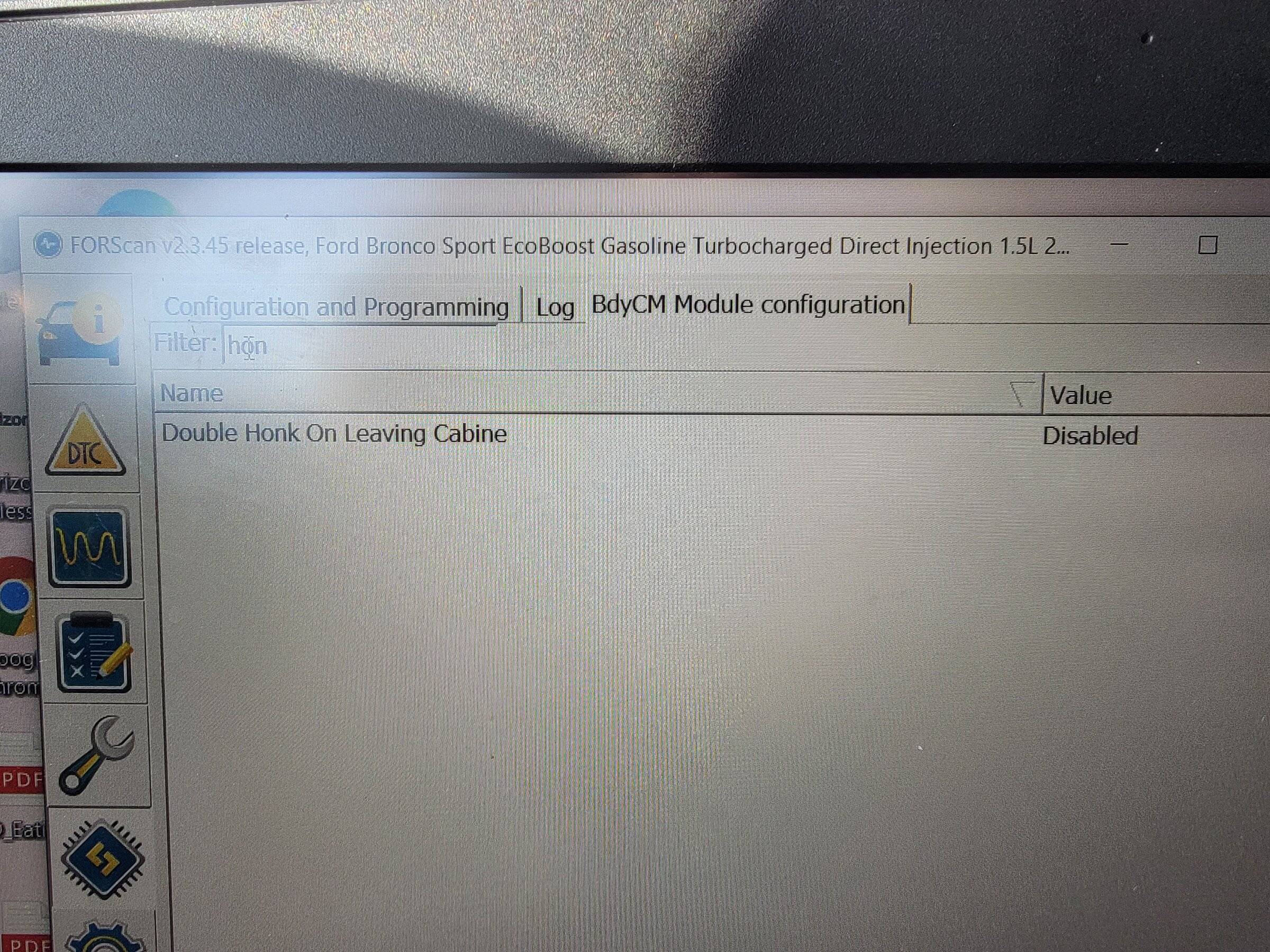

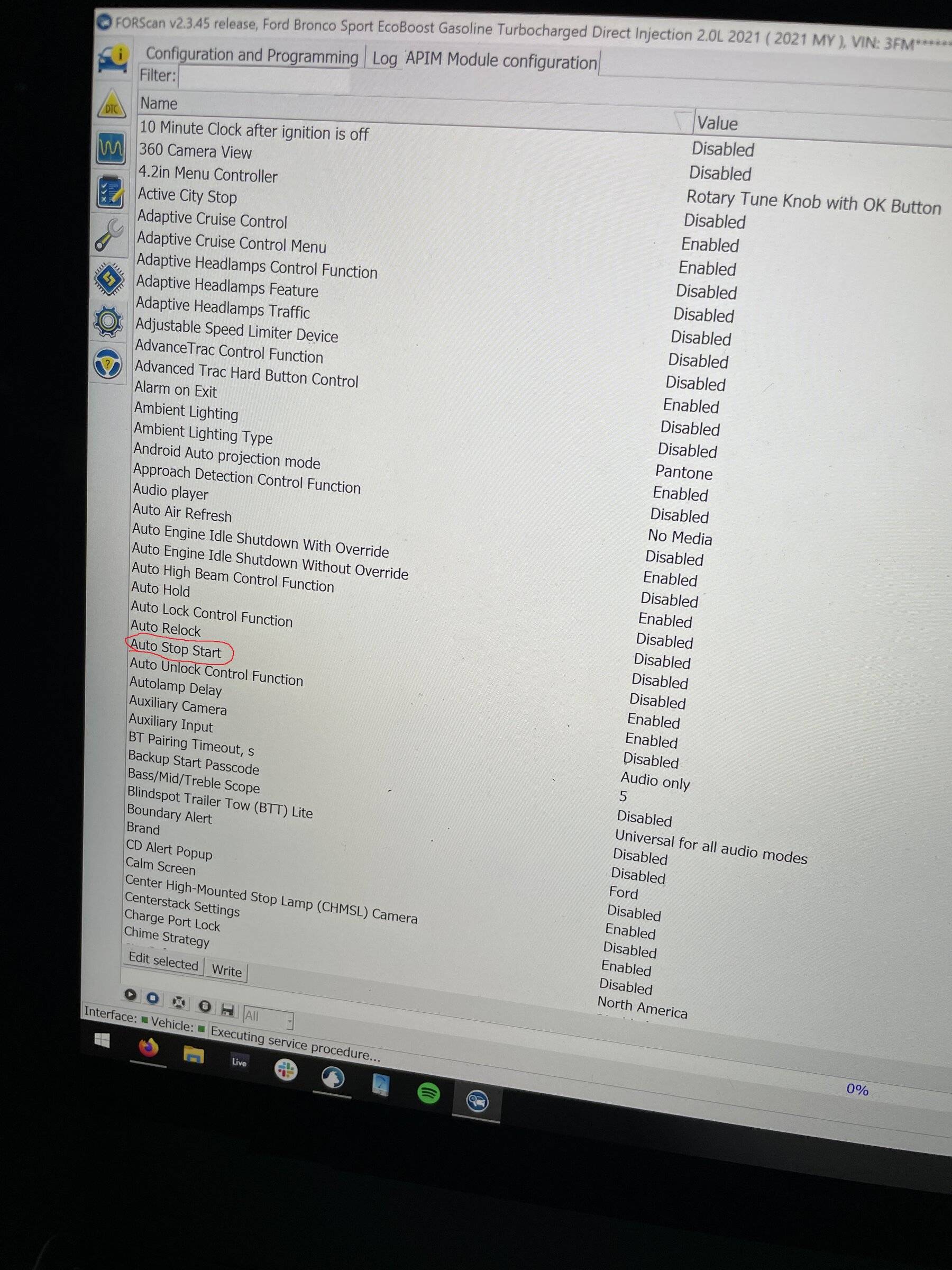

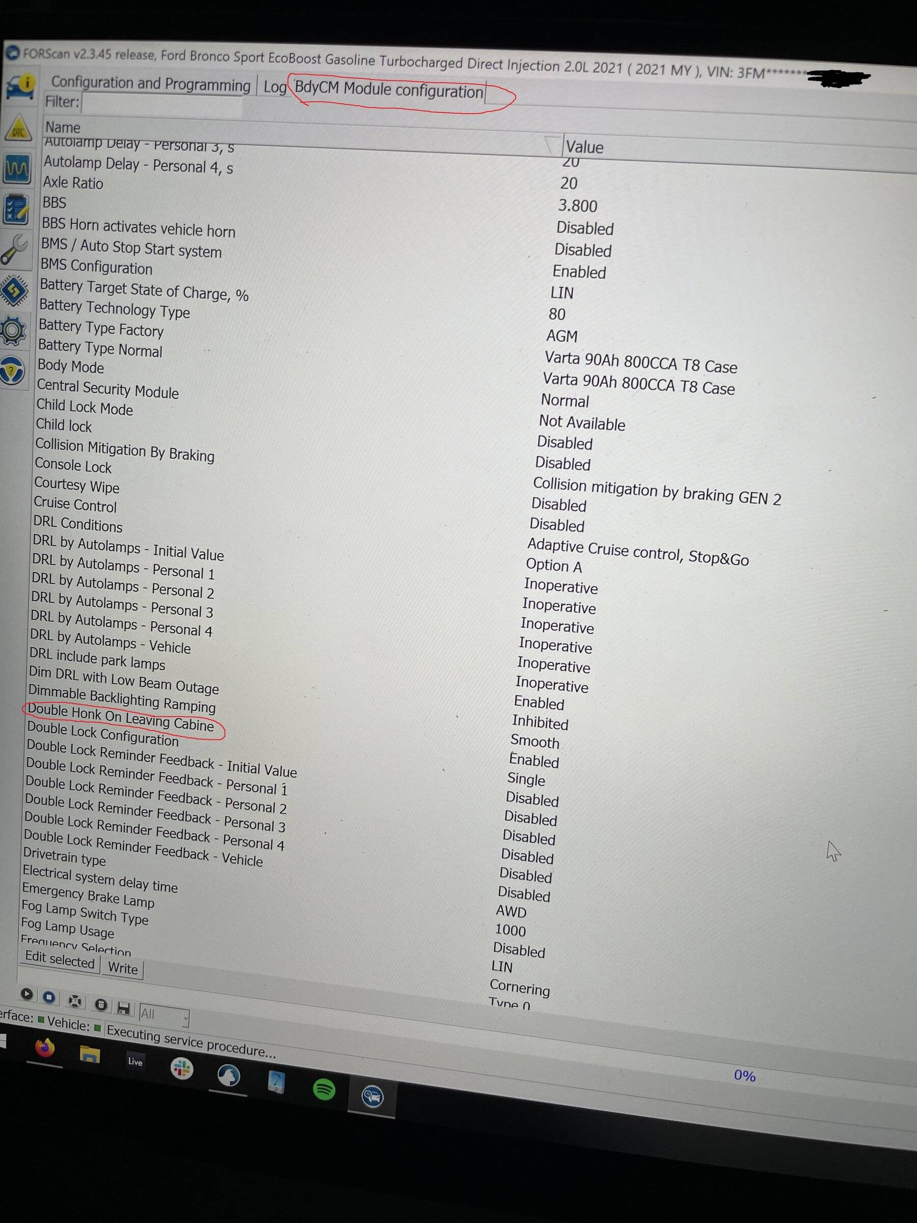

I just received a Vgate vLinker FS ELM327 from Aliexpress about a week after ordering. Disabling double horn honk was really easy following the FORScan Tutorial Document. Looks like Auto Start Stop is there as well but I did not touch that.
$50 to remove the double honk... money well spent :cool:
