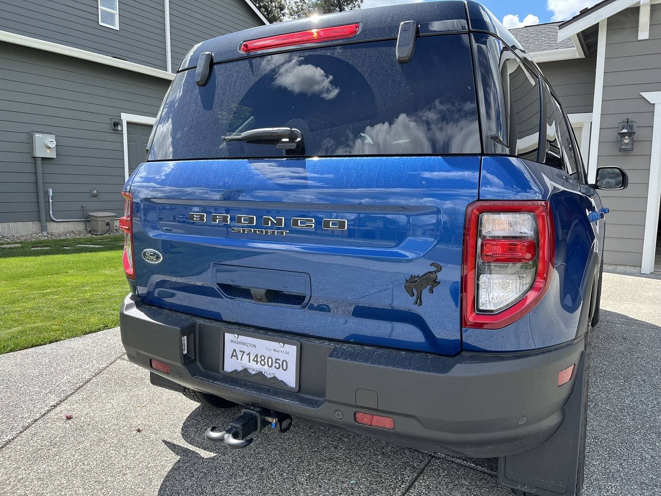

Took delivery a month ago - the hitch came right in but not the wiring - still waiting on the parts. Last I heard they said June. Can't even use it for the plug-in multi-light gizmo I bought for it yet.
Put it on the Subaru Outback which we were able to get hitch and wiring at once. The light does work good - running light - brake light - and flashes with each turn signal - and works with 4 way flashers. Some do not do all that. Bought a 2nd light unit for when the BS finally gets wired.
2" Trailer Tow Hitch Cover Light Stop Tail Light Brake Light 15 Led Light 4 Way | eBay
Ford Bronco Sport ughh...it is almost as if Ford doesn't want you towing anything with this Bronco IMG_1021.JPG
