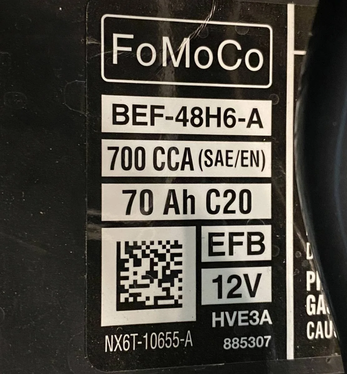

So for "fun" I decided to buy a battery tester so I could keep an eye on my EFB. The results were... interesting.
8 month old EFB as delivered by Ford in a new BS. Driven 36 miles on Saturday primarily highway, 4 miles Monday and Wednesday. No huge draw electronics in the car, FordPass connected features still work, screen isn't shutting down.
Essentially, the battery tester told me that the battery was fine (expected at 8 months), but to charge it (not expected when the car had been driven 3 times in the past five days). It exceeded the CCA rating, which is expected while the battery is young, but was short on the voltage end.
It will get far harsher on the weather front in the Northeast before it gets easier, but I do think this battery is likely to fail within the bumper-to-bumper 3yr/36k if it's already at a point where it's expecting a charge within a day of actual driving and within a week of 40+ miles of driving without frequent stops.

11.9V and 13% SOC is extremely low. Something is not right -- either with the tester, the battery, or the charging system.
Except for the low battery voltage, the chart showing voltage before, during, and after starting looks good. The alternator and regulator appear to be working.
