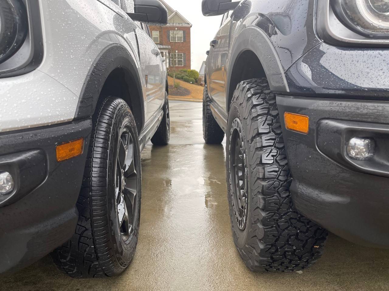

Comparative size of the new tires vs. the Pirelli Scorpions, and the top of the fender flair:

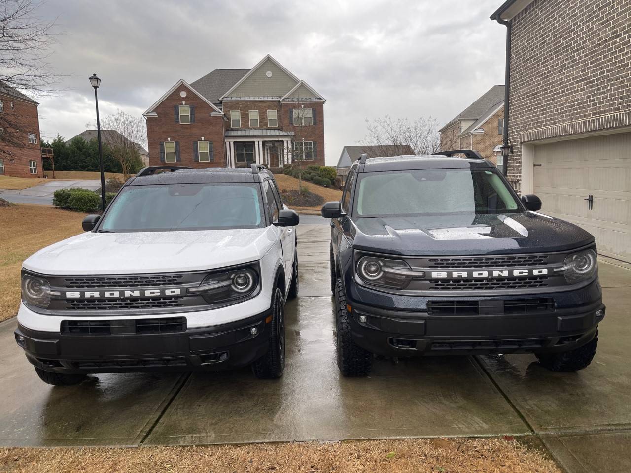

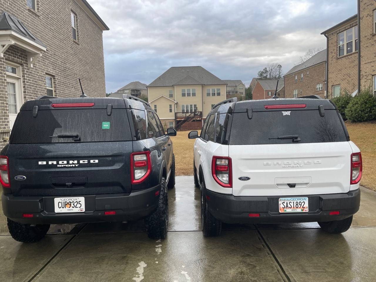

The bumpers, taillights, and roof-line show the clear difference:
Ford Bronco Sport Comparison pics of OEM and Modified Badlands thumbnail_IMG_2557

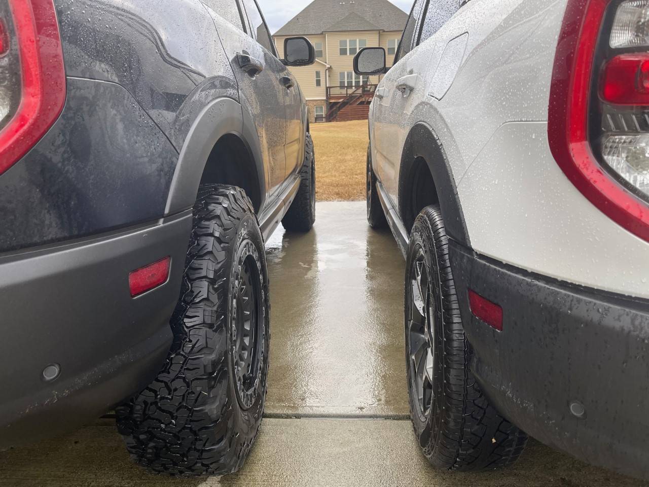

Rear tires:

You say “Comparative size of the new tires vs. the Pirelli Scorpions”
Can you please clarify on the new tires?

They are 255/70/R17

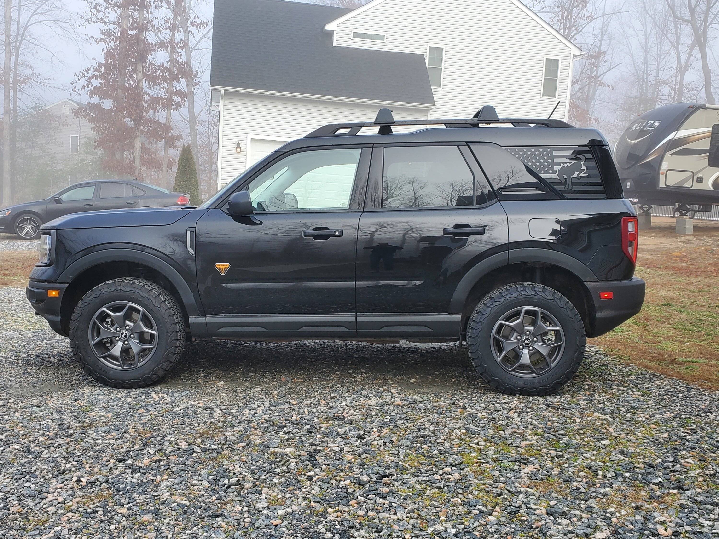

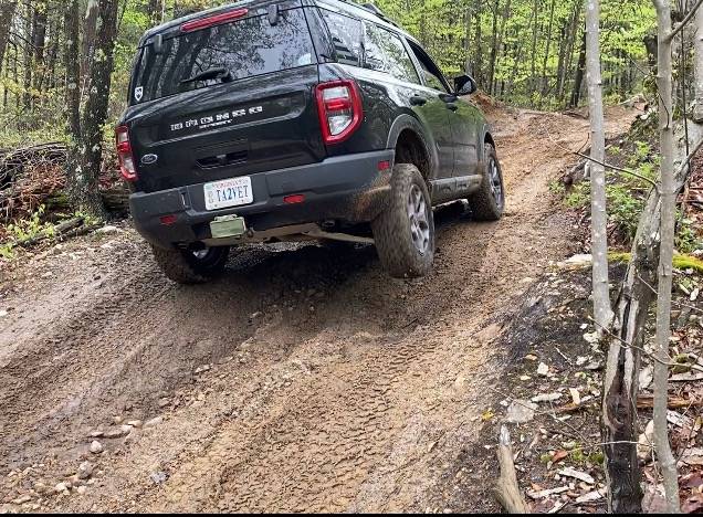

I have a 21 Badlands with the HRG 1.5" lift and was able to put 255/70-17 BFG KO2's on it. No modification and no rubbing.

No trimming of plastic?? Looks great!

None at all. Off-road I've had the wheels articulated into the wheelwell many times. and no rubbing.
Love it. Love seeing somebody else go with those tires. There aren't too many of us crazy enough to go there, apparently, but I think they balance out the overall look of the BS very nicely.

Thanks. I've been very impressed with the BS Badlands capabilities off-road.

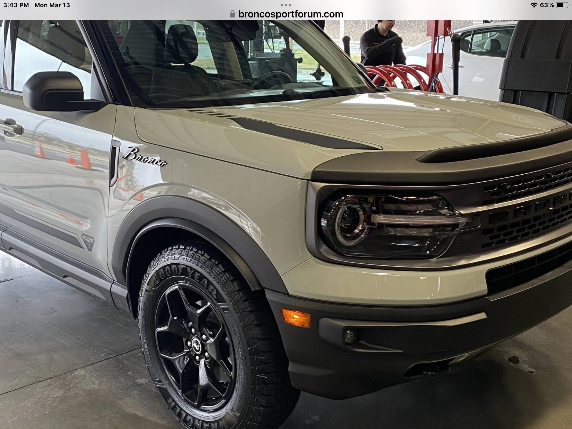

Same here 235/70/17 on stock first edition no lift , no rub , Goodyear wrangler AT sets just right at 77 inches to the crossbar .

Love that First Edition, and those tires look great. Yeah - 235/70 should definitely be Ok with no rub. 255/70 not rubbing AND not needing to trim some plastic is surprising.
