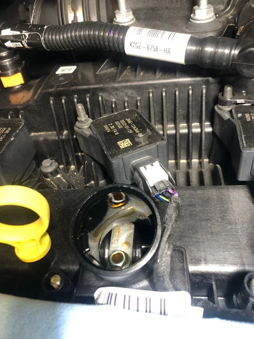

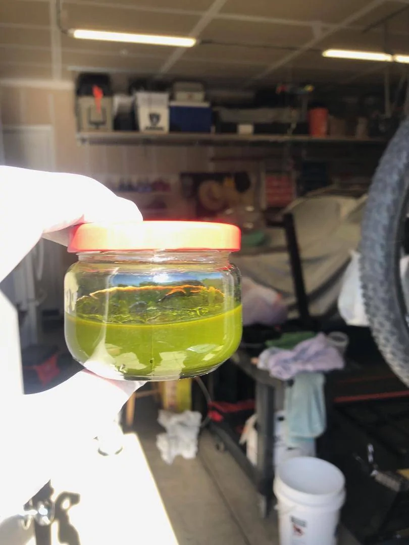

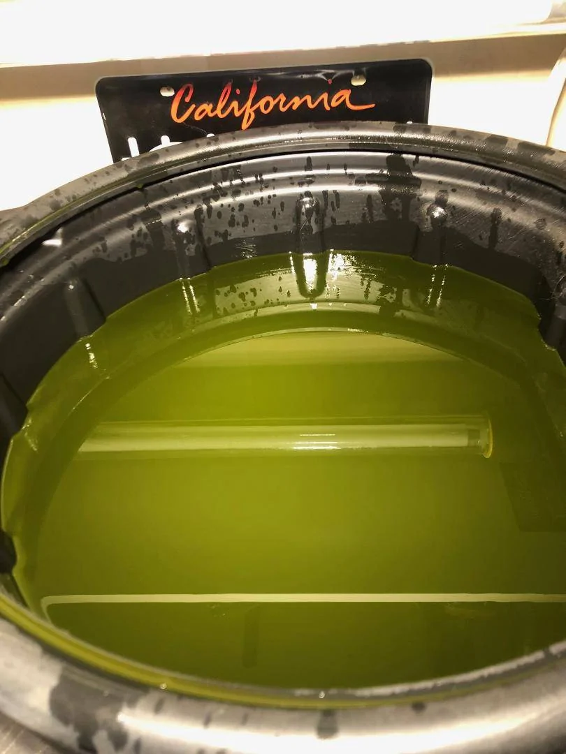

I did my first oil change on our Badlands with the 2.0. Oil was changed at 1596 miles. To my surprise as oil was draining into drain pan, I noticed it had a very noticeable green tint. Has anyone else experienced this? First thing I thought was coolant intrusion, but my coolant level is normal and there is no white smoke from exhaust that I have noticed. See pics and tell me what you think. I've read that ford uses dye sometimes to verify there are no oil leaks on a new motor, I've never heard of this until reading up on it a little bit. Pictures are held up in the sunlight to show green hue, it's not as noticeable in the shade.

I did mine at 2K on my 2.0. Mine was not green at all. That looks more like coolant than oil.

I'm not low on coolant at all and there's no smoke coming from tailpipe. I don't know what to think other than its dye for leak detection. It does look like coolant but not so much in the shade or out of direct light.

I was actually thinking about sending a sample to Blackstone Labs for my protection. Drain quantity was correct @ 5 quarts. It does smell and feel like oil.

Pretty sure it is a dye. I ran some oil in my VW from Liqui-Moly that came out of the bottle really green and it does help to find leaks. I can’t remember if it was a black light thing to point out the leak but I don’t think you have anything to worry about. If coolant was in the oil it wouldn’t be green, the whole thing would look foamy and light brown (maybe with a tinge of green in this case).
Is Ford still using the standard green coolant? Sorry, I have had Euro cars since the late 90’s.
