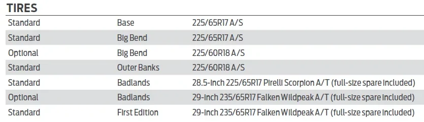

Wonder if the BL "steelie" wheel can fit 245/65/17 on it (without any mods)...
Also: according to that screenshot, Full size spare tire is standard on BL then? Where did I read that it was only included with the two package?
The factory spec sheet does not list the Bronco Sport wheel width, so using the tire size wheel range will give you an idea:. The Badlands optional tire size is 235/65R17, but you said you want to use a 245/65R17, most likely they will both fit the stock wheel as the ranges overlap. So as long as the factory wheel is 7" you are good. However, since the tire diameter is larger you will have to check for rub and speedometer calibration.
Optional Badlands Off-Road Tire
235/65R17
Diameter : 29.0"
Width : 9.3"
Wheel : 17" x 6.5-8.5"
https://tiresize.com/tiresizes/235-65R17.htm
@Washburn alternate size
245/65R17
Diameter : 29.5"
Width : 9.6"
Wheel : 17" x 7-8.5"
https://tiresize.com/tiresizes/245-65R17.htm

Thanks guys - 245/65/17 would look really nice on the B/Sport.
+0.5" would hopefully not rub with stock suspension.....
