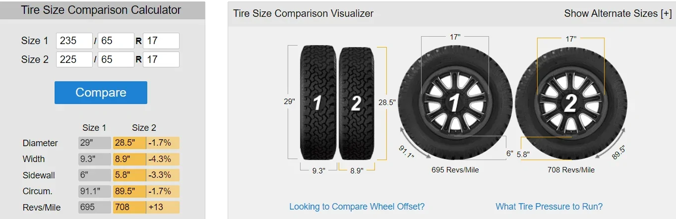

Ford Bronco Sport What tires should I get for my soon to be delivered badlands? What are you getting? 1608819963179
I am guessing the spare tire compartment can't handle the additional 1/2" height and/or the 0.4" width.
