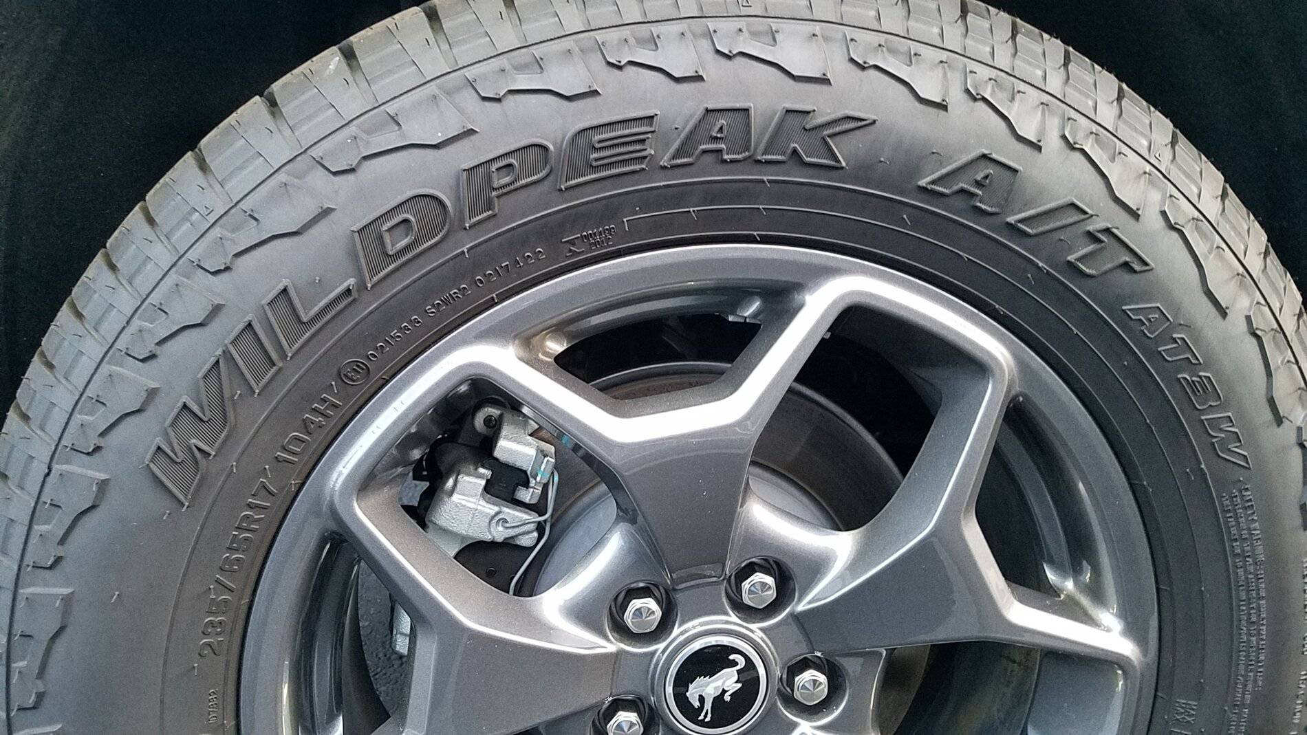

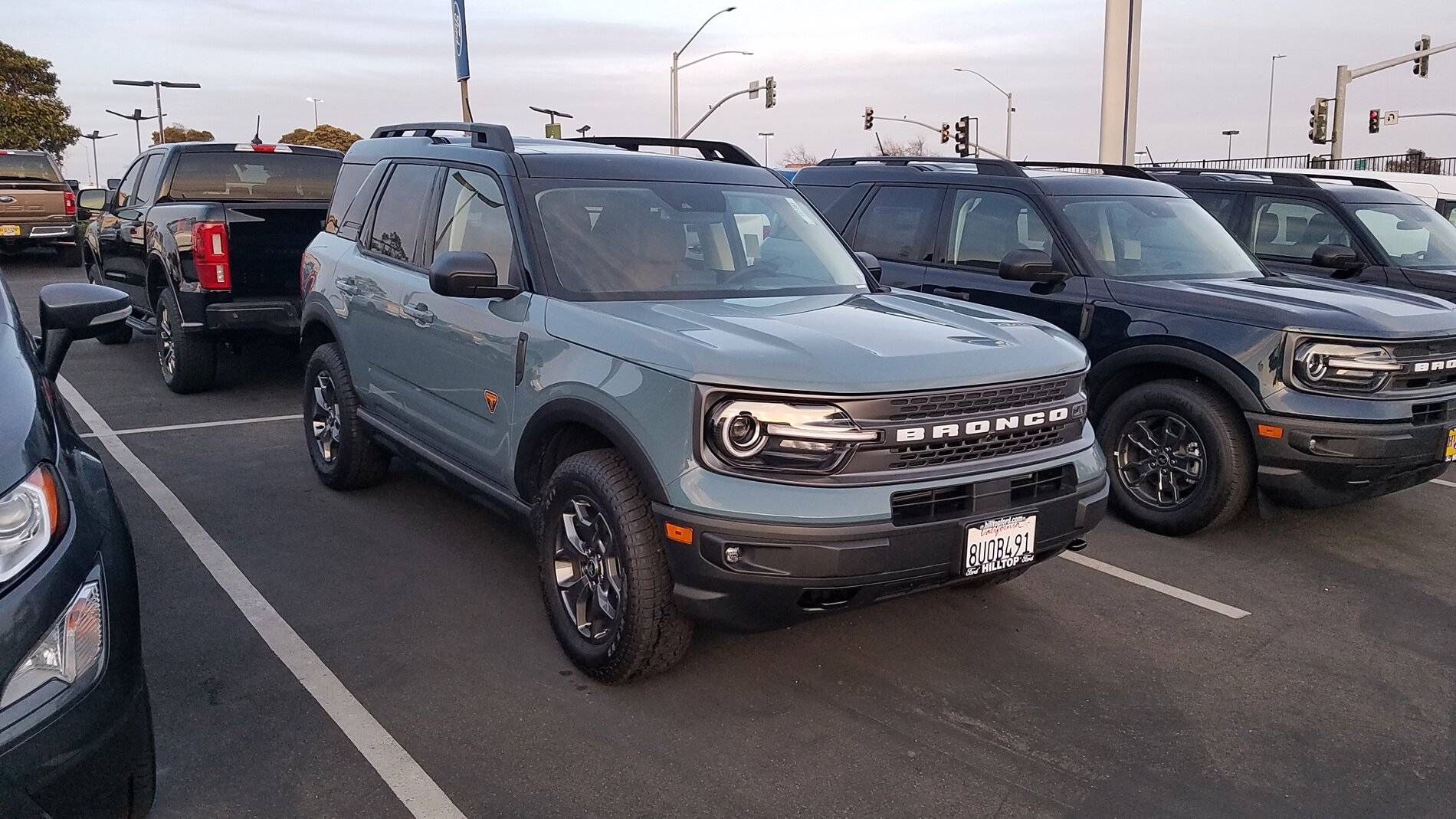

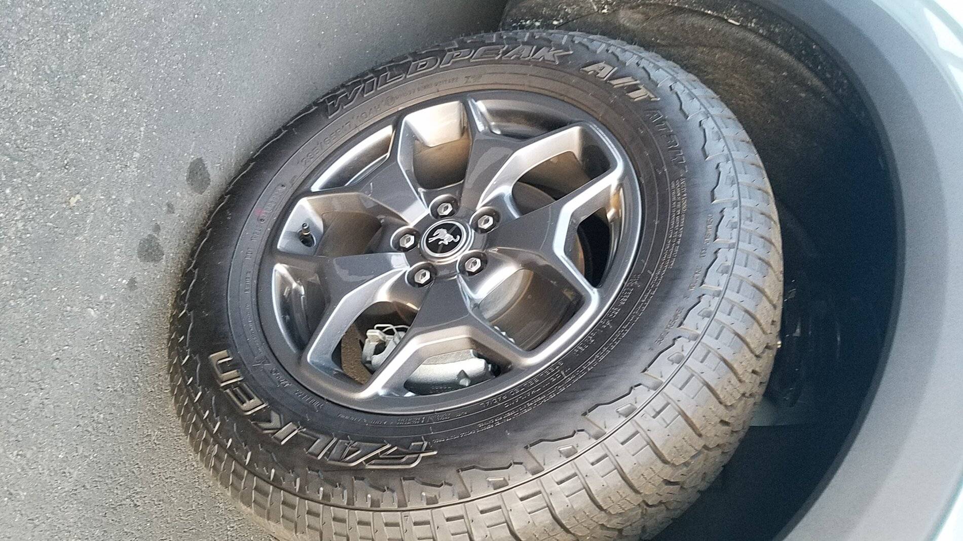

try looking on TireRack.com for the Falken Wildpeak AT3Ws in 235/65R17... they should have them. I have actually seen the Falken WIldpeak AT3W 235s on a Badland (See attached pictures).
Ford Bronco Sport What tires should I get for my soon to be delivered badlands? What are you getting? 20210324_192000
Ford Bronco Sport What tires should I get for my soon to be delivered badlands? What are you getting? 20210324_191605
Ford Bronco Sport What tires should I get for my soon to be delivered badlands? What are you getting? 20210324_191546

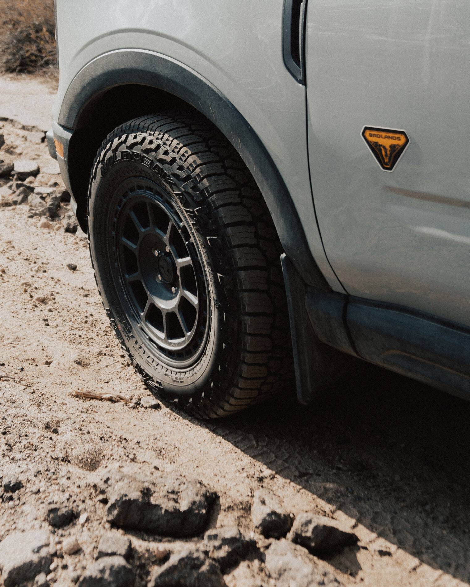

i ended up with 245/65/17 wildpeaks
Ford Bronco Sport What tires should I get for my soon to be delivered badlands? What are you getting? B0477BA8-6D15-41B4-8F33-3B2A15CC0824
Looks good! But do the 245s rub the wheel weld when you crank the wheel all the way to the left or right? or going over big bumps?
Elboy
Elden
Oct 26, 2020
247
589
Redlands CA
Subaru Forester
no issues with rubbing and i go off-road pretty often. my take is that they do rub slightly while articulated / at full lock but it’s a non issue. the carpet liner is very flexible with nothing behind it so it’s fine.
