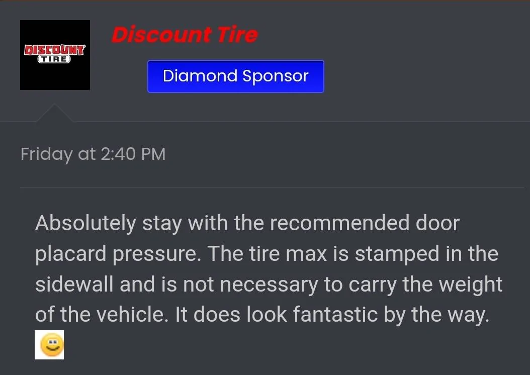

This is what they told me since I forgot to ask the shop while I was in. Mine are currently at 40 PSI but probably going to air down.
Ford Bronco Sport What PSI are you running your KO2s at ?? Screenshot_20230618_121631_Chrom
