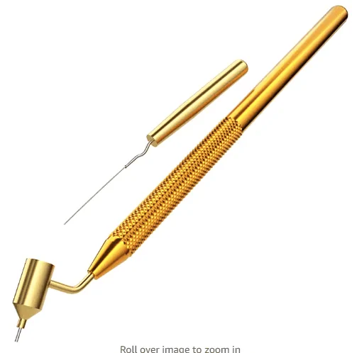

Yea, I been researching the paint code on the BS and what is available... Then use one of these..not the so call pen...
Ford Bronco Sport What is Ford Using for Brake Pads???? OMG the Dust!! 1657558909936
These are great as you just dab in and have more control of the flow and not make a mess. Also if you can hold it, a needle will work..Let it dry and dab with clear coat..sand with 1,000 and 2000 grit and then buff and polish and you will never see it..

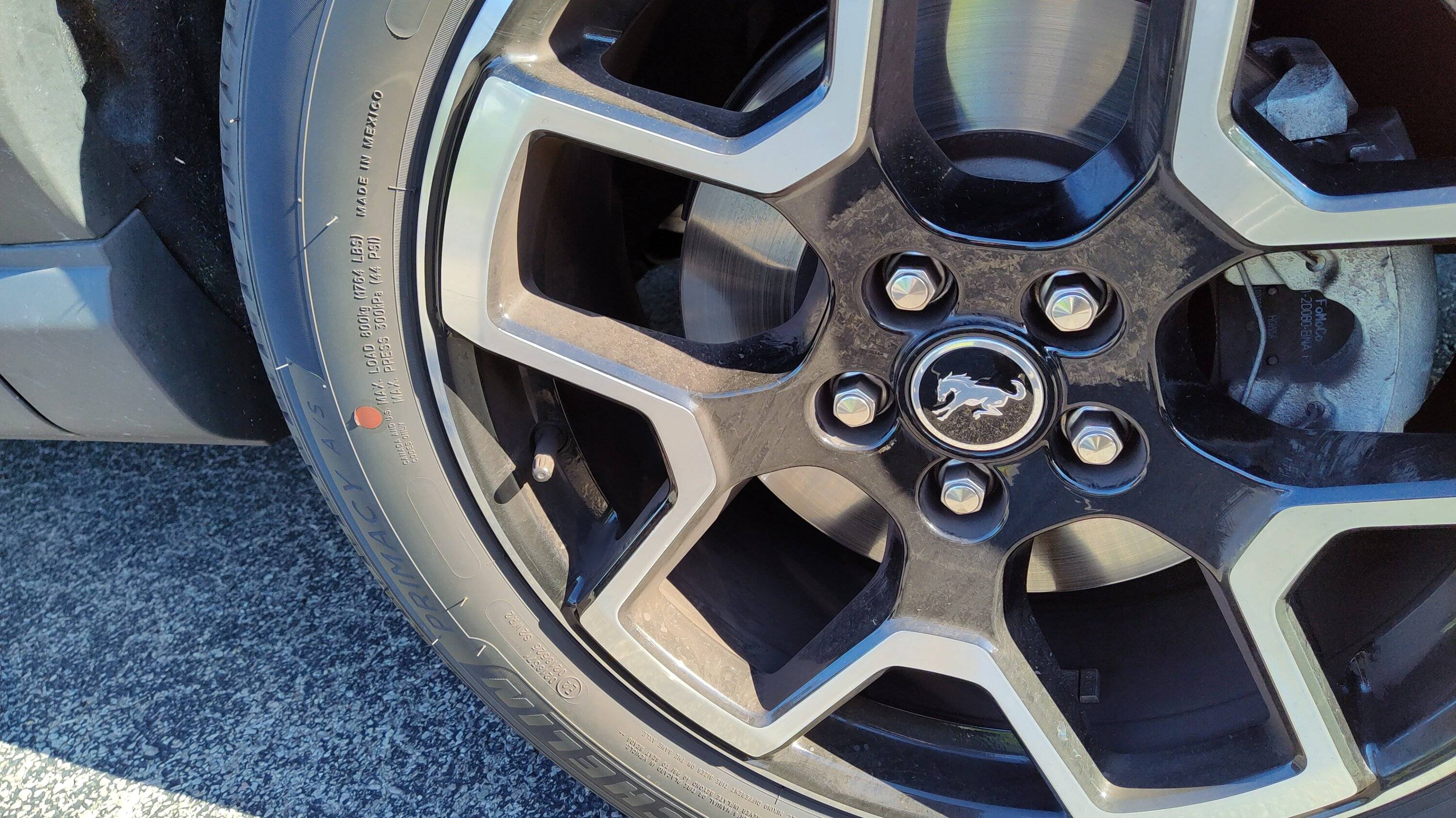

What is Ford using for their pads?? Holy F!! I never had a car/suv that produced so much dust! It is so bad it is destroying my rims...This is what they look like after 4k miles on my 2022... I have the 18" Upgraded Rims...
Ford Bronco Sport What is Ford Using for Brake Pads???? OMG the Dust!! Rim Scratch
The other pic here is what they look like after a week washing them spotless!!
Ford Bronco Sport What is Ford Using for Brake Pads???? OMG the Dust!! Rim Dirty
After noticing the brake dust creating scratching, I am now force to take the tires off, compound out the scratches and Ceramic or Graphene coat them! Anyone who is on here and is waiting to get a new Sport or on Order...Do your self a favor, Pad Swap your brakes as soon as possible! My Escape never had this issue with MotorCraft Parts and even later on when I installed some Powerstops. Go with some Carbon Fiber Powerstops or a brand you like or Akebono or EBC Pads if they have them for the Sport yet..
Anyone else seeing this on their rims and scratching them up when the dust slings???
It's not so bad on the back, but that is because the rear brakes aren't used as much as the front ones..

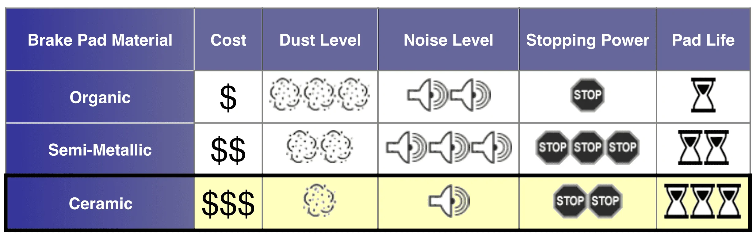

I don't think you can say definitively "cheap pads." The recall last year on the brakes was about the failure of certain Bronco Sports to meet NHTSA-mandated stopping distance in the event of a brake booster failure. The fix was to use higher-friction brake pads on the front axle. Most OEMs use organic brake pads because they typically produce the least noise and dust. They also happen to be the cheapest.
My guess is Ford switched from organic to semi-metallic pads to meet NHTSA braking standards. These would almost certainly be more expensive than the original organic pads, but they'll provide better stopping power, and they'll likely last longer. The downside is they also produce more brake dust.

I don’t think you have all that stopping power vs. dust vs. noise arguments right. Here is a chart from RockAuto:
