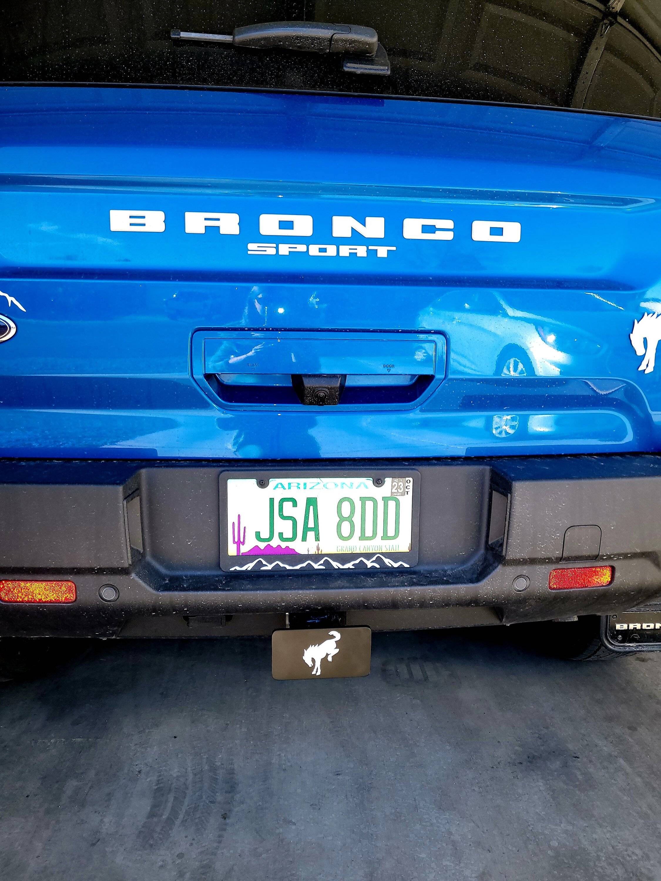

I know functionally it does nothing, but I bought this locking cover for the hitch.

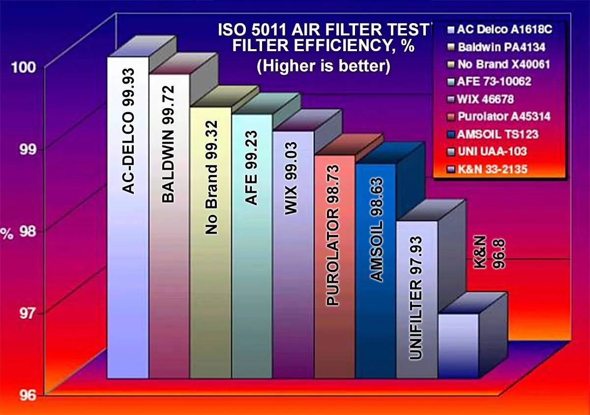

I've looked through K&N's website pretty carefully, and I can't find anything in its description of test procedures regarding the presence or absence of vibration or flow pulsation, or that either is a necessary component of K&N's filter efficiency.
Personally, I think the reason the K&N filter performed so poorly on the efficiency test conducted by Project Farm is due to the material used by the presenter to simulate "dust." How does flour compare to actual atmospheric dust—the material the filter is designed to capture? We don't know.
This test, conducted by an outfit calling itself Project 200, seems to be a lot more "scientific" than the one conducted by Project Farm. It used a test "dust" material used by ISO, which I believe provides more meaningful results in comparison testing.
You can look through the results and draw your own conclusions, but it's pretty obvious to me from this graph alone that the K&N does not filter as efficiently as the other filters it was compared to.
Ford Bronco Sport What did you do TO your Bronco Sport today? ISO5011-efficiency
Whether the difference between 99.93% and 96.8% matters is up to you.

I've never seen anything from K&N that explains the role of vibration in their filter's performance either, Mark. Did you watch the video that Meanderthal posted from Goodson, contradicting Project Farm's test? It is a fascinating video.
Goodson explains his history with K&N going back to the 1970s, when he met the CEO at a SEMA convention. He explains how paper filters either supported air flow OR they filtered, but not both. K&N comes along with a filter that did both exceptionally well. In the video, he then goes on to explain the problem with Project Farm's testing, along with most filter testing, and how K&N cannot be tested with standard filter tests because it is what he calls an "active filter" whereas everything else is a passive filter.
Goodson goes on to explain that he discovered that the K&N filters function much like human lungs in that it is the material with hair-like fibers that collect the dust particles, while the filter continues to support maximum airflow. Goodson goes on to explain how those fibers work off of the engine's vibration, and that this is really the "secret sauce" that so many people fail to understand.

Yes, I watched it, which is why I went to K&N's website for information about how they conduct efficiency tests. It said nothing about vibration or flow pulsation. From what I could see it uses the same ISO testing procedure as other manufacturers, which appears to be a steady-state flow test, and that's the testing on which K&N's claims regarding efficiency are based.
I'm not by any means an expert in fluid dynamics, but I can't for the life of me see how moving the fibers around increases their chances of capturing particles. Common sense tells me the only way to increase air flow is to reduce filtration efficiency, which is what I see from the testing at the link I provided.
Again, I acknowledge there isn't much difference between 99.9% and 96.8%. But the extra power claimed by K&N isn't enough in my mind to justify ANY reduction in filter efficiency. Even if K&N's claims about power gains are accurate, I don't really feel like I need another 5-10 HP.

I hear you.
I gained about 25 horses when I put the same thing on my Aston Martin DB9 and it went from a very fun car to drive to a very fun rocket to drive. :) Definitely wasn't looking for mimicking that with a Bronco Sport, but I also didn't want to feel like I lost HP with my heavier tires.
