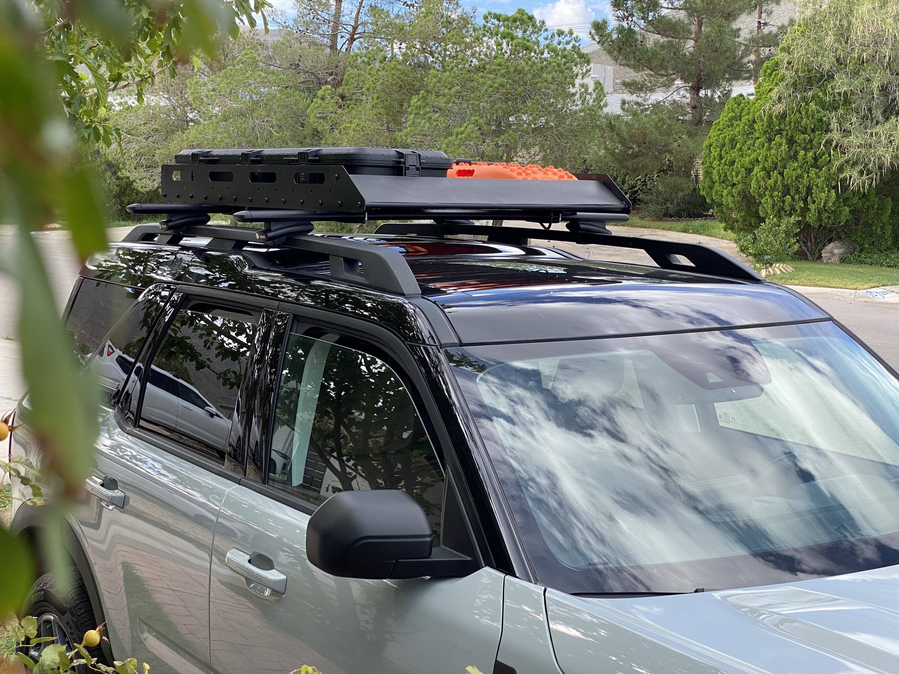

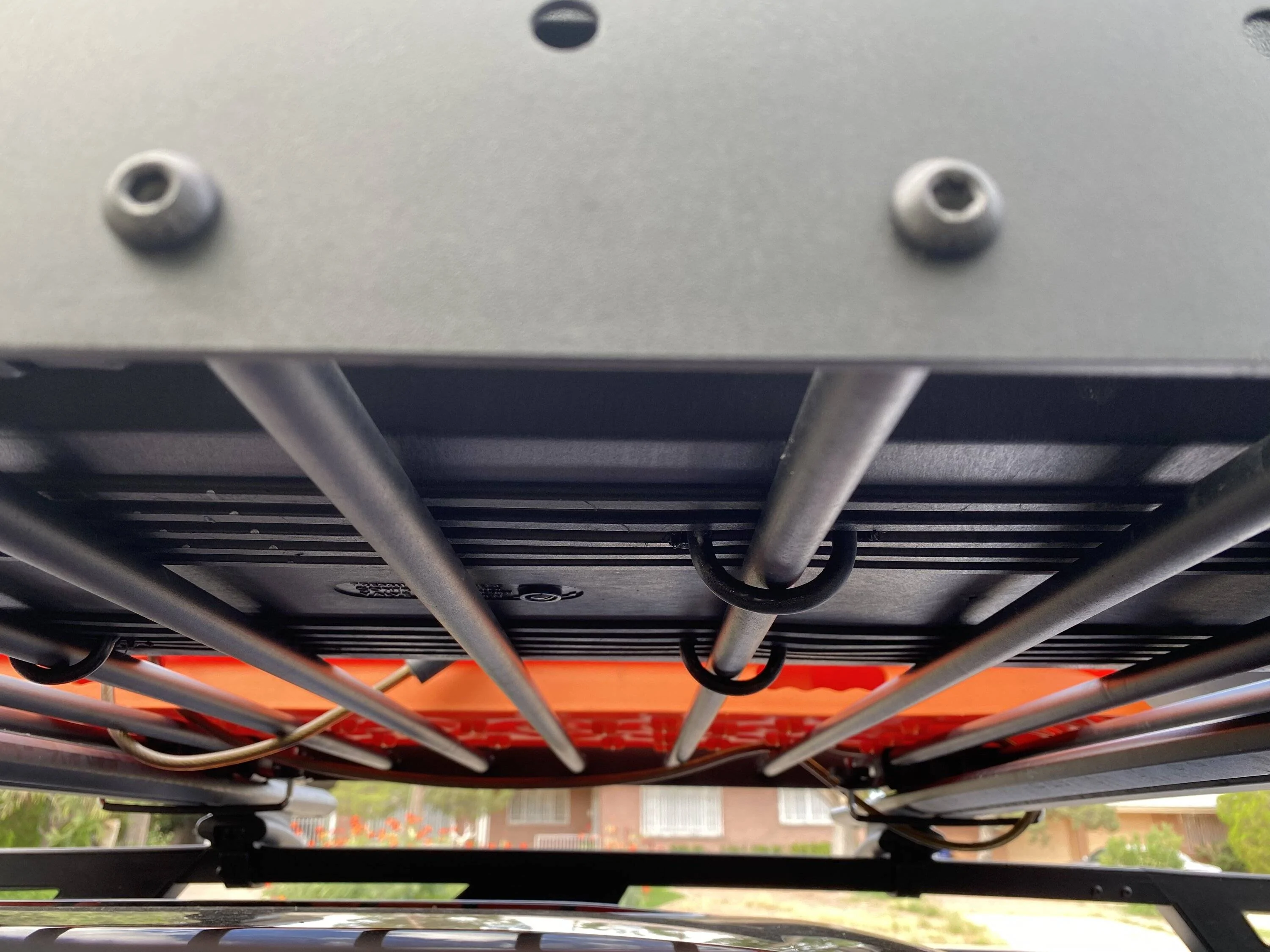

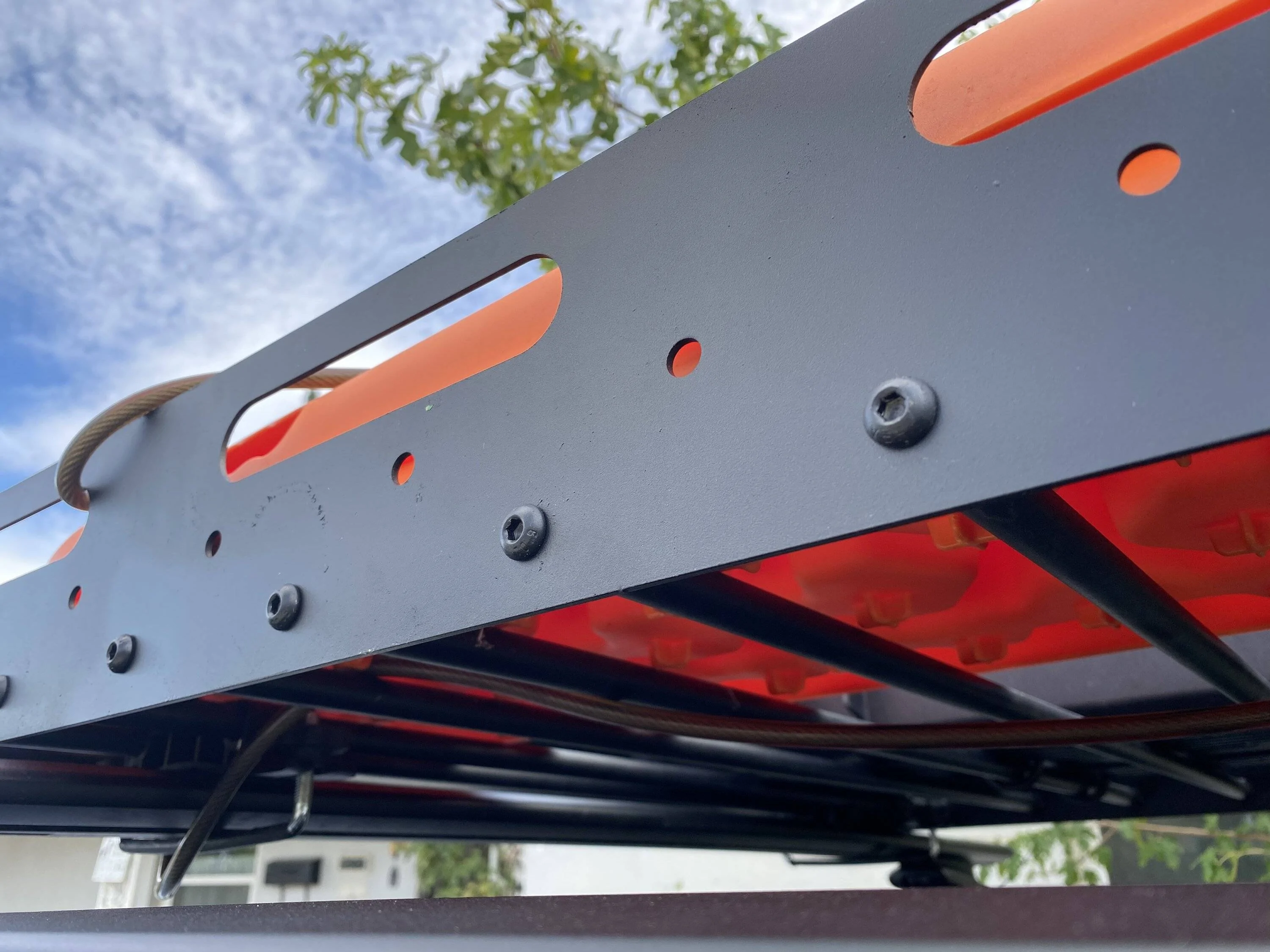

what case is that up top, and is it weatherproof?
It’s an old Plano all weather case for a rifle… not as robust as say a Pelican or those ROAM cases… but also not costing hundreds more either !
This case cost about $100 and does have a gasket around the lid … you could also check out harbor freight and their Apache cases. Similarly priced .
mines being used to hold parts for an awning and other recovery items I don’t want inside my vehicle

What roof rack is this? I like the way it looks. Wonder if it could be mounted a little closer to the stock side rails though.

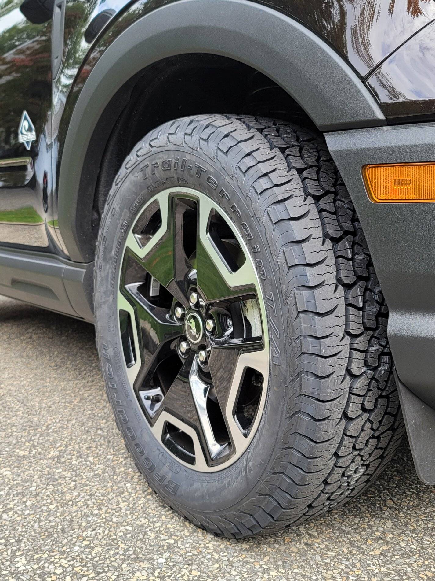

Looks nice! I can't tell...what size are they?

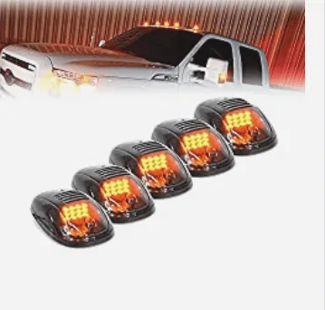

thanks
always appreciate the input
takes the apprehension level down to acceptable
map light/ eyeglass holder trim removal experience
if so
easy?
prepping for cab clearance lighting

This is one from the depths of Amazon... listed as the MPH cargo box... comes in 2 lengths but the width is fixed. I suppose you could McGuyver it, but might be too much hassle.
Can't beat the price for sure... $155/$209 dependent on size you go with. I purchased the larger one but felt it looked too bulky so just took the extension off... and left rear open to longer items.
Its well made. but issues with pre-mature oxidation have been observed so I simply sprayed the whole assembled rack with some plastic dip in my case. Also where the integrated faring meet the front its tack welded and prone to rattling at freeway speeds. The fix is to run aline of caulking to seal the edges and prevent the noises.
