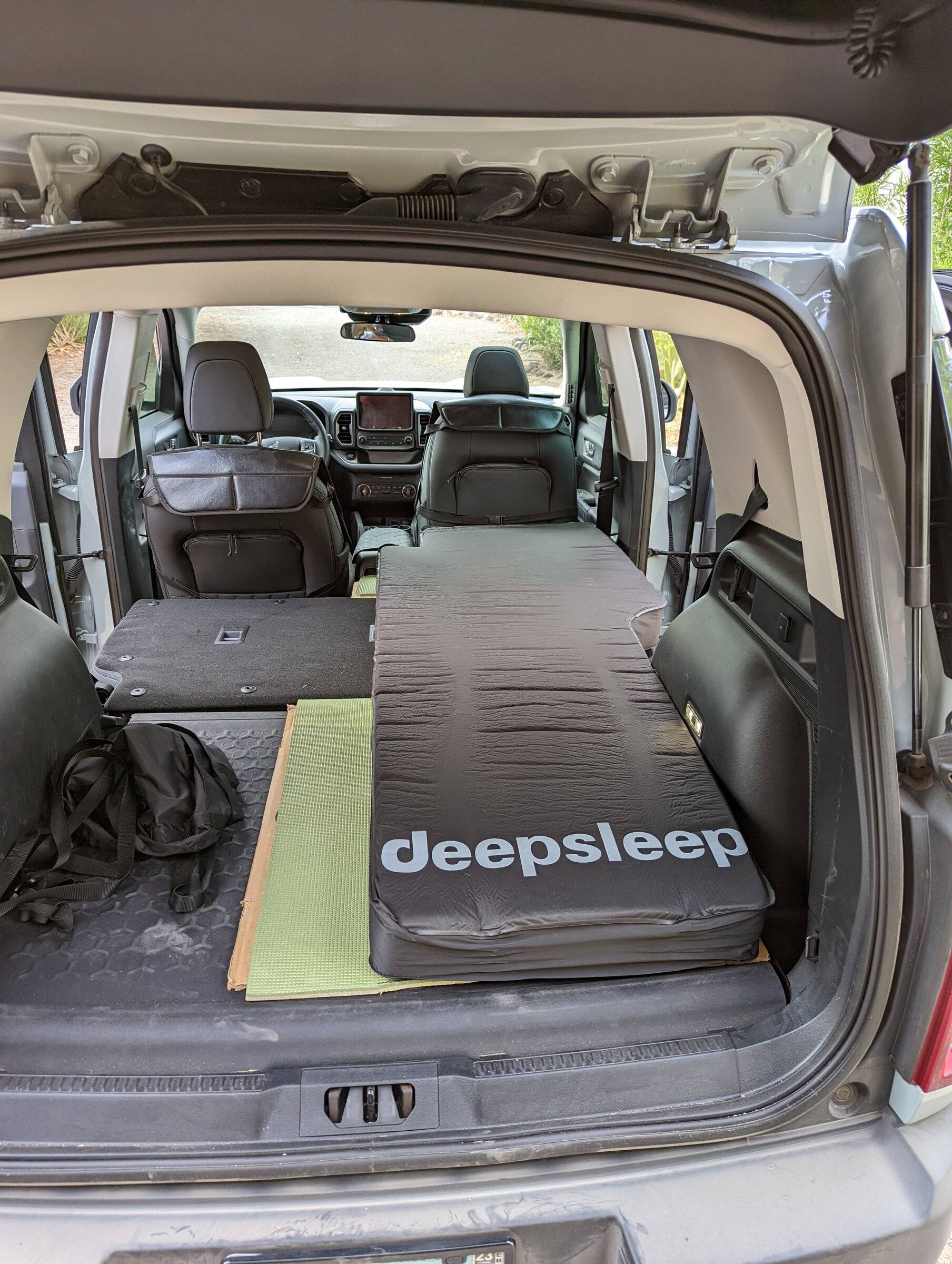

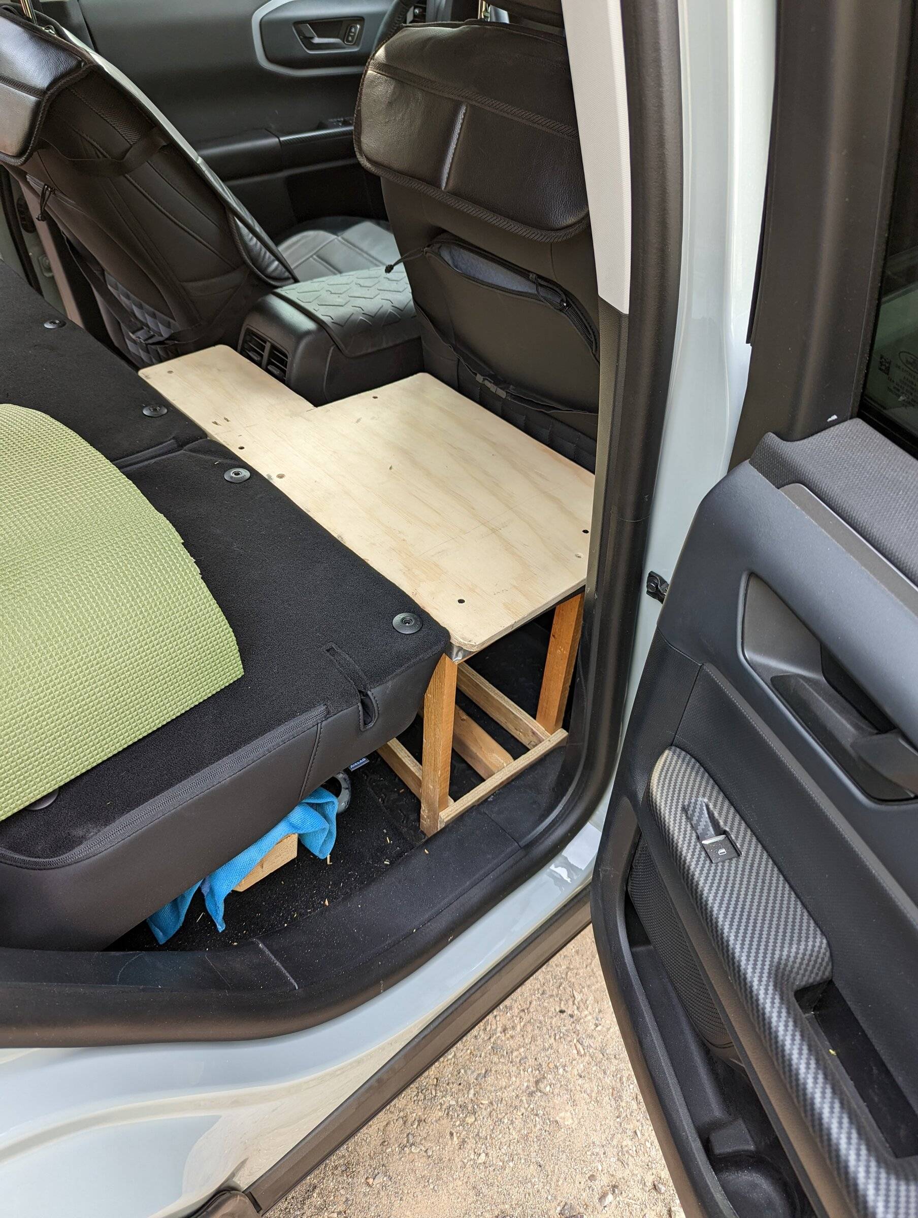

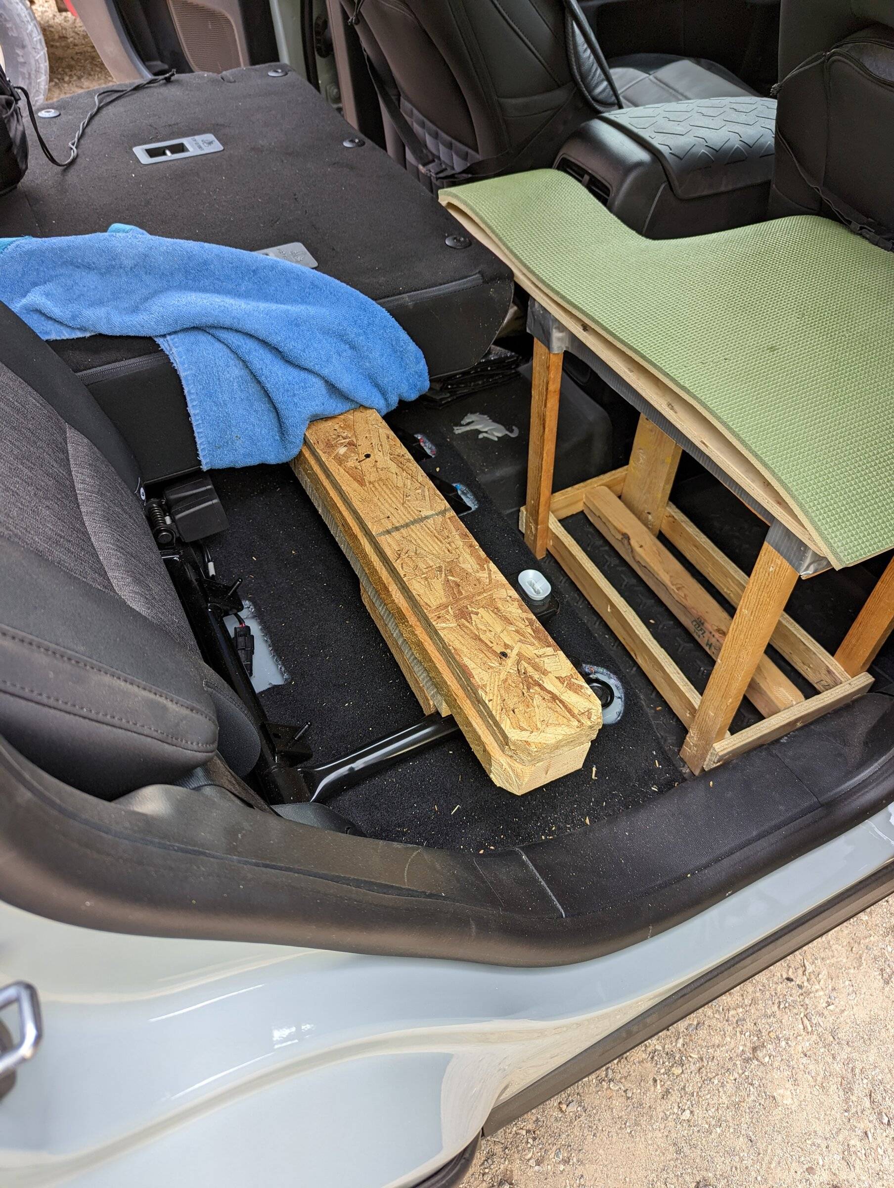

Getting ready for it's first overnighter. Put together a brace to support the rear seats folded down with the bottom seat removed. Then built a table that's fits behind the pass seat and fills that large void to be able to use it for sleeping. Test the new mattress. At 6'1" I can fully stretch out laying down.

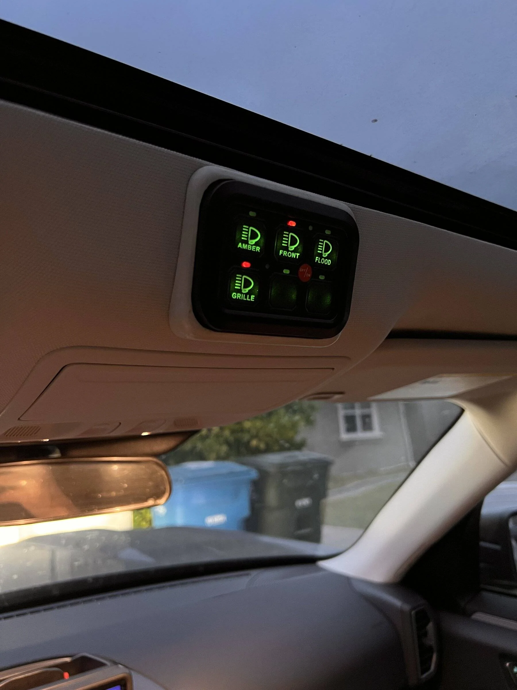

Finally mastered my 3d Printer enough so I could make a custom fit bezel framing mount for my AUX light switch.
3D printers are pretty slick for this kind of mod's, what printer are you using if you don't mind sharing that info...... :thumbsup:
Im cheap… got the Ender 3 3d Pro and some free CAD apps. After about 20 test models, I finally got all the measurements and contours right.
That's the key!
Start out learning these things then you can upgrade when the time is right.
Good looking job with the switches........ :like:

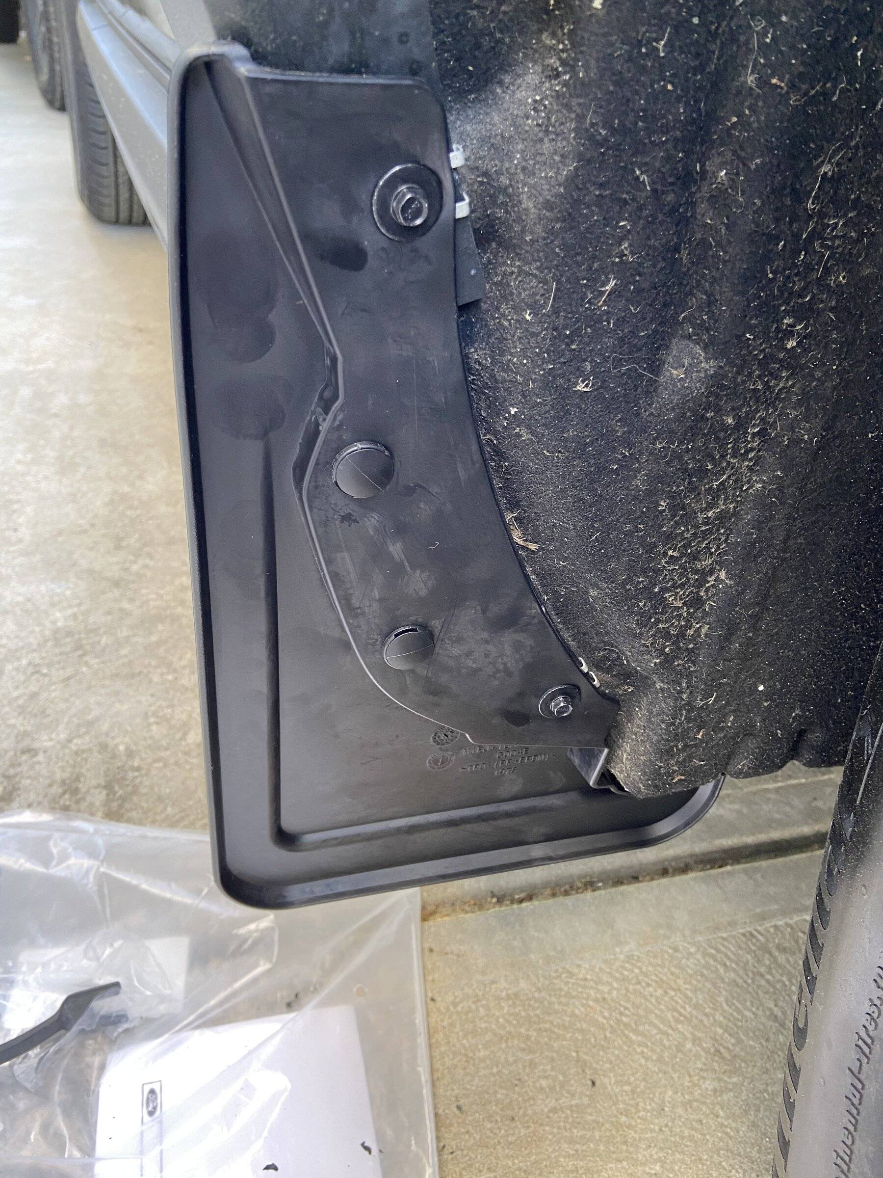

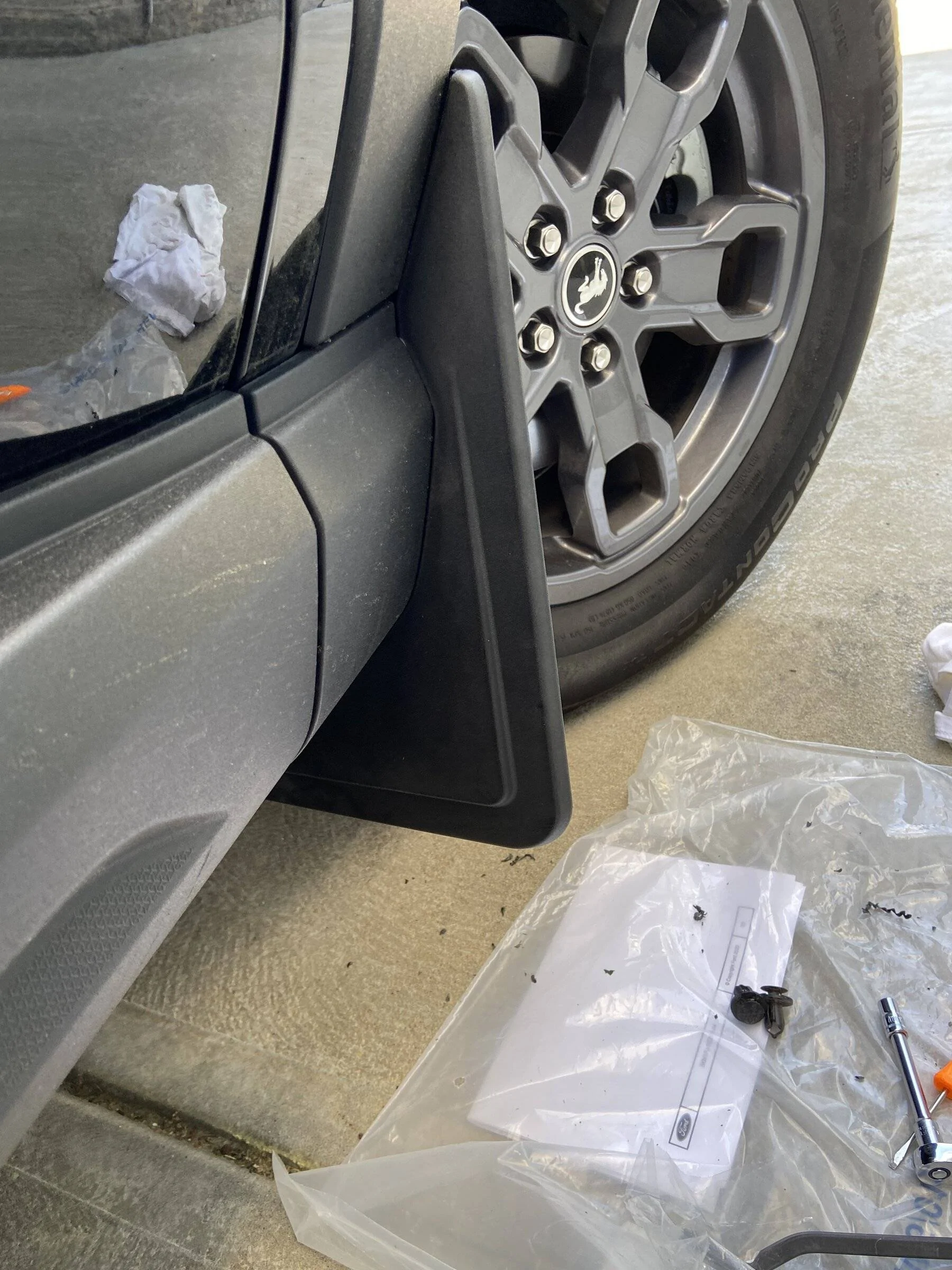

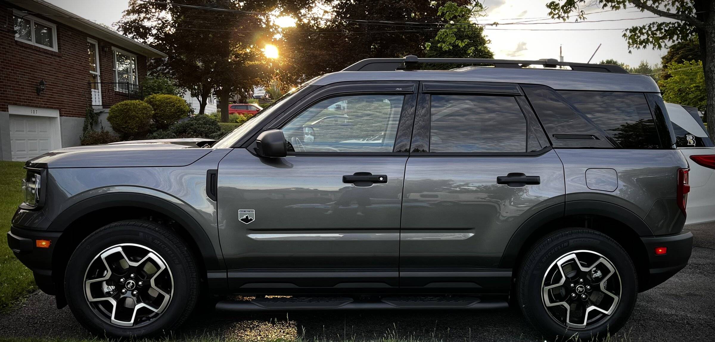

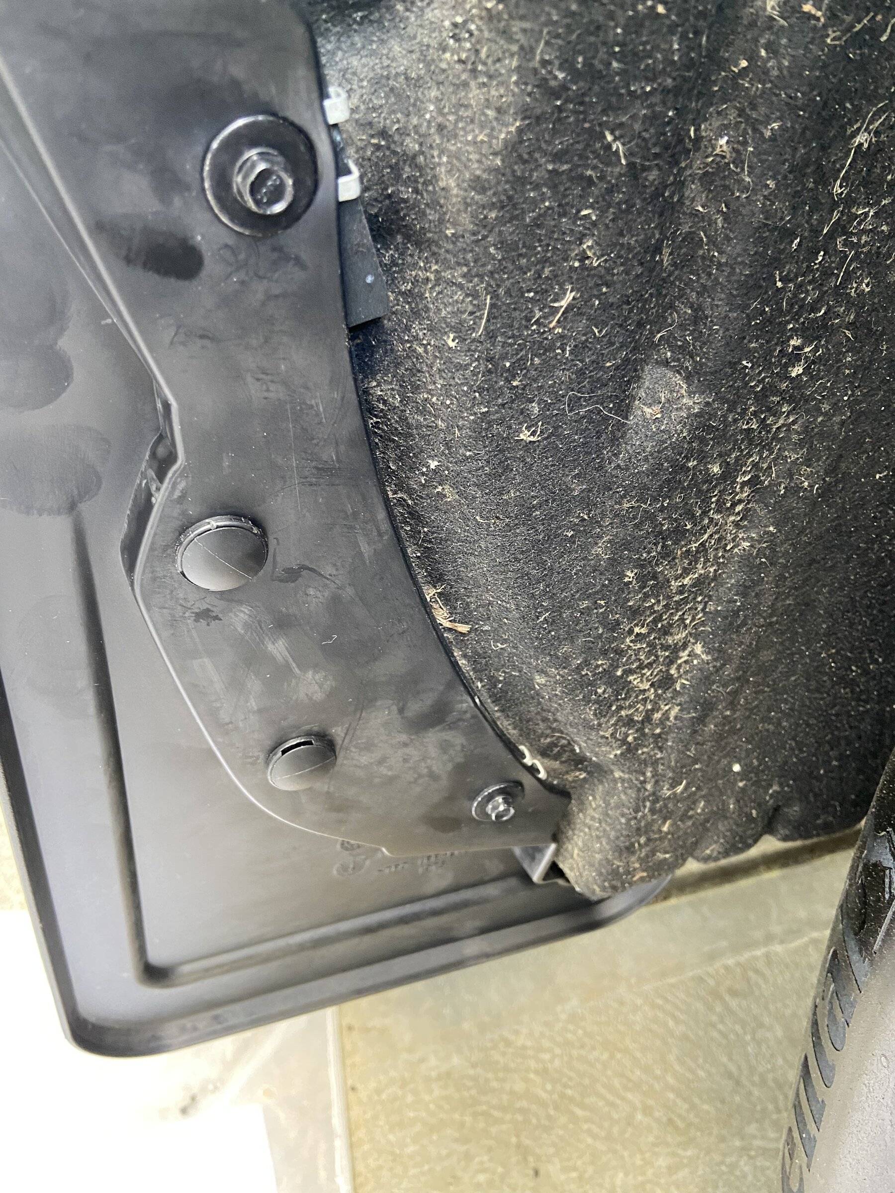

I finally installed the front mud flaps. The bottom hole is already there held in place by a push pin, just remove that pin an install the hardware that came with the Kit. Then drill 3 holes with the mud flap installed by the bottom screw as your guide holes and presto it’s done.
p.s. you don’t have to remove the front wheel you just have to turn the steering wheel all the way to the left or right depends which side you start with.

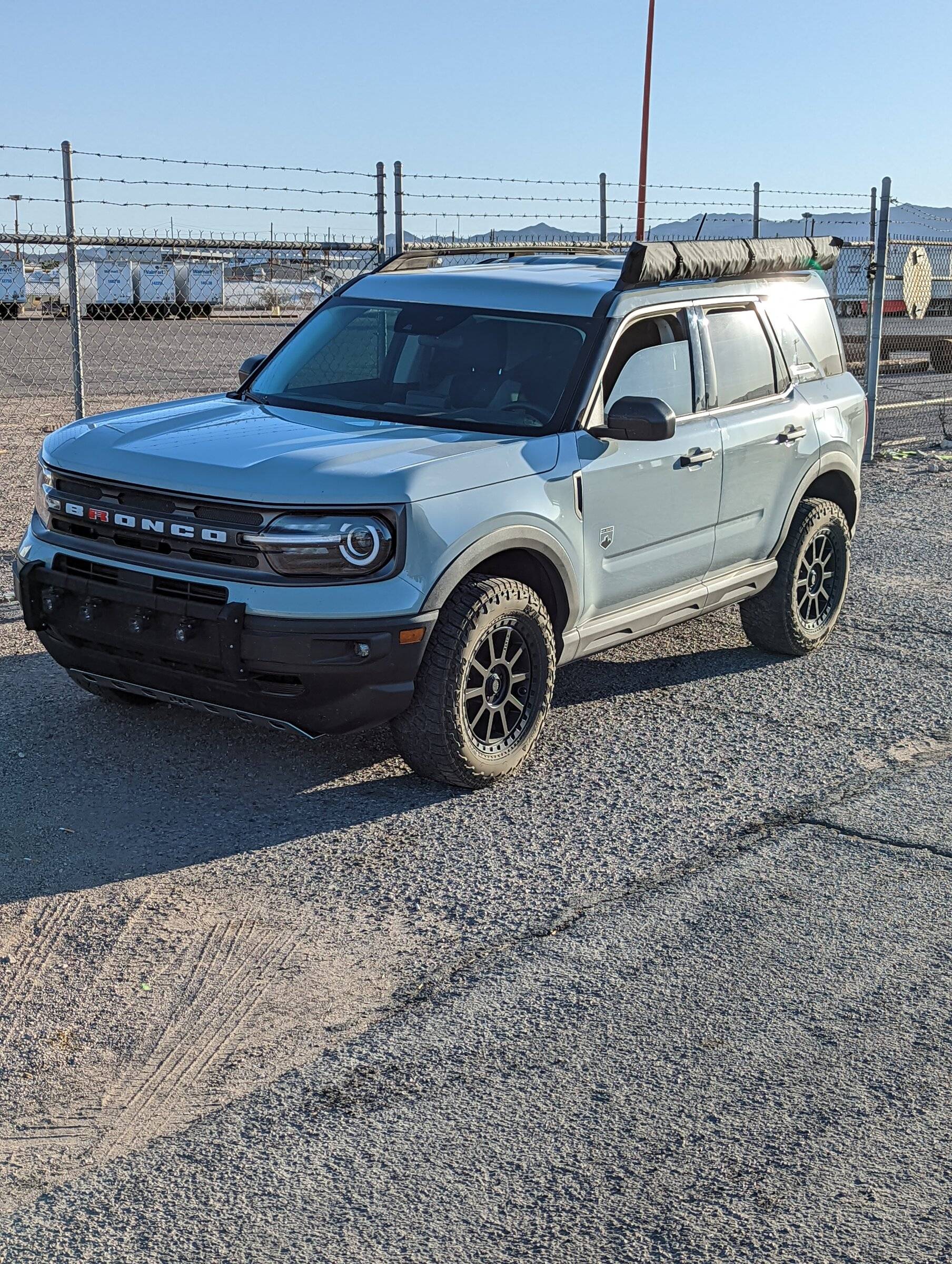

I installed my new awning and drove it to work at 75-80 to test it out. Couldn't tell it was on and didn't hear no extra noise.
Ford Bronco Sport What did you do TO your Bronco Sport today? PXL_20220608_134211243
Nice! Can you provide more details on how you attached./ brand, etc?

It's a yescomusa 6.7 x8'. It wasn't expensive, around 150.00 shipped. I'll see how it holds up after this weekends trip. It's mounts easily to the factory bar without installing noisy cross bars. I actually fabbed up brackets but they look just like the ones that came with it. I wanted it to sit a little higher. Took about 20 minutes installing by myself the first time. Will be faster removing or putting back on now. I'm not going to leave it on all the time, just for certain times I'll use it.
