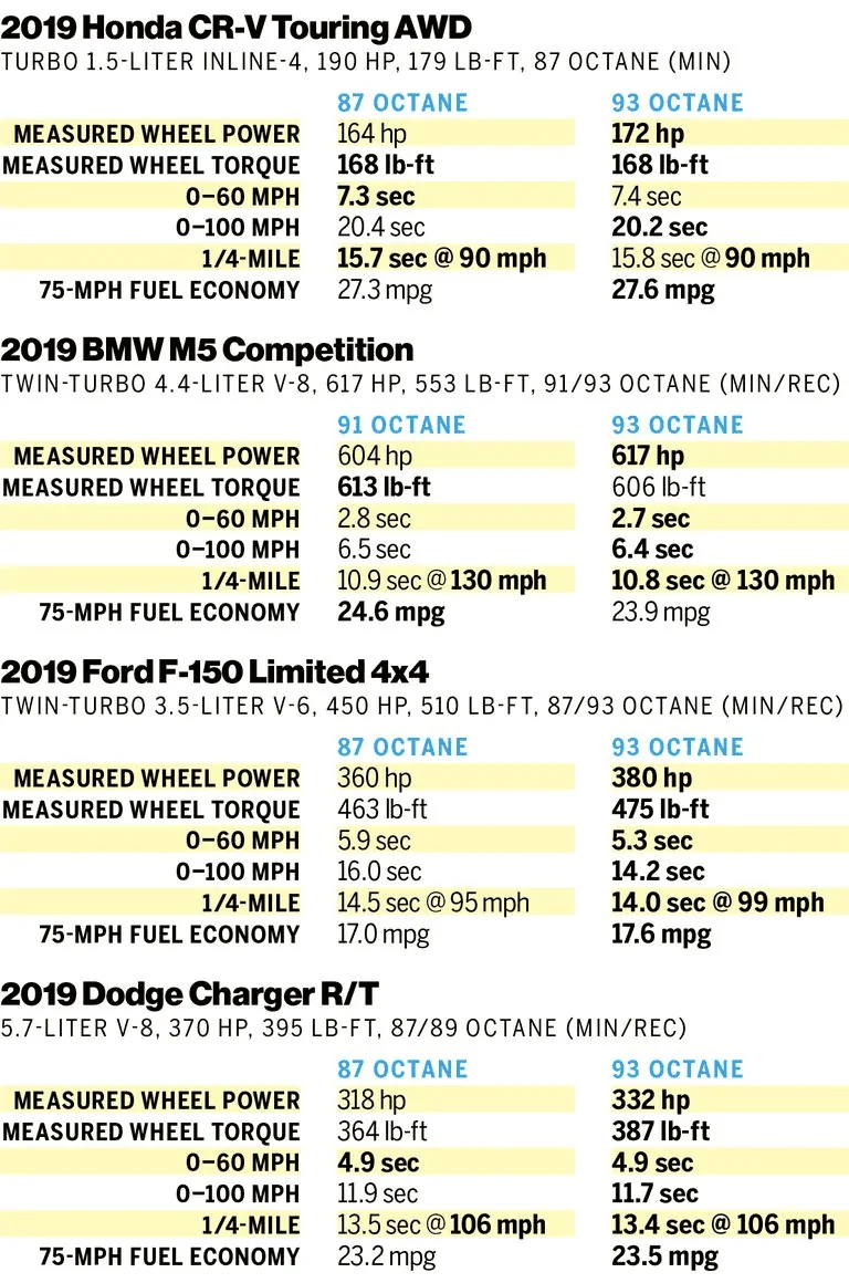

Recent article on regular versus premium.
Is Premium Gas Worth It? We Test High Octane on 4 Popular Vehicles (caranddriver.com)
Numbers I saw for the previous single scroll 2.0T was 240 h.p. on premium, 233 on regular.
I just read the article. C&D got some interesting results. Here's the summary:
Ford Bronco Sport What a difference 91 octane makes in the 2.0 motor. 1662079579802
The difference 93 octane makes in the F-150 is substantial. The times improve more than a 20 hp difference would suggest. 0>100 dropped from 16.0 seconds to 14.2?! That's huge.
Oddly, the Charger saw greater increases in hp and torque yet its times stayed essentially the same.
By nature I call foul. No other vehicle on that list showed that much impact 0-100. And better still even the data specific to the F-150 for 0-60 is half a second like most of the other vehicles. I call outlier data point that does not fit with the other trends. Something is wrong.

That said, what C&D found was a 20 hp increase with the F-150. Granted, that's a larger, more powerful engine, so we can expect the difference with the BS BL 2.0L turbo to be less, but the bigger factor is the decrease in the truck's times. 0>60; 0>100; and 1/4 mile (time and speed) all improved significantly with 93 octane.
Of course, just because it's also a turbocharged Ford does not necessarily mean we can expect similar improvements with the BS BL.
Then again, see Mark's post #61. Mustang testing showed a bit over 10% difference -- or about 25 hp with a 2.0L Badlands -- a drop from 250 to 225 hp.
One take-away from the C&D testing seems to be that there are large differences between vehicles. Some were slightly faster and/or made more hp and torque with 87 octane. There is no consistency.
