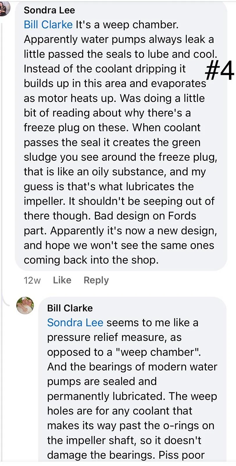

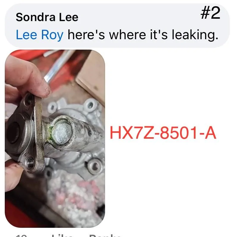

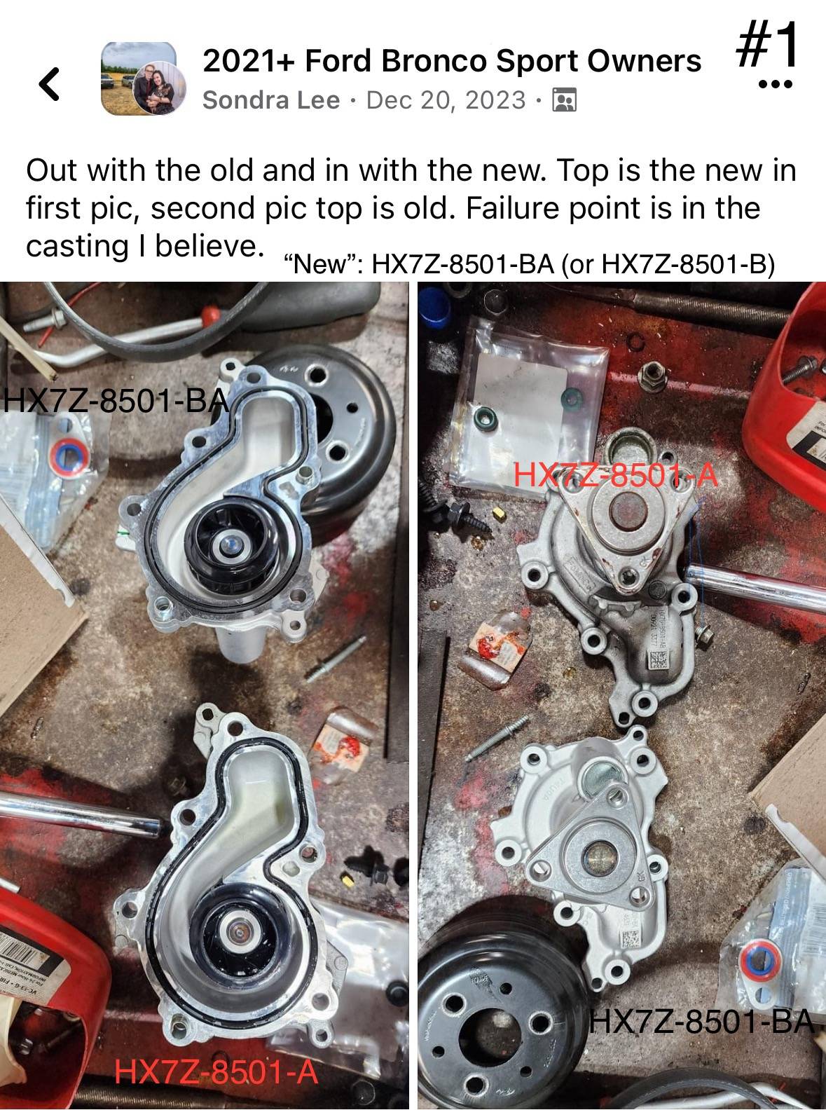

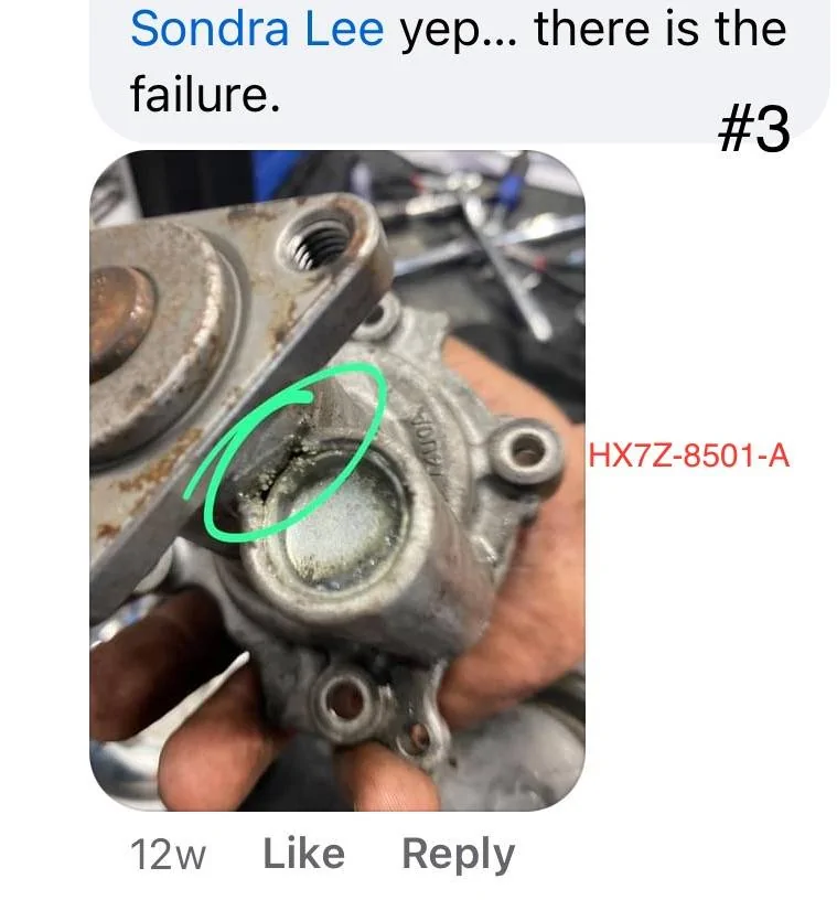

Thought we had a radiator leak to find out from the dealer that there is a known issue with the BS water pumps. Get yours checked and replaced while under warranty as there is no recall. I own the BS-OB 2021
Here is one example of the HX7Z-8501-A water pump replaced with a “New” HX7Z-8501-B (or HX7Z-8501-BA) water pump.Where on the pump is it leaking? (gasket, bearing snout)
