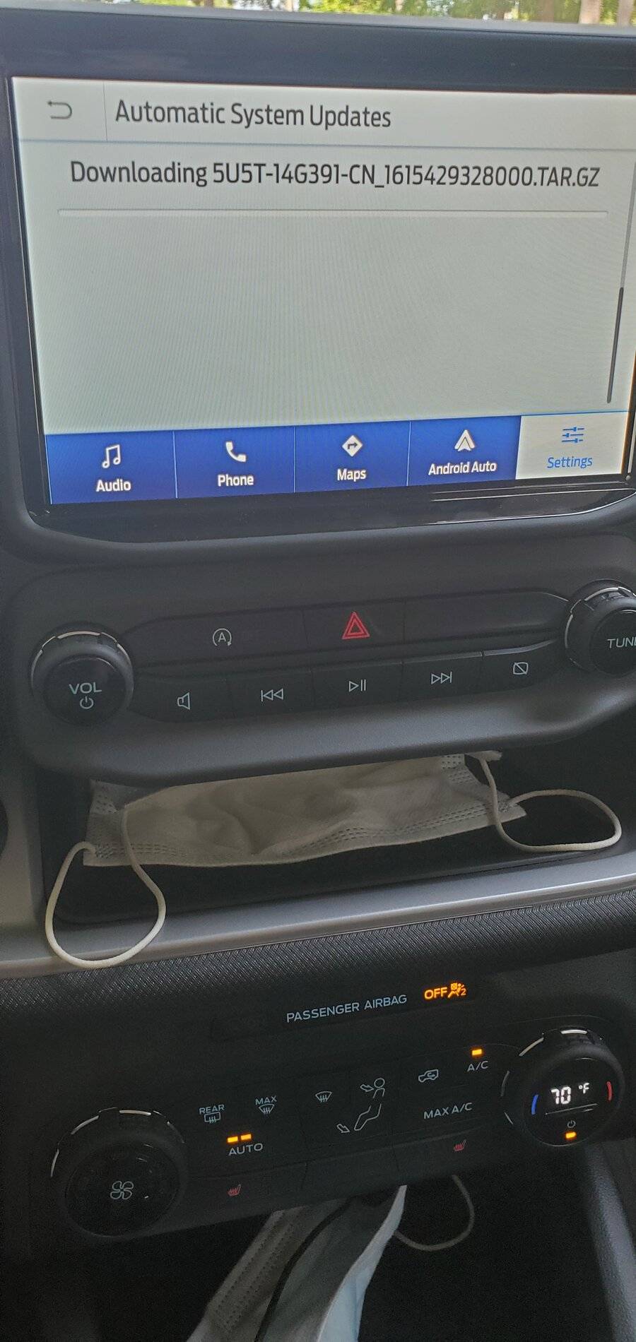

Odd you all had to do anything.
Mine downloaded and installed 3.4 overnight with no interaction from me. All on my home wifi.....
that's probably the bigger point if you have a strong enough wifi connection and set it to auto update. My wifi is crap, the routers are crap, but our community signed a deal with the devil with exclusive provider rights so they pedal crap service and you can't get anything else. I had no choice but to update with USB.
