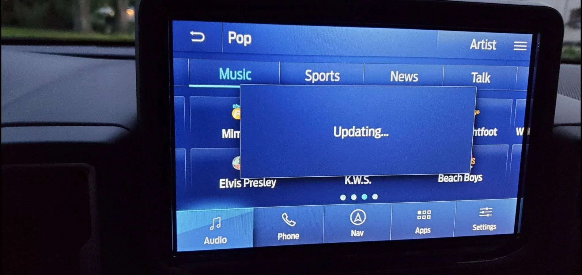

I lost Sirius xm audio on the reboot after the "update complete". Even the preview channel 1 has no audio.
I restarted the vehicle again, then launched xm through channel interface and it's stuck at updating.
Ford Bronco Sport Update to Sync 3, version 3.4 Build 21020 Screenshot_20210704-205259_Gallery
I kept tapping around. I called xm customer care, closed.
I did see something in my xm customer account about sending a refresh signal. I'll try that next.
Refresh from xm home page was a bust using my vin. I'll try again with xm Esn .
Ford customer care chat and xm Custer care chat are both closed.
To reset the head unit do this:
Press and hold the audio on button (located in the center of the volume knob) along with the next track button (the one with the arrow pointing to the right) until the display screen goes dark-then release both buttons.
SiriusXM should recover.
