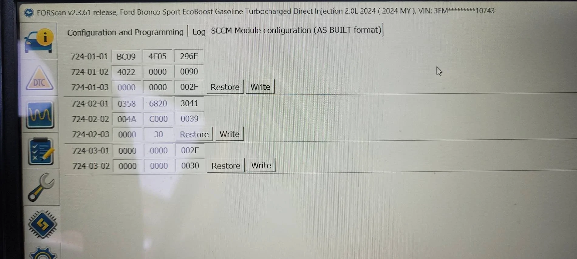

Typical Ford vehicles (F-150, Escape, Maverick, and Focus), the lane change blinker count is stored in SCCM 724-01-01, typically in Byte 1 (the second group of 4 hex digits).
But in your Bronco Sport (724-01-01: BC09 4F05 296F):
• Byte 1 is 4F05
• 4F (binary: 01001111)
• 05 (binary: 00000101)
None of these bit values match the documented flash count nibble pattern (06 = 3 flashes, 0C = 6 flashes, etc.), and this layout appears custom to the Bronco Sport confirming that the (MY ‘24) SCCM is slightly different than older Ford models

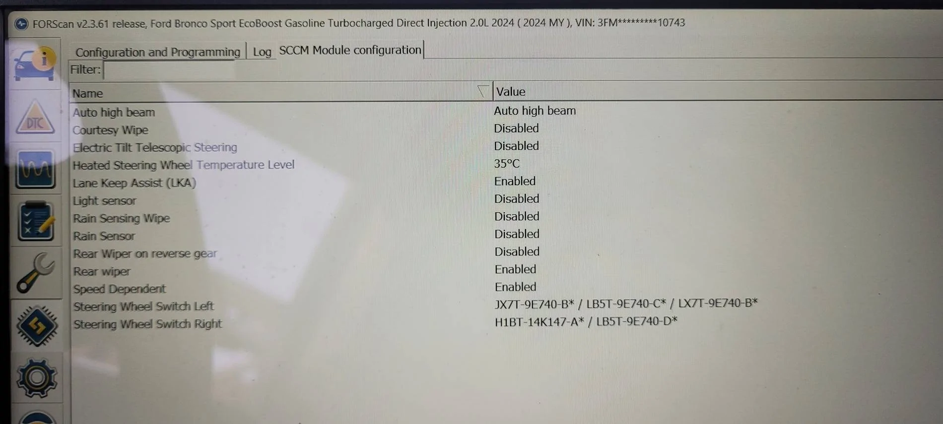

2. In your 2nd pic (plain language SCCM configuration), the flash count isn’t listed and you probably already tried this however I’m including for completeness if others look at the same module in FORScan:
In SCCM, scroll further in this plain English mode in FORScan, look for:
• Lane Change Turn Signal or
• Turn Signal Tap Flash Count or
• Comfort Blinker
3. Try brute force testing 724-01-02: (not 724-01-01 )
If you’re comfortable editing AS-BUILT manually, you can try the following:
Do this only after saving your current configuration (including taking a screenshot or writing it down)
Modify first nibble of 4022
4 (binary 0100) might indicate a base configuration
Try changing the 4 to C:
4022 0000 0090 → 724-01-02: C022 0000 0090
In other Ford platforms, C or E as the leading nibble has been used to bump flash counts
Recommended Process
1. Save original values:
724-01-02: 4022 0000 0090
2. Try this test change:
3. Write → Cycle ignition → Test lane-change flash count (quick tap on turn signal stalk)
If you get 6 flashes, you found the right byte.
Notes:
724-01-01 is almost certainly NOT holding the blinker count in your 2024 Bronco Sport, the SCCM layout changed, likely due to newer firmware
724-01-02 is suggested because it has values consistent with known editable flash count locations on newer Ford vehicles.
FORScan forum users (especially with 2023+ vehicles) report blink count has moved to other 724-01-XX locations in newer vehicles

You are confirming with others have stated which is that the Turn Signal Flash Count is no longer available to modify (at least in the SCCM at its former location for earlier module year Bronco Sports)
Just ran the VIN of a 2021, 2022 and 2023 BS all with co-pilot 360 and premium pack. The software strategy on each one is below and none showed a pending SCCM update in FDRS.
Ford Bronco Sport Turn Signal Blinker Count 1752894321750-4l
Ran the VIN of a 2024 BS with same specs and the strategy on that one is:
Ford Bronco Sport Turn Signal Blinker Count 1752897687280-to
So it does appear the 2024 has different and newer firmware.
The 2023 I am getting is showing this on Ford's side (can't plug in until I get it next week to verify)
Ford Bronco Sport Turn Signal Blinker Count 1752897764241-or
Very similar config to Quashish above.
Method 1: Modify the last byte (0090)
Try replacing 90 with the hex code for 6 flashes:
• C0 = 6 flashes (hex C = 12 decimal)
• 60 = 3 flashes (hex 6 = 6 decimal this sounds reversed but appears in some modules)
Step:
• Try changing this to 00C0 → 724-01-02: 4022 0000 00C0
• Or try 00C6 if you suspect bit position needs shifting
Method 2: Modify first nibble of 4022
C022 0000 0090 → 724-01-02: C022 0000 0090
That last byte (0090) is formatted similarly to other Ford flash-count fields in newer vehicles
• It has a clean 00 + 90 structure that could encode multiple option bits including flash count, auto light delay, or steering assist options
• FORScan forum users (especially with 2023+ vehicles) report blink count has moved to other 724-01-XX locations in newer vehicles
The last two spots are place holders that FORScan will auto-fill on its own to balance the hex equation based on whatever other changes are made. You can change the 00, but the 90 cannot be changed. If you manually change it and try to write the change, FORScan will change it back. If you change any other values in any byte on that line, FORScan will change 90 to whatever it needs to be to balance the equation. That's the beauty of FORScan......it won't allow people like me that are not trained software guys to mess something up too badly.
Notice on 724-01-01 of my car and Quashish car, the only difference in the values is Xxxx xxxx xx--. Because I have an A there and he shows a B, mine ends in xxxx xxxx xx5F and his ends in 6F.
Increasing the turn signal flash count is not something I care too much about, but I don't mind being the guinea pig to test stuff out. I can see why some might be wary to experiment on their vehicles, but I'm not one bit scared to FAAFO. I get a kick out of these little projects and I'm looking forward to messing around with mine and contribute here if I can.

That’s right and I did make a mistake so
I edited my post to remove changes to the 0090 because that is the checksum field (my error still shows in the post from @rugedraw because it contains a copy of my original non-edited post)
In 724-01-02: 4022 0000 0090, the 90 at the end is most likely the checksum which is a value that FORScan calculates automatically to validate the integrity of the data in that line
I looked up the procedure used to calculate the checksum but it’s a bit complex and FORScan calculates the checksum so knowing the algorithm isn’t that useful
To summarize:
4022 → first data word (16 bits)
0000 → second data word (16 bits)
0090 → checksum (the last byte)
Step-by-step:
1. Edit the data portion only:
For example, change 4022 to 406C (for 6 flashes)
2. Let FORScan auto-calculate the checksum:
The third group (e.g., 0090) will be updated automatically to match the new data
3. Write the value → FORScan validates and commits the change safely
