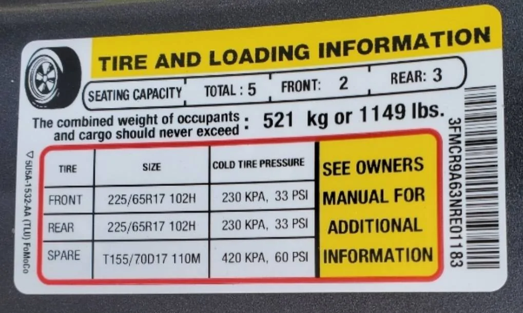

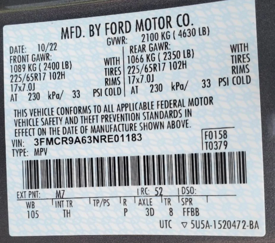

1,149 lbs is your payload, which reflects the BS's GVWR less the GVW the day it rolled off the line at the Ford factory. When you mount the Class II hitch, you'll eat into the payload, of course. Let's assume the hitch weighs 49 lbs, for easy math. So, you sit at ~1,100 lbs of available payload ... which is still quite a lot.
Because it's just you traveling and camping, payload probably won't come into play as much. For most folks, camping involves a couple, at least, and often includes a larger family with children and pets. People regularly underestimate how quickly the weight piles up. With just a single person, it's less of a concern. That's why, for most people, they're way over payload (GVWR) before they exceed tow rating. Your situation is likely reversed.
Even if you max out the tow capacity at 2,000 lbs and drop the heaviest safe amount onto the hitch at 15%, your available payload will be 1,100 - 300 = 800 lbs.
So, you have 800 lbs for yourself, gear, the hitch, any accessories added, roof rack stuff, duffel bags, and anything else in or on the vehicle. Should be pretty easy with just a single person.
I would shop for trailers that had GVWRs of 2,000 lbs or less. As with the Bushwhacker brand, a stout axle can give a pretty large GVWR. In those cases, I'd probably look more toward the dry weight (yes, I still think it's mostly a useless number) as directional and insist on at least 750 lbs of cushion. That will get eaten up incredibly fast with factory options, dealer options, and all the gear. Even things like a tank of propane, awnings, and the 12V battery are often not included in dry weight and that stuff is heavy. It adds up really fast. #beatingadeadhorse
