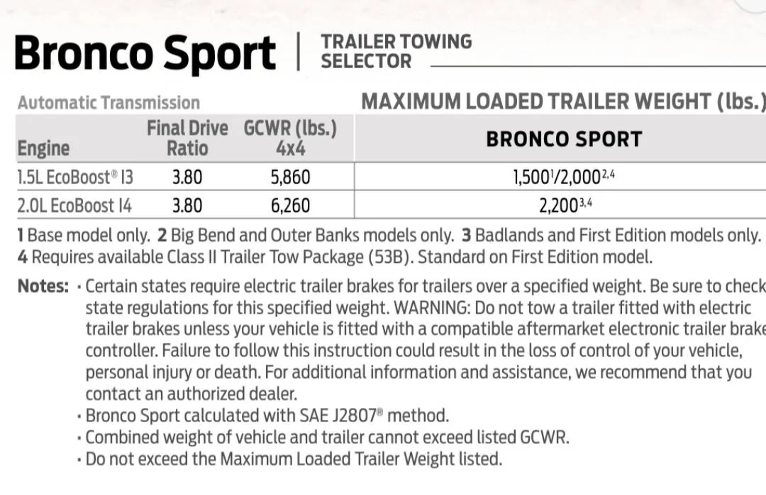

This Ford document lists the towing capacities and equipment. This is from 2021
I've looked at this before and didn't like what I thought it was saying. Seems like BASE is 1500 and Big Bend is 2000 ... not sure as to why they are different.
Ford Bronco Sport Towing capacity for Base model without factory install towing package? Screenshot_20230420_203653

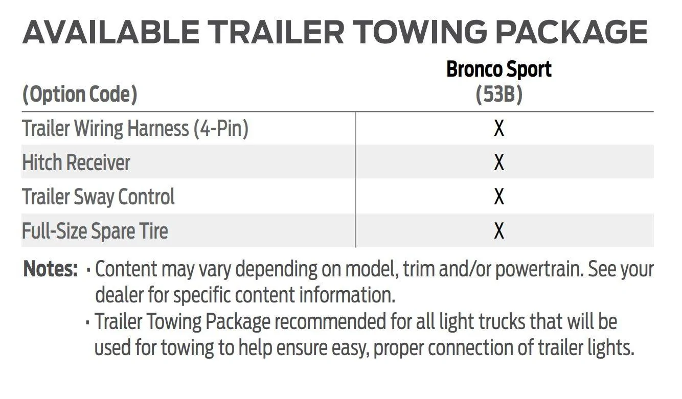

Ford Bronco Sport Towing capacity for Base model without factory install towing package? TowPackg
Sway control is a safety feature. Whether or not it's necessary is up to you. Drivers with a lot of experience towing will likely be fine.
So what does sway control do? If the computer senses trailer sway while you are towing it will display a warning on the dash, slow down, and if necessary apply brakes independently on all four wheels to prevent loss of vehicle control. Sway is usually not an issue if your trailer is properly loaded, but with a short-wheelbase vehicle like the Bronco Sport it can get out of hand quickly if you don't recognize it and react quickly. Here's what can happen if you don't react quickly enough.
If you experience sway you should double check and correct (if necessary) weight distribution. If there's nothing wrong with your weight distribution it's probably the way the wind is hitting your trailer, and you should drive slower until the wind changes. The video below demonstrates sway due to improper weight distribution.

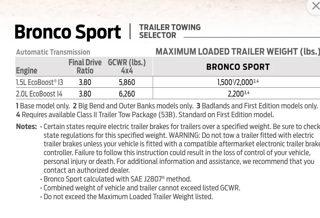

What I don't get or understand is why the base model on the Ford site does not state this about sway software and transmission cooler requirements. My 2023 outer banks model is rated for 2000 mile capacity, and I too do not have the factory trailer package.
*It does say in the chart a #1 and says base model only 1500. So definitely your OB is the 2000. On the other info about towing components it does list the sway issue but at the bottom as a note it says components may vary by model. Evidently the issue regarding the sway control on the Base model only deals with software. For whatever reason the base can have all components installed afterwards to make it pull a trailer but because the software for sway control is not compatible and not an option has made for lower the base down to 1500. IT REALLY SUCKS! For your OB without factory install of tow package you can complete it after the fact and then have 2000 pound towing capacity.
Ford Bronco Sport Towing capacity for Base model without factory install towing package? Screenshot_20230421-123335_Gallery
