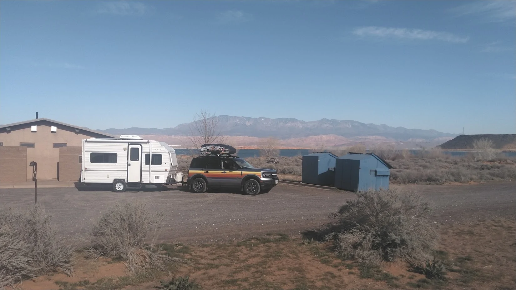

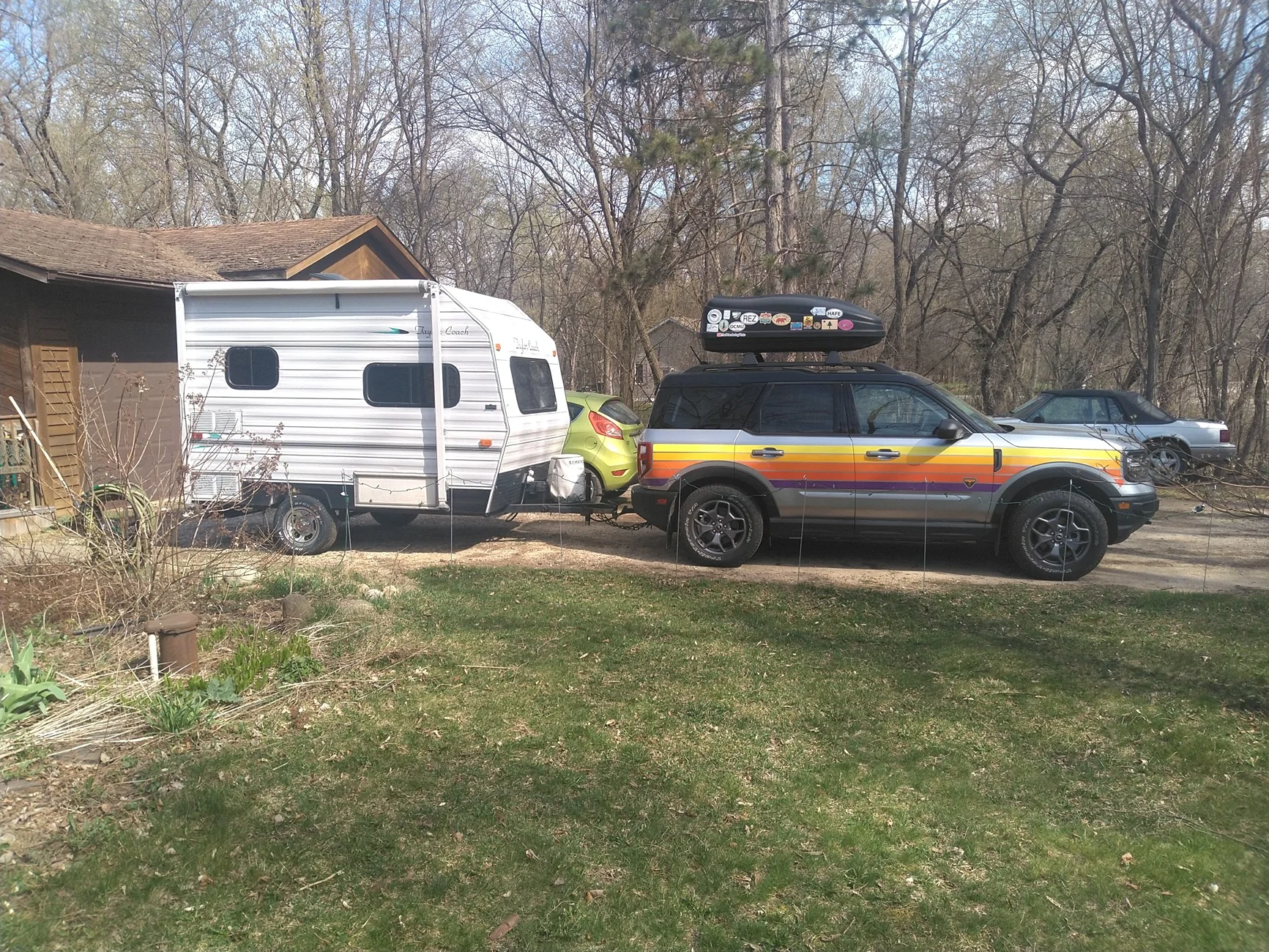

I have a 2022 Badlands and tow a variety or trailers, utility , boat, and two travel trailers 12', about the same weight as your tent trailer, and a 15' that weighs a bit more. Drop depends on the height of the trailer coupler, it should sit level when hitched. Using the factory hitch. I did add air bags to the rear, helps keep the Bronco level. Both my travel trailers have electric brakes, the other trailers do not. The travel trailers are made in Millgrove Ontario Canada, Taylor Coach.
