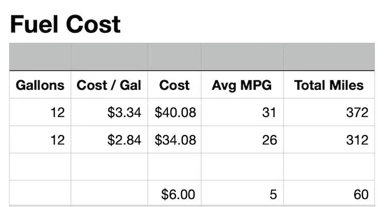

Maybe I miscalculated, but here are my latest findings using Costco Premium at 50 cents per gallon more than Regular:
Ford Bronco Sport Top Tier: Regular - MidGrade - Premium? 31 Avg MPG
Ford Bronco Sport Top Tier: Regular - MidGrade - Premium? Costco Premium 12-29-2023
Ford Bronco Sport Top Tier: Regular - MidGrade - Premium? Costco Gas Prices 12-31-2023
Ford Bronco Sport Top Tier: Regular - MidGrade - Premium? Fuel Cost
So, I'm able to go an additional 60 miles at a cost of $6 more, or 10 cents per mile, using 93 Octane?

372 miles on your fill / $40.08 fill = 9.28 cents per mile on 93.
312 miles on your fill / $34.08 fill = 9.15 cents per mile on regular.
There's some variability in there as I don't have the fill dates and it may have been influenced by gas prices generally falling after the regular fill leading up to the 93 fill.
For you, across the fill, it looks like a rounding error basically, it's a difference of a tenth of a cent per mile. At that price difference I would fill with supreme, if that MPG difference of 5 MPG holds, but only if you noticed some sort of performance difference. Costco certifies their additive pack meets top tier in all grades. They don't certify that additives are greater in the 93 octane, just that it's higher octane.
There's probably two other factors here:
A) I have less than 9k miles on the odometer; in my experience, the 2.0L EB didn't fully break in (for fuel economy) until 15k miles.
B) The 2.0L EB is less fuel efficient than the 1.5L EB; I would expect the difference between 87 and 93 to be less from an MPG perspective as well.

I appreciate the input. :clap:
BTW: I was just curious about the 93 Octane when I went to fill the tank again on the 29th (last Friday), but I'll be going back to 87 Octane tomorrow. I want to keep the fuel cost as low as possible (accumulative effect).
First, be sure you are hand computing, not using the dash display. Second, you can't compare fuel economy using only a single tank of gas; there is far too much variability to get an accurate computation on such a small sample.
Ford recommends tracking miles traveled vs fuel used over at least three tanks to get an accurate measurement. I would add that you try to also control for the type of driving and weather conditions. Comparing three tanks of regular everyday driving (mix of city/highway) to three tanks of pure highway driving is not a fair comparison. Similarly, three tanks of highway driving with a tailwind will yield significantly different fuel economy than three tanks with a headwind.
Unless you are comparing fuel with and without Ethanol, there is no significant difference in the amount of energy between regular and premium, which is the only way you can achieve the kind of efficiency gain you saw. The difference you measured is nearing 20%. If it were possible to get 20% better fuel economy by simply switching to premium it would've been mandated by our benevolent overlords in the EPA long ago.

Yep, you're correct. The absence of a validated scientific method, to correctly determine the results, will lead to final outcome inaccuracies.
I wanted to do a "what if" just out of curiosity since it was the last time I'm purchasing premium.
No long term benefits realized for the substantial increase in fuel costs by always using the premium grade.
