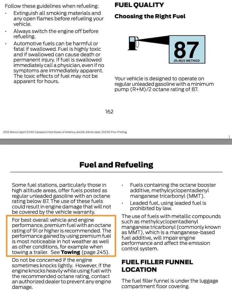

I appreciate the math @The_Jimmer.
I'm leaning towards purchasing the Regular Grade again even though the Avg MPG slightly improved.
However, I'm scratching my head and wondering if the "performance gained" (under "Fuel Quality"), when it comes to life of the turbocharger, will the same logic apply (may be a "dah" moment on my part)? In other words, will the additional cost of higher octane translate into less problems with the turbocharger over the long term?

Apparently, from articles I've read in the past the higher octane doesn't burn as hot as the Regular Grade.
You're close. Premium fuel requires more heat/pressure to ignite. Once ignited both produce the same amount of energy (as measured by British Thermal Units, or BTUs). The primary benefit of premium is that the powertrain control module will not retard timing as much due to detonation as the engine gets hot.
The improvement in performance is only at the top end of the power curve. The engine produces advertised maximum horsepower only with premium fuel. With regular you can expect up to a 10% reduction. What this tells me is using premium will have no effect on engine durability unless you are in the habit of frequently utilizing the additional 10% (or so) power available. In that case, you will see a reduction in longevity--the harder you work an engine the more wear you generate.
I'm grateful for the input @Mark S.. It has allowed me to have a better understanding.
