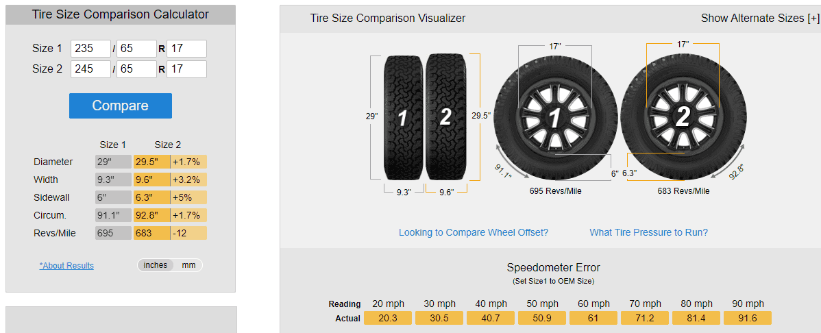

Ford Bronco Sport Tires: Are there any significant differences between 235/65/17 and 245/65/17? Screenshot (1)
Not every manufacturer is exactly the same, but this gives you the general idea.

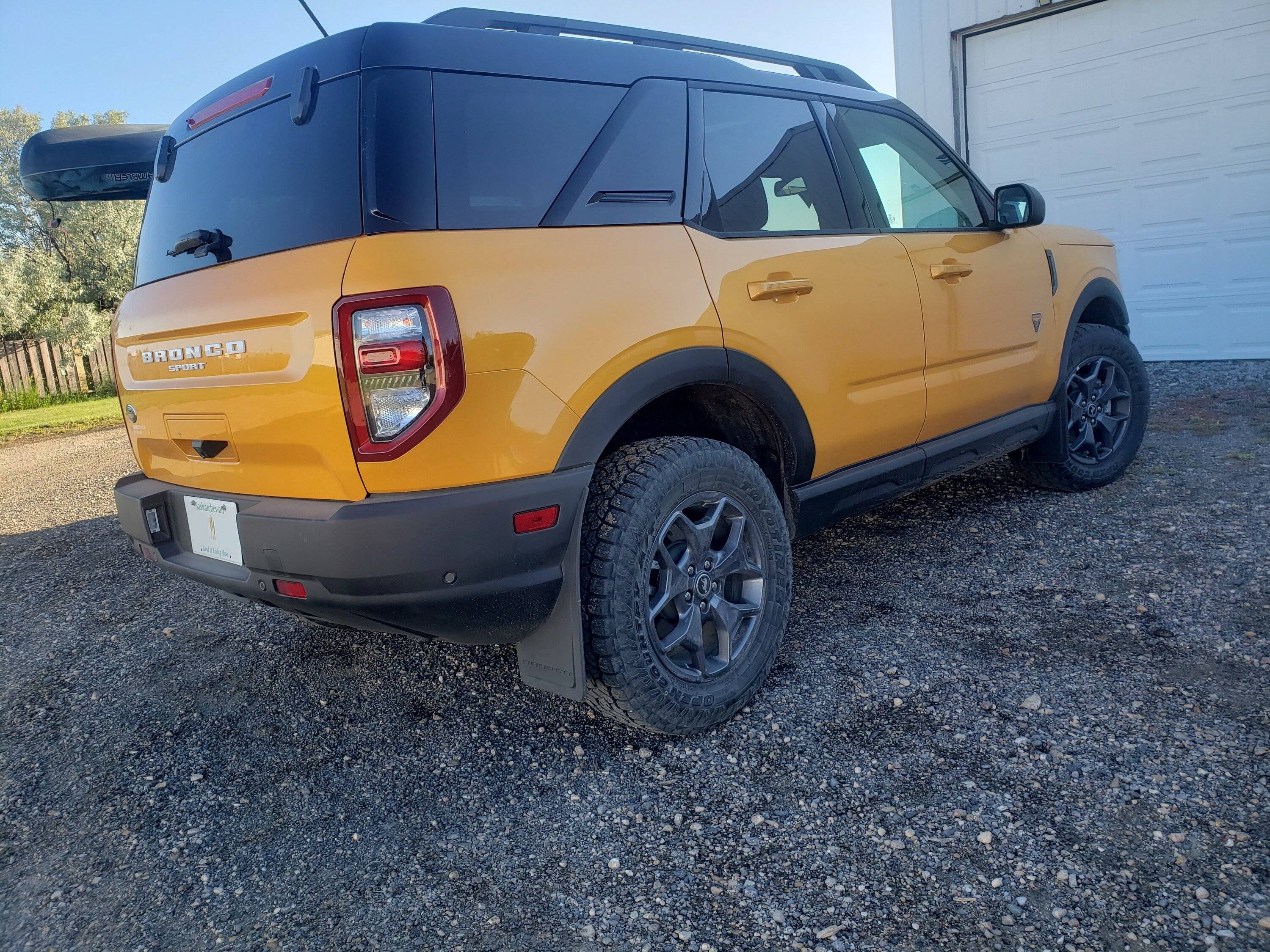

I have the 245s. Take the padding out and the spare fits fine. I love these tires.

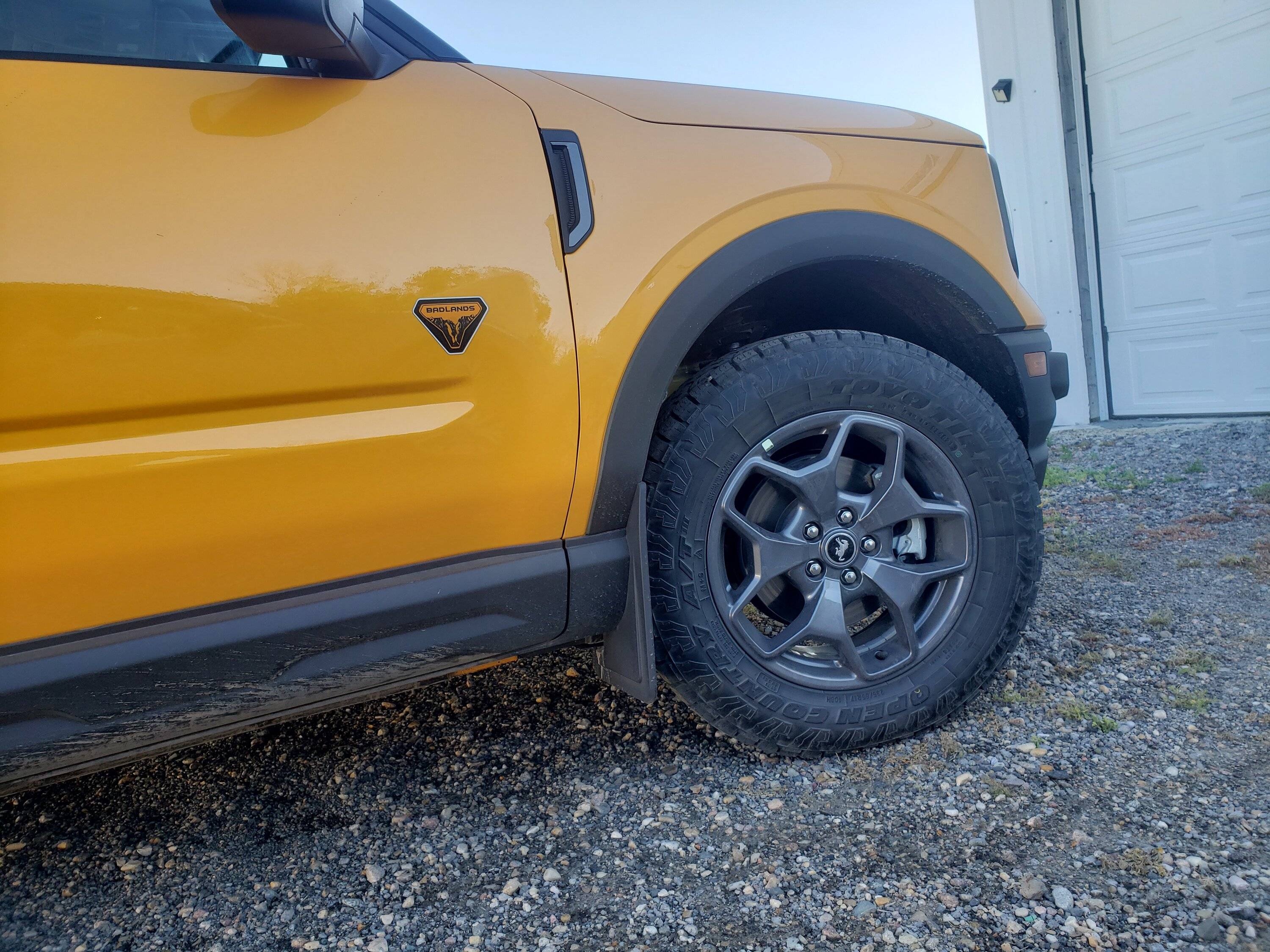

Update: I ended up getting the 235/65/17's for the simple reason that they were in stock at my go-to tire shop and would have taken a week or two to order the 245's.
I absolutely love the look of the AT tires on the bronco sport and there seems to be basically no compromise for swapping from the stock tire. I noticed that the bronco seems to have more responsive steering and better cornering with the new tires, and for some reason I went from ~11L/100km to 9.8L/100km average shortly after the swap. Road noise is probably louder, but it's negligible. Probably notice it most at very low speeds because the TOYO's seem to hold onto gravel and rocks more than the Pirelli's. There is a lot less sliding around on the crappy gravel roads around here, but it's not quite 100% stable, which is probably more to do with the short wheelbase than anything.
Overall I am super happy with the new TOYO Open Country AT3's and am actually surprised by how much more enjoyable the Bronco is to drive now.
The stock Pirelli's seem like decent tires so I'm thinking they were setup poorly at the dealership or something. They will find a new home on the wife's RAV4 so they will not go to waste!
With the 235's there is basically no compromise over the stock tires, and in fact feel way better overall, which may or may not also be true for the 245's. I believe that the 245's would 100% look better than the 235's if looks are a priority. If you are just in it for the chunky offroad-y look, definitely take a look at the BFG KO2's as those give a way beefier look than the TOYO's. For me, the Bronco Sport is my daily/highway vehicle and I needed the tires to perform well in dry/snowy weather since we get wildly oscillating weather here in the spring/fall where it can feel like full blown winter one day and summer the next day, so the TOYO's just fit the bill for performance and MPG. We're going to be offroading quite a bit next week so I can update again after that if there's any interest.

So you can now completely close the lid?
Yea. See the photo I posted it closes the whole way. 245’s are the way to go. No reason not to.
