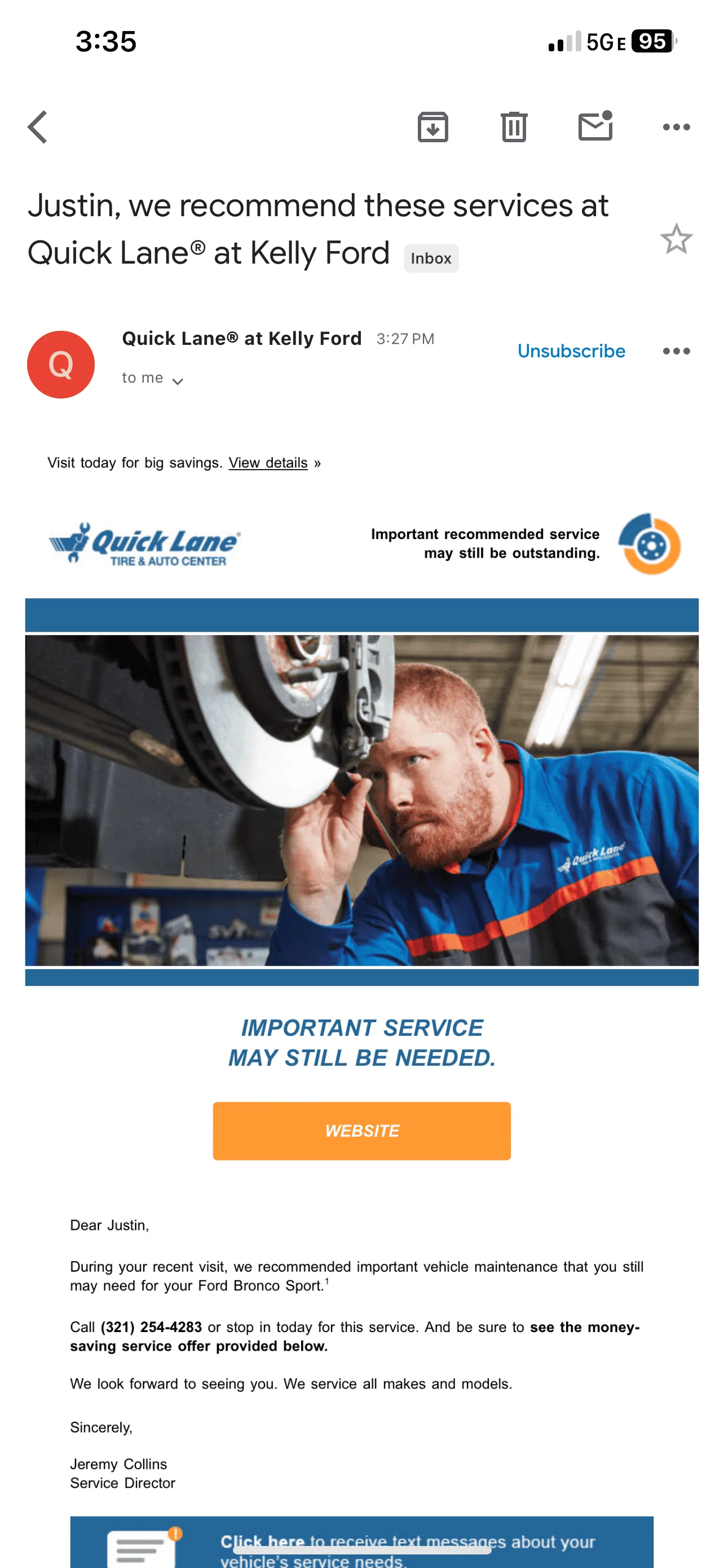

I wonder if they mean the tire rotation they did half way? LOL

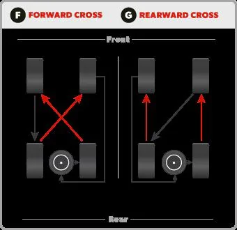

about 5-tire rotation....I assume the new (spare) tire goes on to one of the rear?? I could try to measure the tires to see which one wear the most.
any thoughts? anybody??

Forward cross method. You’d want to start from the beginning and probably buy a matching wheel instead of the black steelie.

thank you! I got a matching wheel for the spare already so I will be set to go.
Now I just need to figure out and do more research on how to reset the TPM. I bought one for the spare to be installed.

a quick report on this matter....I put in the TPMS in the spare wheel and rotated into the driving wheels. first day the TPMS was reading the now "spare tire" in the trunk. I know because It was reduced to 12 psi to fit into the trunk. Then....I didn't do anything then the TPMS seems to automatically picked up the new tire installed and updated the pressure! looks like we have a "smart" system :)
