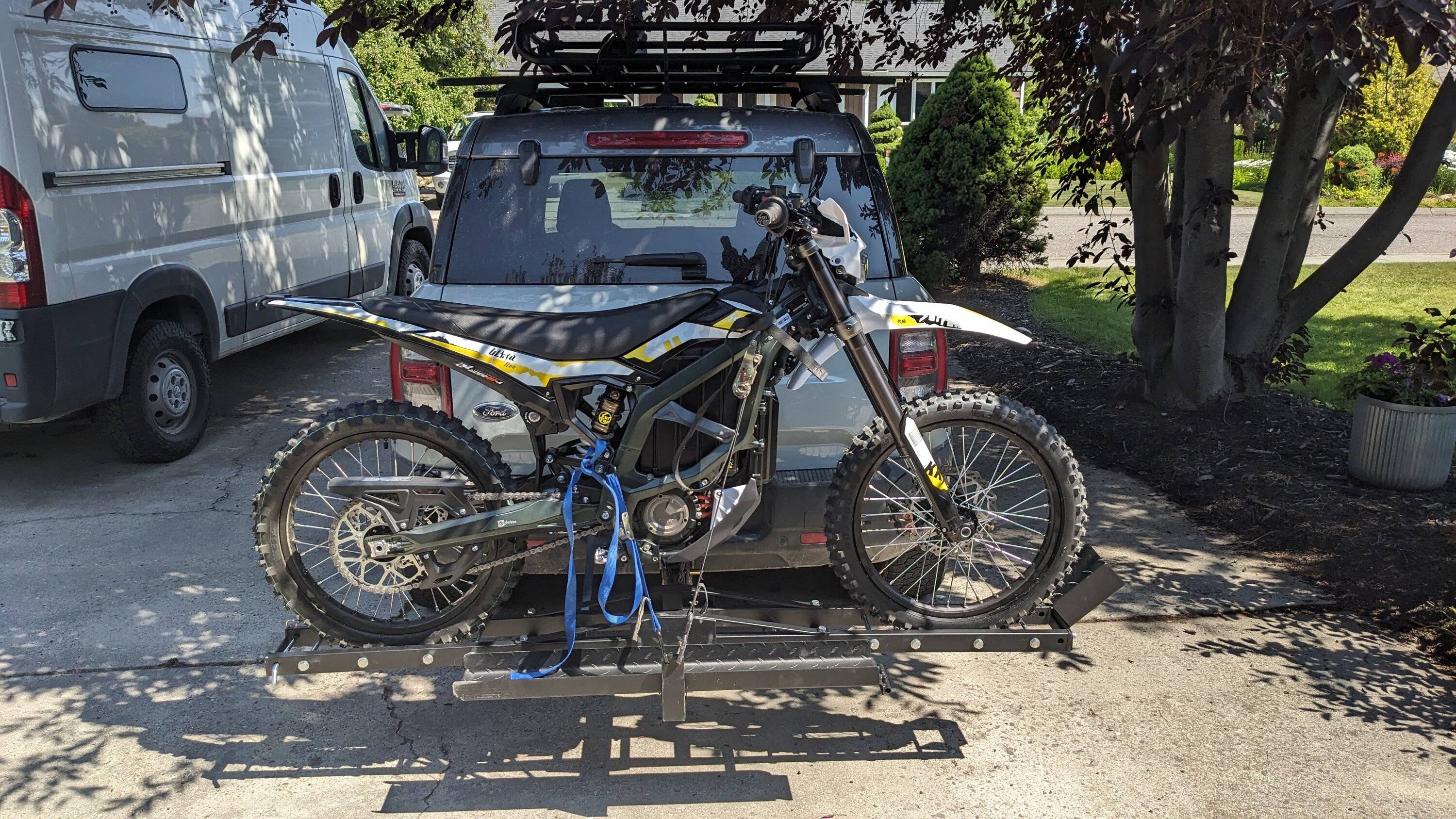

FWIW, lighter bike, around 185 lbs plus the weight of the hitch rack, but I don't even notice it on the back of the Bronco Sport. Definitely does not seem to effect handling in experience.
Ford Bronco Sport Thoughts on running more then recommended tongue weight with modifications PXL_20230709_173615306
Thanks for sharing, nice set up man!
