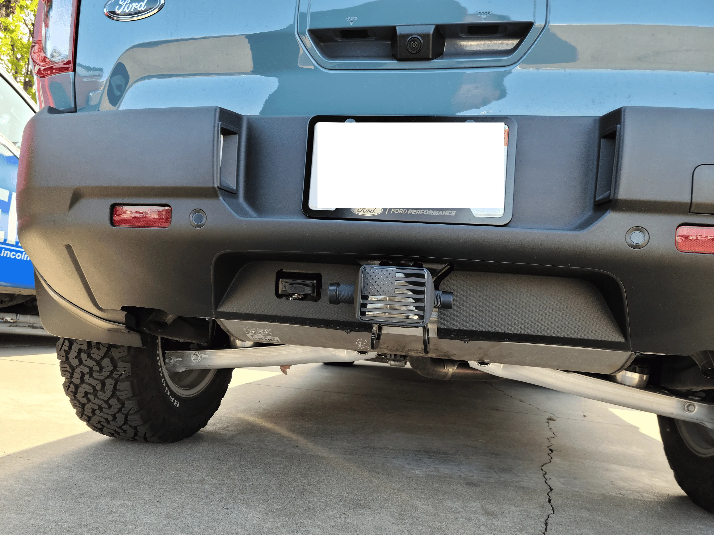

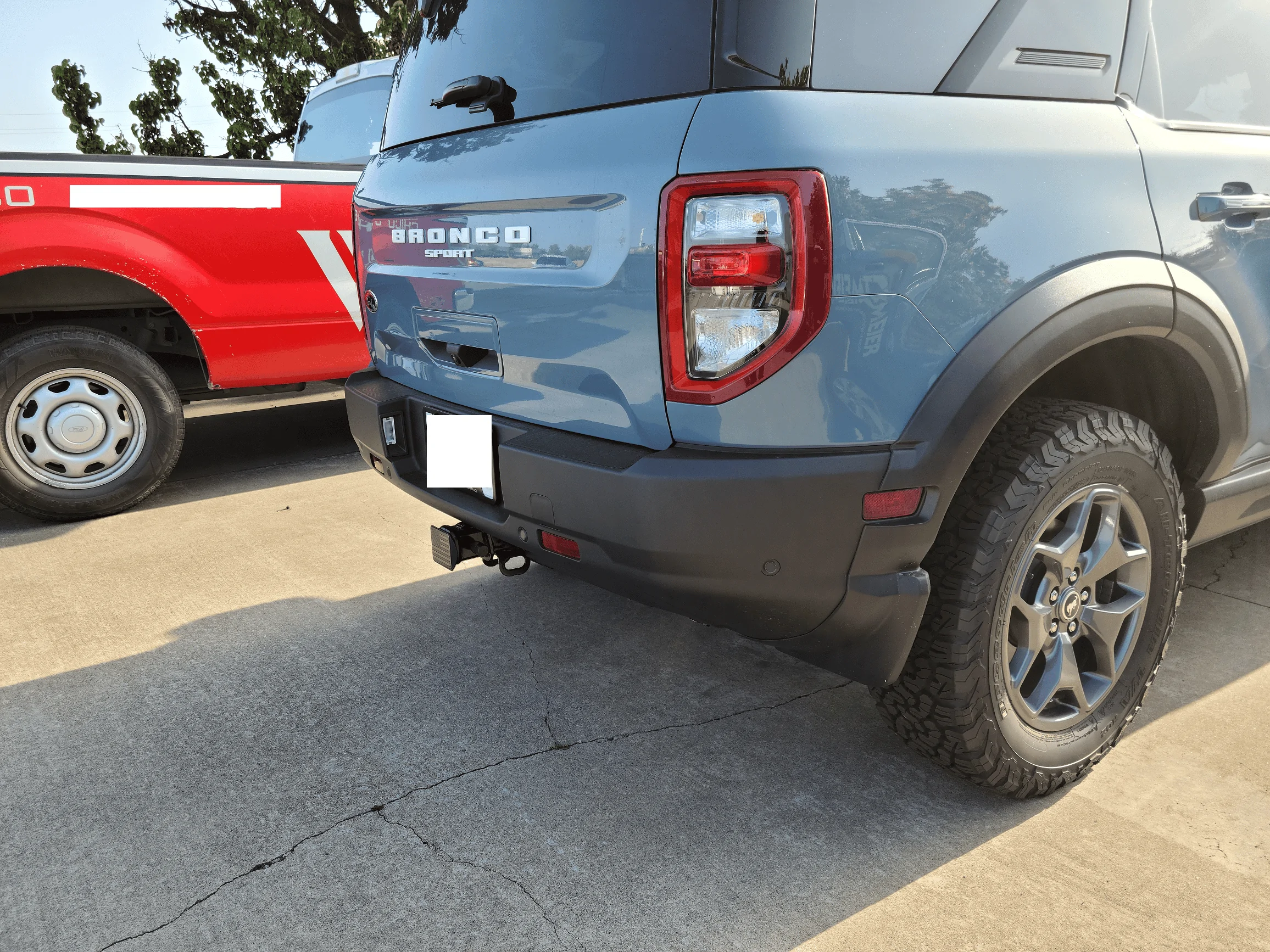

I'm not going to post the dealer because they are doing the best they can to remedy the situation, but after the OEM hitch came in that I wrapped into my deal, it's not looking pretty. I was in complete and utter shock. They obviously did not take the hippocratic oath.
I've read all the other posts so don't start with the "why didn't you get one with a hitch factory installed?" The short answer is that some ahole rear-ended me in my Jeep and it was totaled and I needed a new car immediately. This was what was on the list.
They're going to get me a new bumper that has the cutouts from the factory.
But without further ado:
Ford Bronco Sport This is the example of how not to install trailer hitch... PXL_20220322_140204761
Ford Bronco Sport This is the example of how not to install trailer hitch... PXL_20220322_141832131
I keep telling my 10 year old to quit stealing my tools and doing side jobs for absurd amounts of money ? ?
