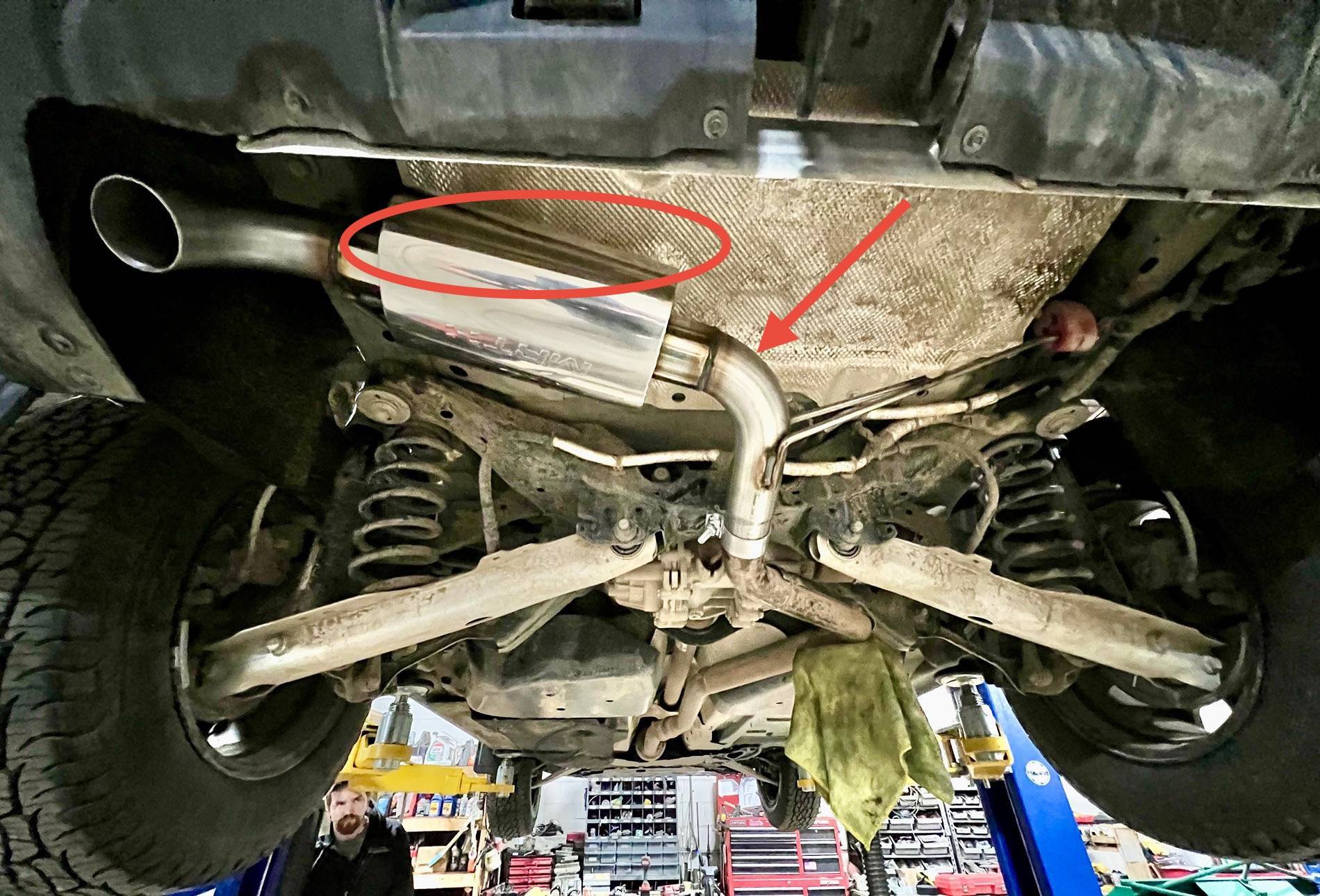

Thanks for posting the pic, looks like very clean and professional looking product and installatIon!
for your 2025 Badlands, did the install require any cutting at all of any portion of the vehicle itself?
See red arrow: The 45° bend pipe into the muffler (from the vehicles exhaust pipe) perfectly & smoothly curves along the existing metal of the vehicle (maybe is a heat shield)
See red circle: And the beginning of the muffler perfectly notches in with the existing metal of the vehicle
Did either of those two areas or other areas of the vehicle require notching or cutting?
Ford Bronco Sport Rattling rear noise called a “feature” IMG_5001

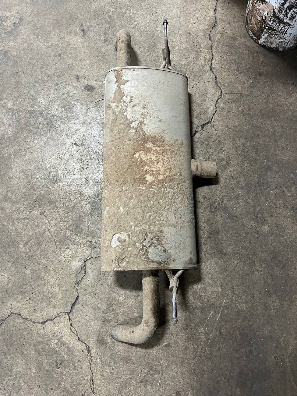

no cutting other than the stock muffler. I think it is just the angle I took the picture at. It will be on the hoist Saturday and will get more photos.
in the meantime here is the top of the stock muffler. It’s like a giant shelf! LOL!
Ford Bronco Sport Rattling rear noise called a “feature” IMG_0546
