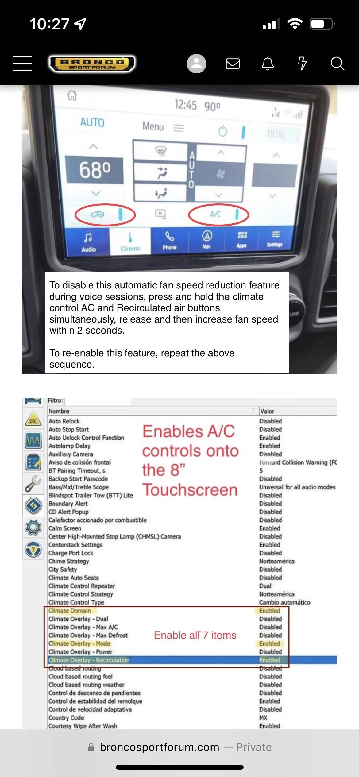

70

5. Climate controls appear digitally on the 8" Display
6. Bambi Mode: keeps fog lights on when high beams come on
