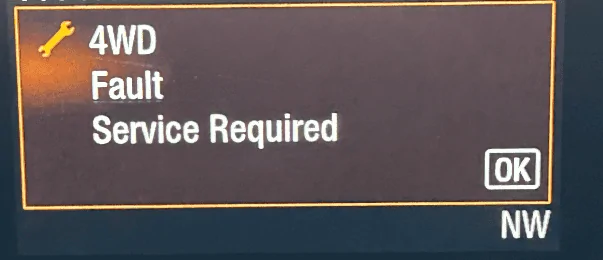

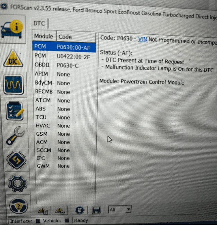

Hoping to get some advice here with some hiccups I'm running into when attempting to update my tire size via ForScan. I've recently upgraded my stock 225/65/17 (2202mm circum) to 245/65/17 (2357mm circum) -- calculated circum via two different online tire calculators. I was able to successfully write in the new circumference and that's when the expected AWD error + orange service wrench came up on my dashboard and DTC PCM alerts came up on ForScan.
I followed the directions noted here (https://forscan.org/forum/viewtopic.php?f=16&t=15994&sid=2c2e7131453abf2d477a5b00351ca3f8)
to relearn the PCM vehicle data. I also found this thread (https://www.broncosportforum.com/forum/threads/speedometer-calibration-with-larger-bigger-tires.1992/page-3#post-159972) that suggests to relearn the AWD module, however I noticed AWD module does not show/exist under my list of DTCs.
I am using ForScan v2.3.55 and Vgate vLinker FS OBD2 USB Adapter to try and make these changes.
I am wondering if I need to use a previous version of ForScan (perhaps v2.3.4 ?) or a different OBD adapter? or if AWD module is under a different acronmy?
Appreciate any help getting over these bumps ?
