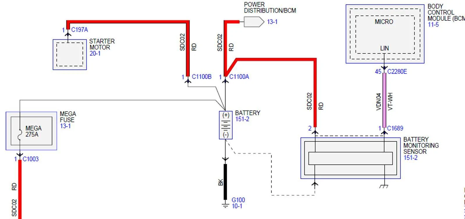

Nope. With the negative clamp to the fender bolt, the BMS is still in the circuit.

Well...As I said in my post that you quoted:
"It's always best to have a drawing/schematic (picture is worth 1,000 words) even for something straight-forward..."
Turns out a schematic would have saved me from incorrectly stating that the fender ground and negative battery terminal are electrically the same (a direct connection).
I was going from memory (never a good idea) and was thinking it was like (almost) every vehicle ever made with the fender connected directly to the Neg(-) terminal.
I just went out to the garage and looked, and sure enough the ground cable does appear to be connected such that any current it carries DOES go through the BMS before reaching the negative terminal -- as you've been saying.
I found this schematic:
Ford Bronco Sport Strange issues 1740281027632-9
I'm a technician (but not an automotive tech). I had forgotten I had that drawing, but I have to say that -- had I looked at it before posting -- it does seem to show the fender ground cable connected directly to the negative battery terminal -- at least it can be interpreted that way.
An enlarged view:
Ford Bronco Sport Strange issues 1740281725708-5t
Different industries -- even different mfrs -- have their own schematic symbols. I'm not familiar with the one above.
That's my story and I'm stickin' to it. :cool:

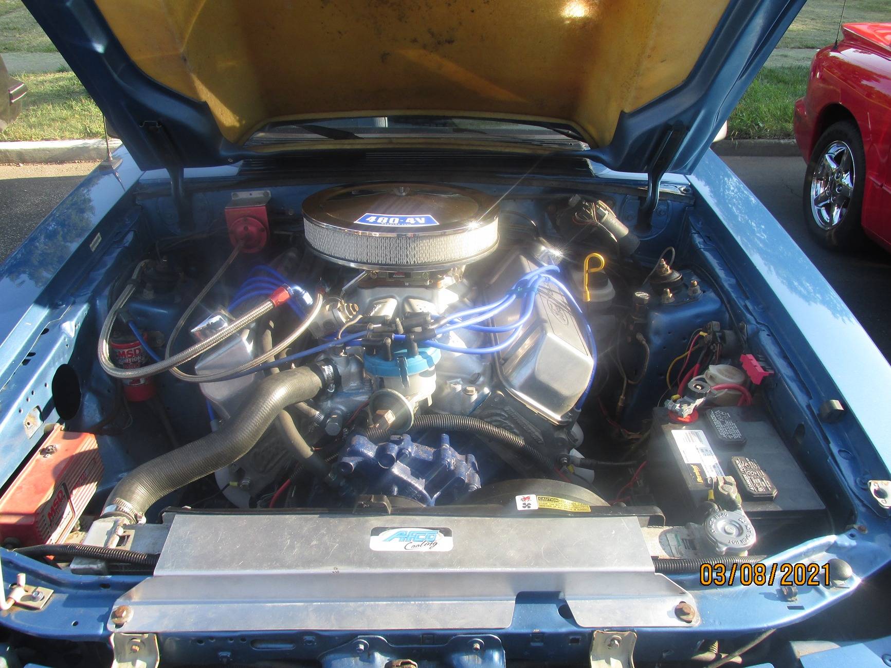

I bought a tester at Harbor Freight and tested it Monday Temp Outside was 49 degrees Battery State Of Health was 100% and State Of Charge was 65%.Now onto the Battery in my Mustang before i charged it for a little while Sunday and Monday it was at like 33% State Of Health and 33% State of Charge. I didn't check it before i started the Mustang but it whipped the 466 BBF over fine and it started but the State of Health was still 33% but State Of Charge was 100% and it came up Replace Battery. I took the Battery to Auto Zone same thing State Of Health 33% but State Of Charge was 100%. They didn't have a New Battery Like i took out in stock and neither did 2 other Stores and the Hub.
