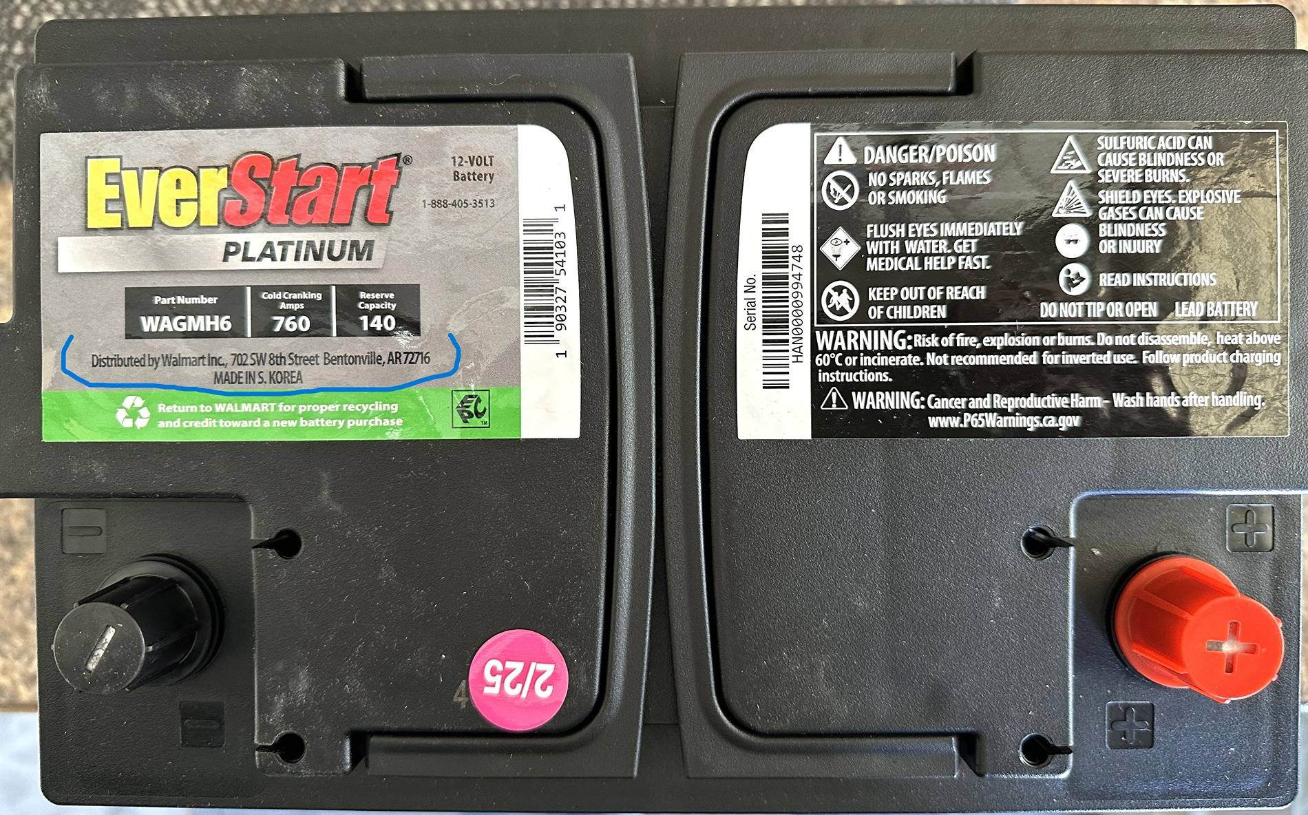

FYI, the battery is made in South Korea and on Walmart's website the warranty is provided by Clarios.

And your reserve capacity is 140 minutes
(vs just 120 minutes on the Motorcraft EFB and Motorcraft AGM Batteries)

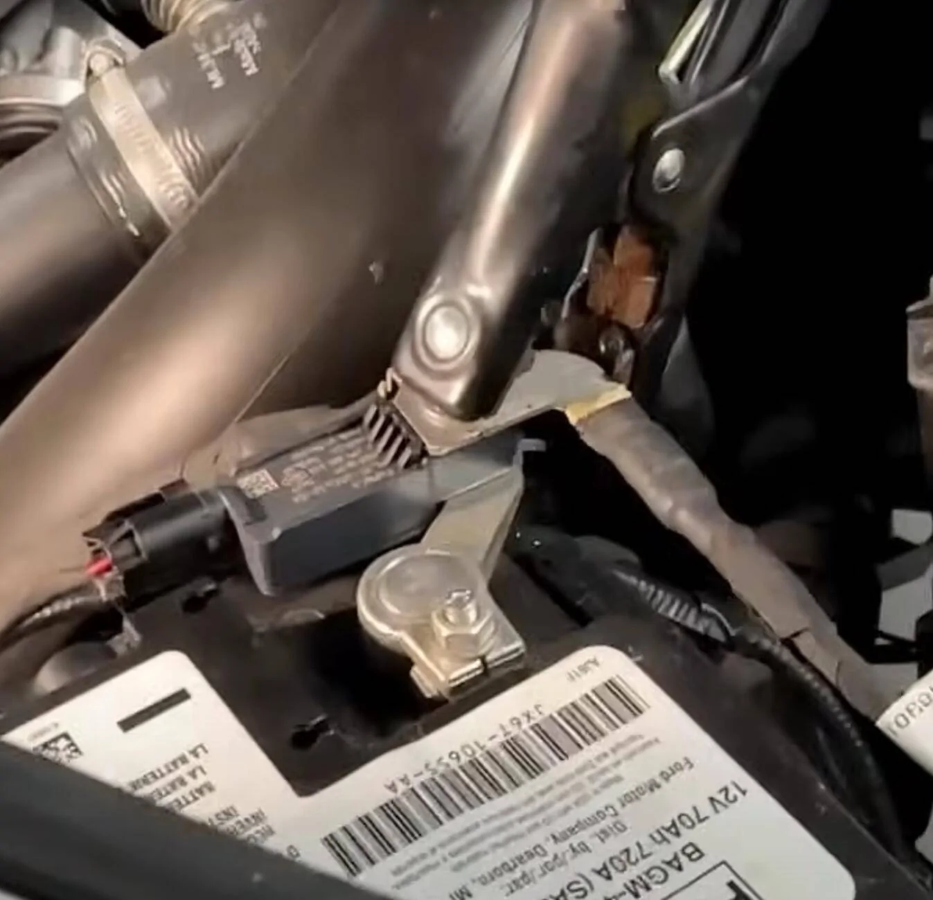

'a body or engine ground should be used for the Neg(-) battery charger clamp so that the BMS is in the circuit and can keep track of the SOC.'

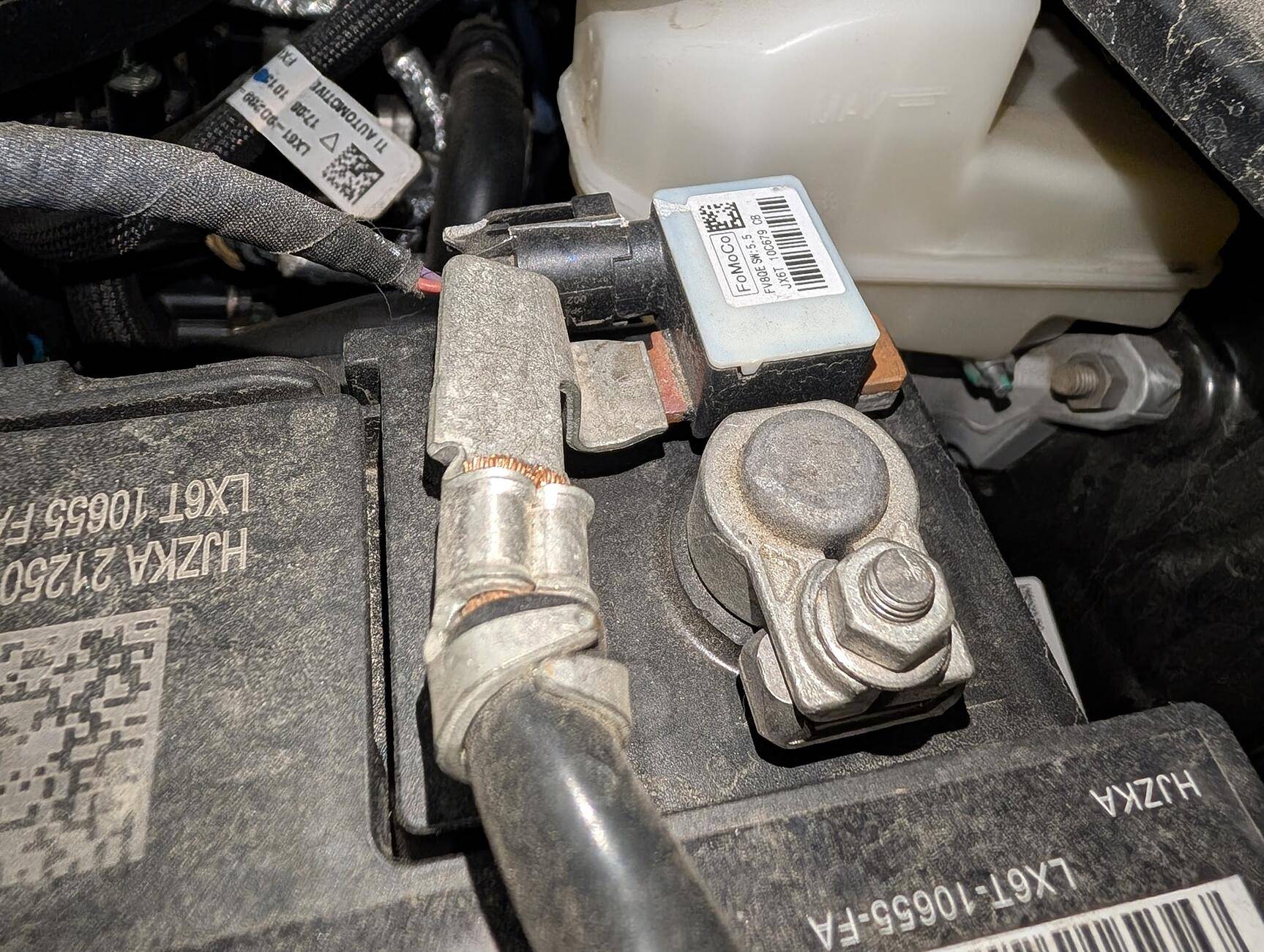

I think you are misunderstanding what he's saying in the video. He's describing two different methods for two different types of sensors. The older style sensors are inline with the ground return cable. The newer style sensors are attached the battery's negative post. Look very carefully at the way he has the cable connected (photo below) and you'll see it's not connected directly to the battery's negative post. It's connected to the ground wire attached to the top of the sensor. Current from the charger will still go past the sensor before it gets to the battery.
Ford Bronco Sport Strange issues 1740154809735-xl
Below is a photo of the connector on my car. The large wire going out the bottom of the photo goes to the body ground post on the fender. You can clearly see that it's connected to a tab on the side of the BMS sensor. If you clamped your charger's negative lead to the end of that wire where it connects to tab--which is essentially the same way as he does in the video--then all current going to the battery will go past the sensor.
That's what the presenter in the video is saying. You don't necessarily have to find a body ground point or connect to the engine block when recharging if you have a newer style sensor. You just have to be careful that you don't connect directly to the battery terminal to ensure charging current goes past the sensor.
