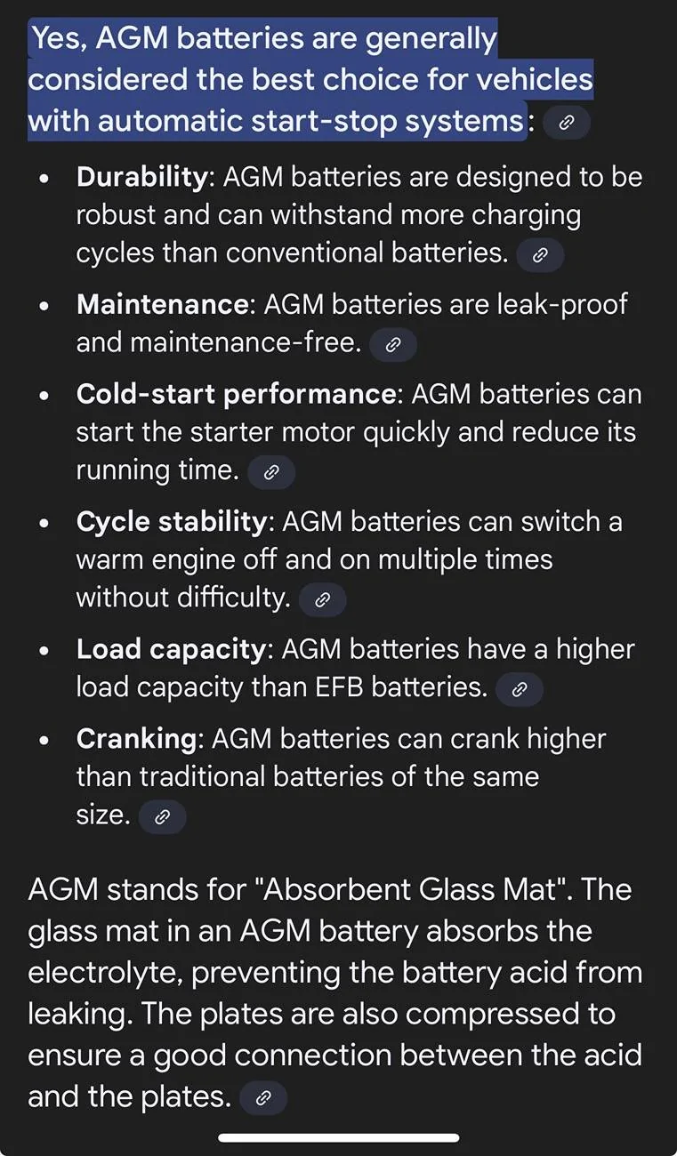

Ford used EFB-type or an AGM Battery in Bronco Sports (no Conventional flood lead-acid batteries (FLA) were used).
Everything I’ve read says AGM Batteries are designed to better support auto-start-stop systems ASSUMING the battery, alternator, etc. are properly sized and the battery management software is designed correctly.
Ford’s Recall 24S24 does not cover a battery replacement: “NOTE: 12v battery replacement is not reimbursable under the terms of this (24S24) program.”.
https://static.nhtsa.gov/odi/rcl/2024/RCMN-24V267-9251.pdf
According to other posts on this form, Ford switched to only use AGM Batteries for Bronco Sports but I don’t recall if that statement was confirmed or not.
Note: Post #16 above was clarified to read: “Evidence* shows batteries that are the EFB type fare the worst (this statement is specific to just EFB vs AGM Batteries) but I’m not convinced the AGM Battery type is unaffected.” because in the context of Post #16 I was referring to just EFB vs AGM Batteries.
Ford Bronco Sport Stop / Start feature rarely engages IMG_1157
