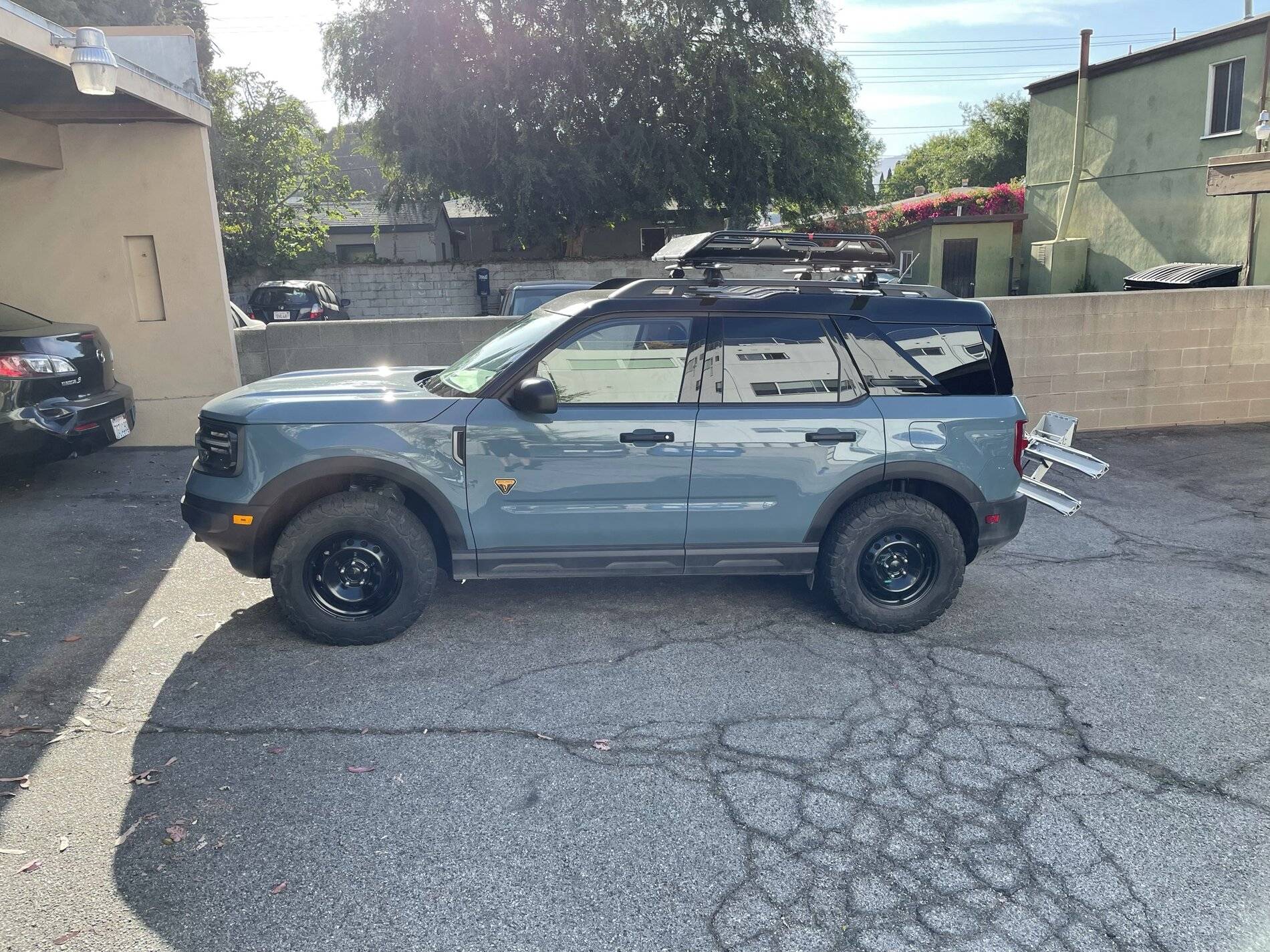

Very happy with the setup so far. We explored the Panamint valley south of Ballarat. Found the limits on clearance, had to stack rocks in one spot, but grip was great on the loose rocky bits. Didn’t take enough pictures, but here’s some wild burros.

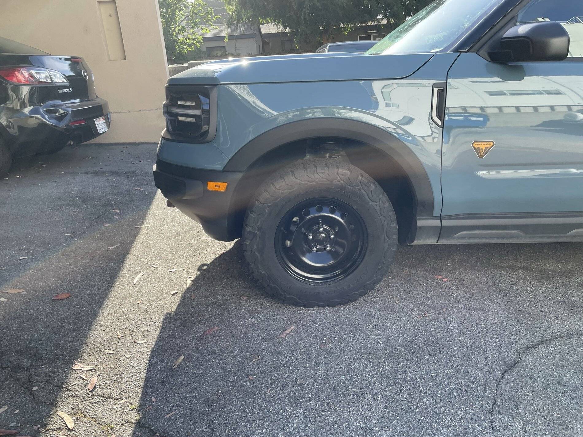

So I got 6mm wheel spacers to get the offset back to stock. I only had 6-7 threads engaged, which seems like about maximum strength of a threaded connection to me, but I got extended thread lug nuts just in case. Everyone says 9 turns on 12x1.5 minimum. I also added some vinyl caps to keep crud out of the hubs. There wasn’t anything for a regular center cap to clip to.

Nice I have seen just 2 other bs in the valley
I really like that look with those rims.
Did you put the same for your spare?
And did it fit inside?
I’m another valley sport. Have only seen a couple near me.
I need to get rid of my factory spare. I’m pretty sure I test fit these in these in the spare well, but maybe I should double check

Where did you get the wheel spacers?

Oh, I guess they were 5mm from Amazon.
https://a.co/d/2Bb2fND
Wheels are bolt centric, so probably could have used cheaper universal ones. Any 5x108 spacer with >63.4mm bore would work.
