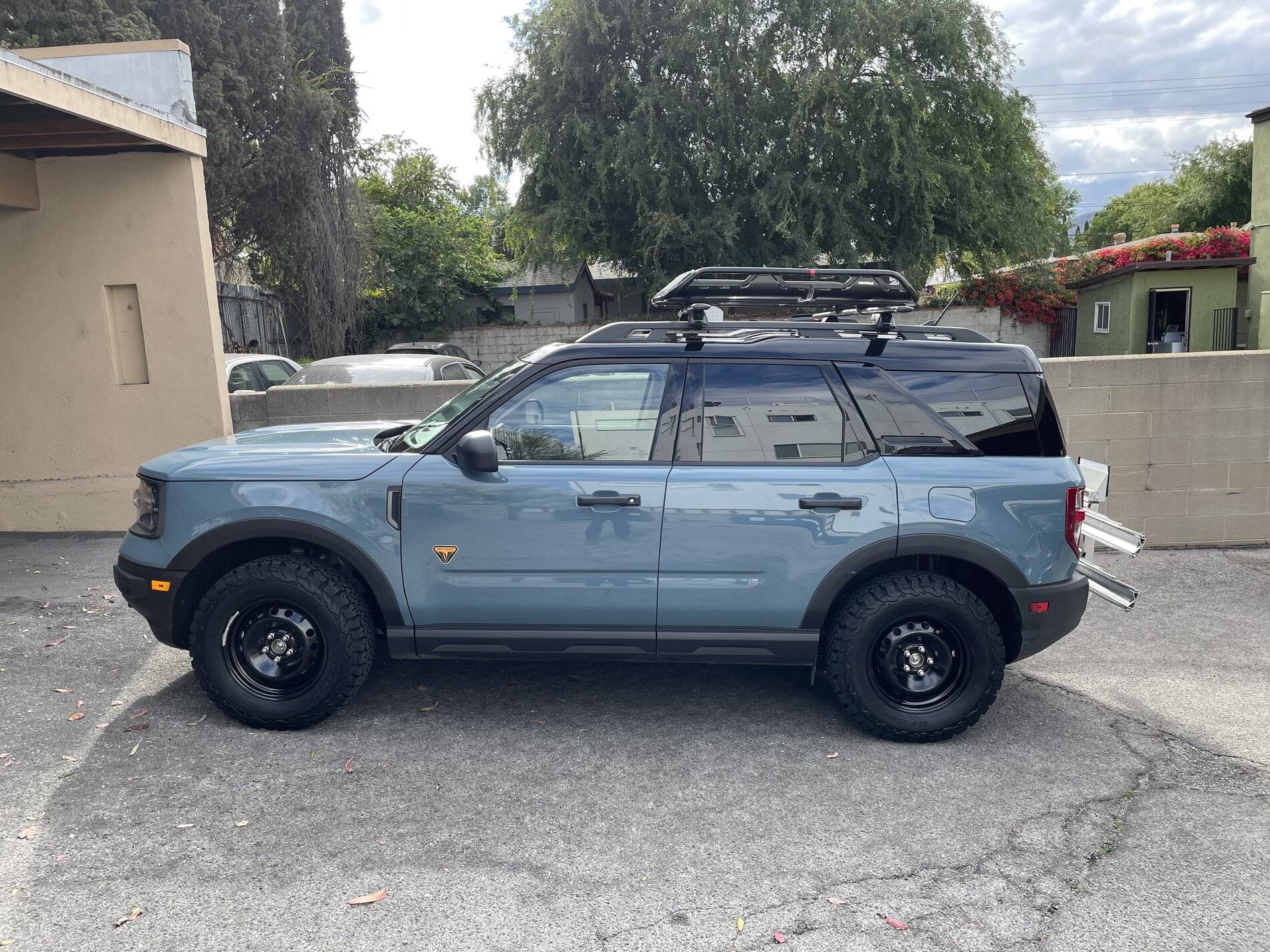

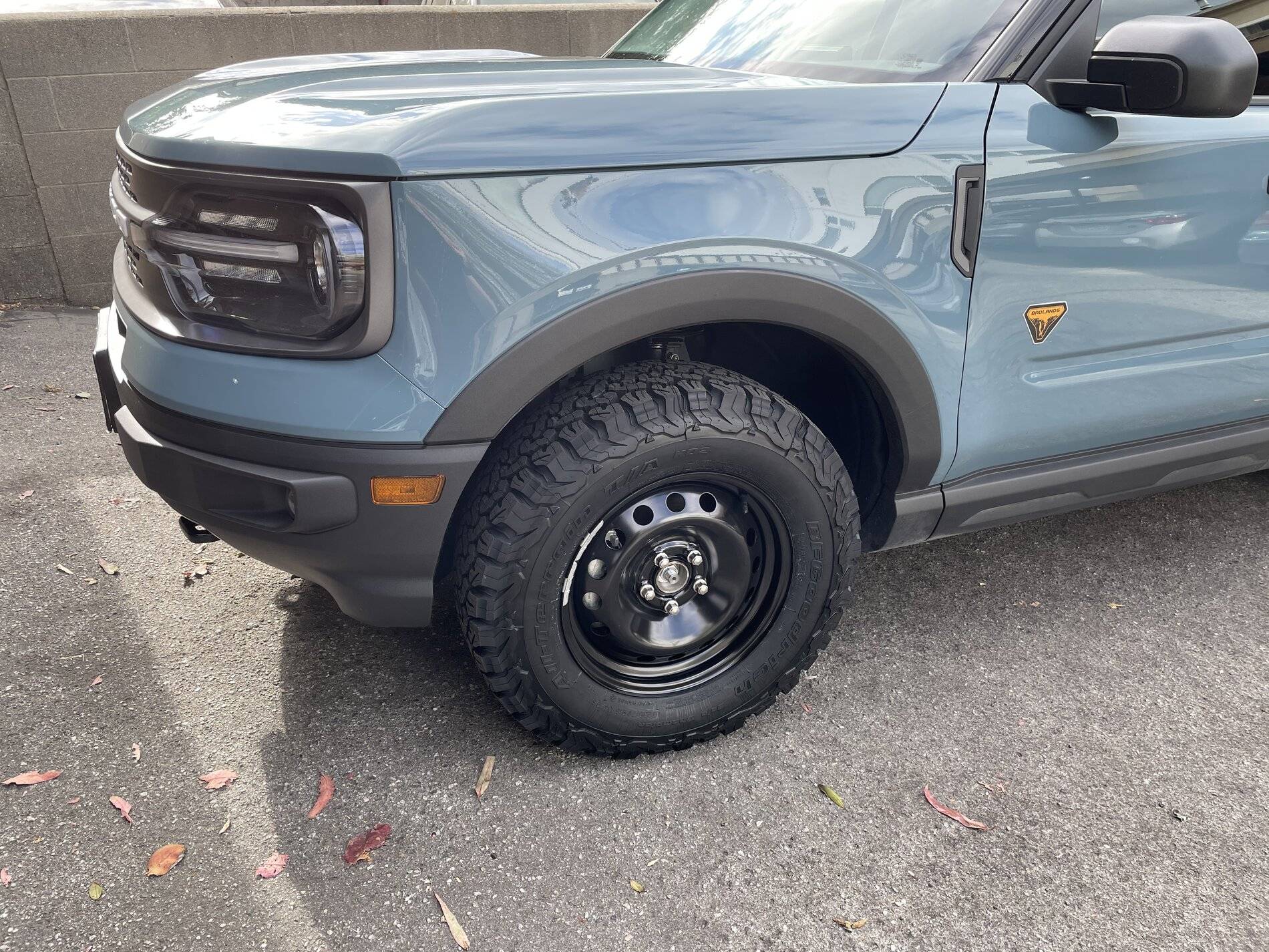

Best match I’ve found in steel are these
https://beta.discounttire.com/buy-wheels/liquid-metal-atom.
They have 6mm(~1/4”) more offset, should be fine with or without a spacer. Need to double check, but there should be extra thread exposed on the studs with the steel rim.
I spent a while mulling over the pros and cons of steel vs alloy. I could maybe use the heat dissipation and lower unsprung weight of alloy more than the ability to tune up a dented rim with a sledgehammer. There are also closer offset matches in alloy, but I do like the plainness of the steel, and they’re way cheap.
I’m going to get the steel ones, if they fit, when my work schedule lightens up in a couple weeks.

I don’t know if it will make any difference, but a taller profile tire should flex and grip more when aired down. It’s also half an inch father before your rim bottoms out on an impact. Going to 16” steel also kept the weight the same as 17” alloy.

Same outer dimensions as the 245 65 r16 tires people have been mounting. Read some mixed things about whether they rub at full articulation. Might also be pushing it on the width of these particular rims, which are 6.5”.
Edit: Looks like BFG in that size are good for 6.5” rim, maybe not an issue.
