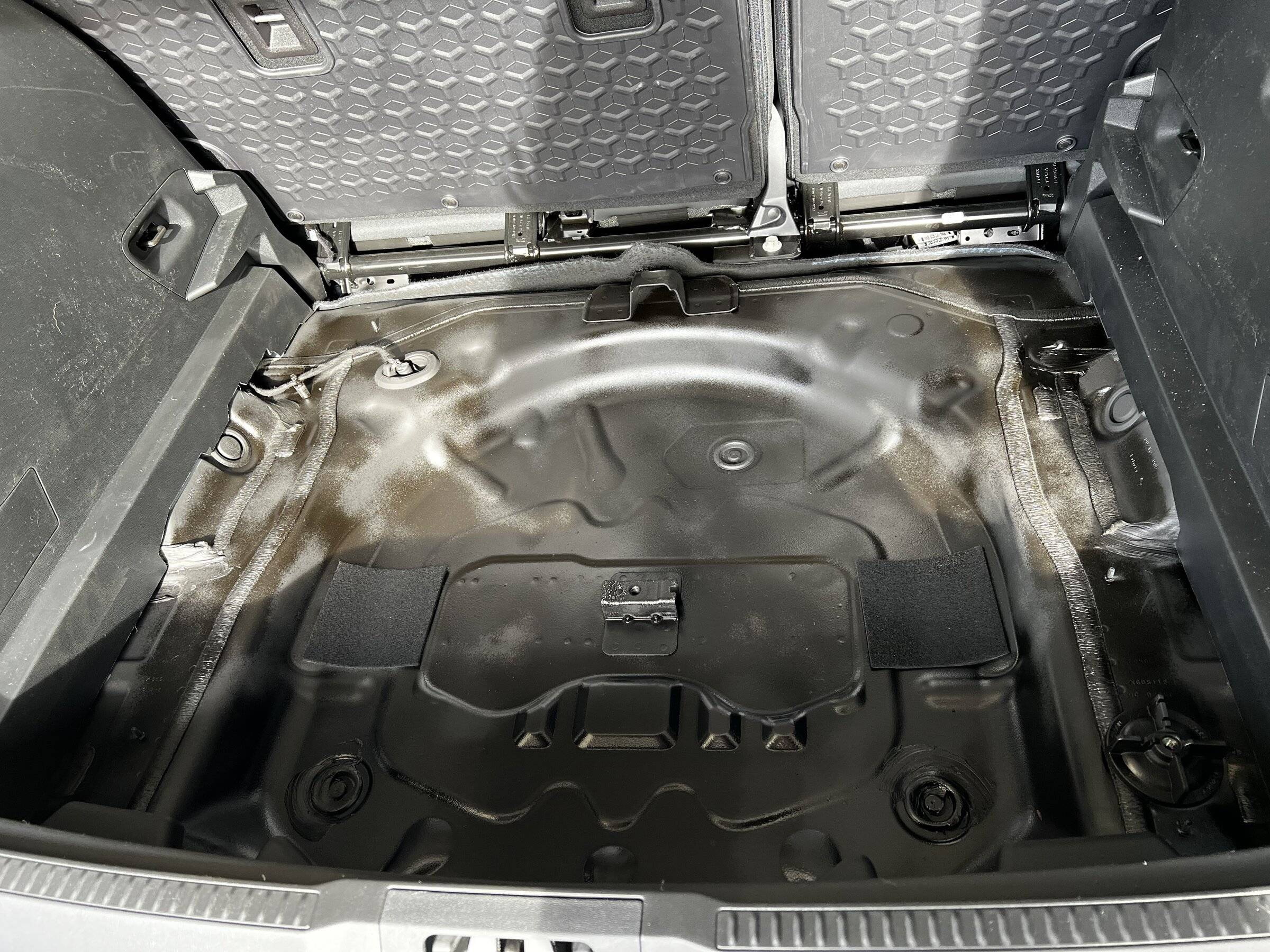

I removed the foam— it was just a couple clips on each side that pulled up pretty easily, no stray bolts. I painted the well with Rustoleum undercoating just to ease any rattles and well, make it look more intentional (I’m Area 51).
Ford Bronco Sport Spare Tire Foam Tray uses. 4EF076AE-07B0-4CA7-9D7D-DBAB640F3663

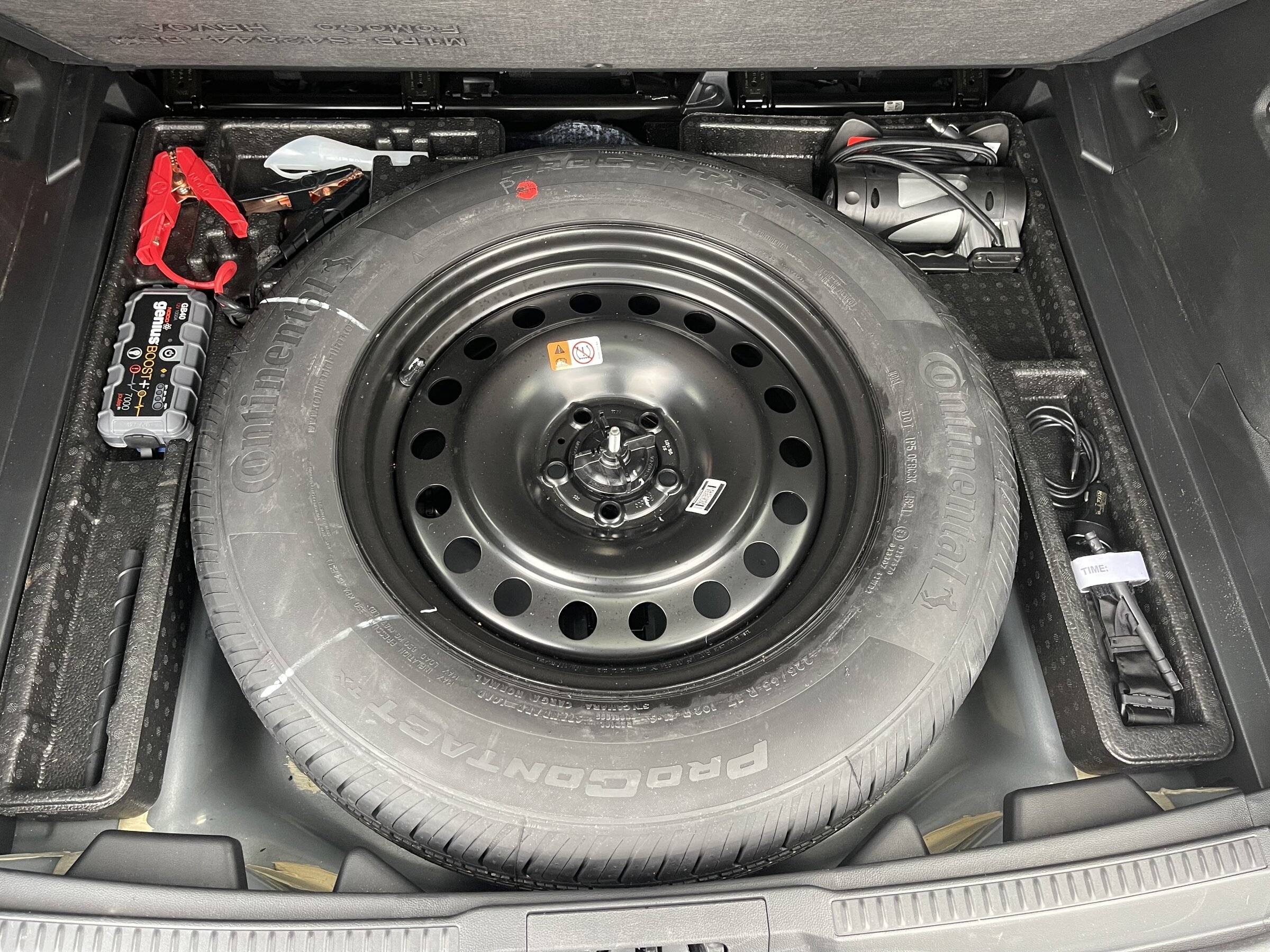

Had to go out and do some work on mine. I needed my jumper pack last night for my mother in law but had taken it out for other stuff. That won’t happen again!
Ford Bronco Sport Spare Tire Foam Tray uses. 6AE4F7DA-A180-4C3F-84D8-E77E71E5833F

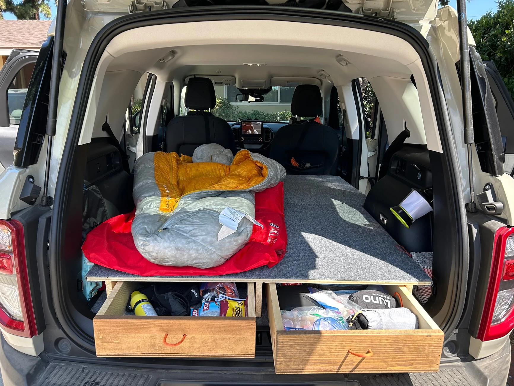

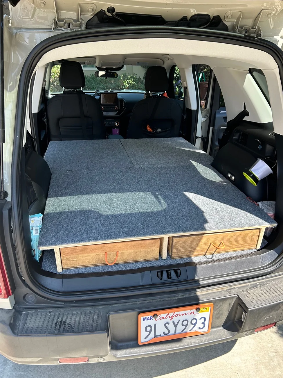

Did anyone who removed the foam take a picture? Thinking about building a drawer or sliding load floor over the spare tire area. Wondering if there’s anything good below the foam to attach to, or if I’d have to put holes through the side plastics/use the tie down points.
Ford Bronco Sport Spare Tire Foam Tray uses. IMG_9429
Ford Bronco Sport Spare Tire Foam Tray uses. IMG_9428

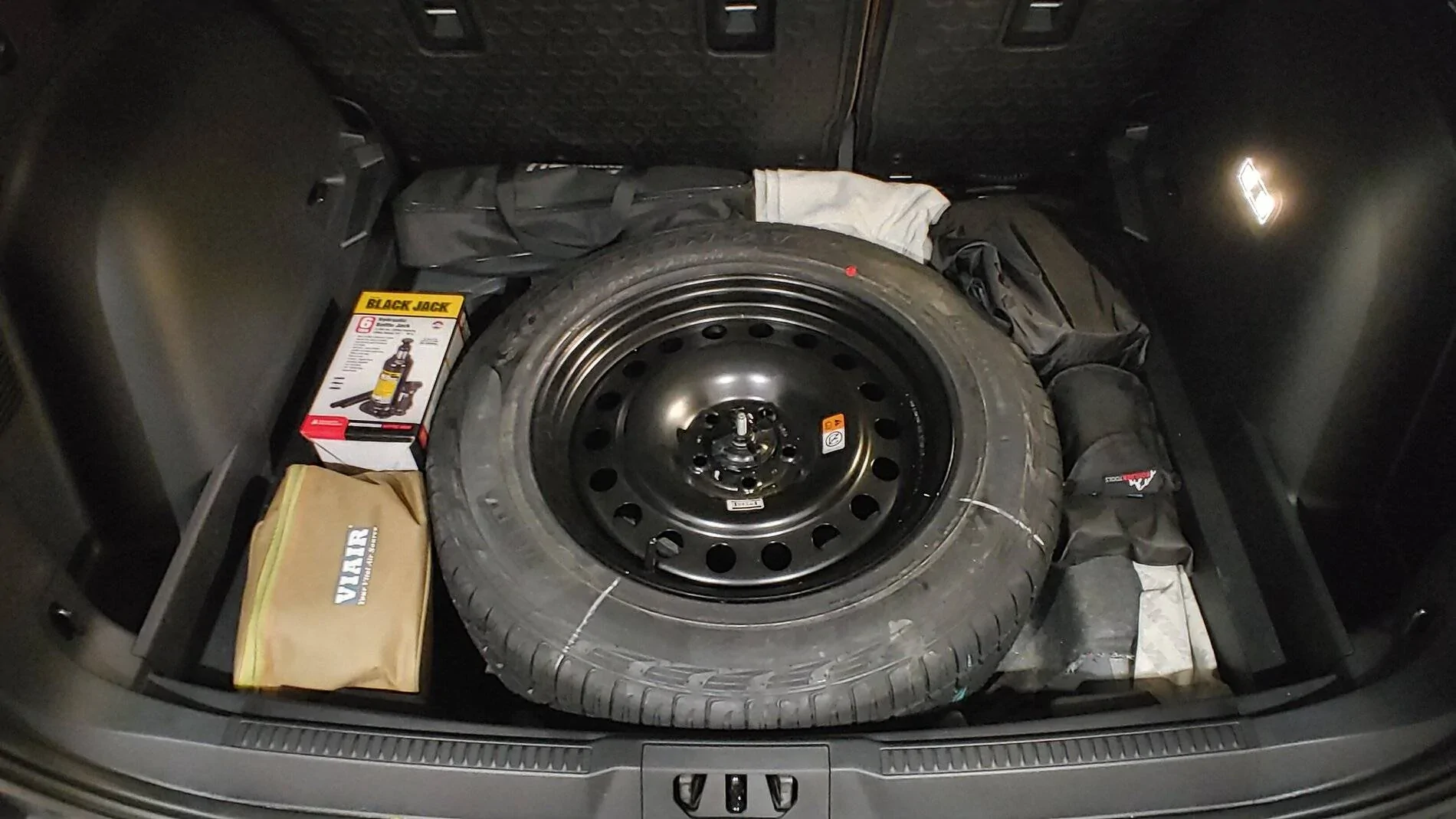

Great thread. Mine is a badlands trim with tow package so the cargo floor sits in the higher of the two positions, which helps. I was able to remove only the driver side foam and get a lot of usable storage for my overlanding/recovery gear. As of now, I have the following under there:
Viair 88P portable air compressor
30 ft kinetic recover rope
30 ft tow strap
Soft shackles
Folding shovel
Air down kit
Stakes for Yakima awning
6 ton bottle jack
Ford Bronco Sport Spare Tire Foam Tray uses. 0608210459b_HDR
