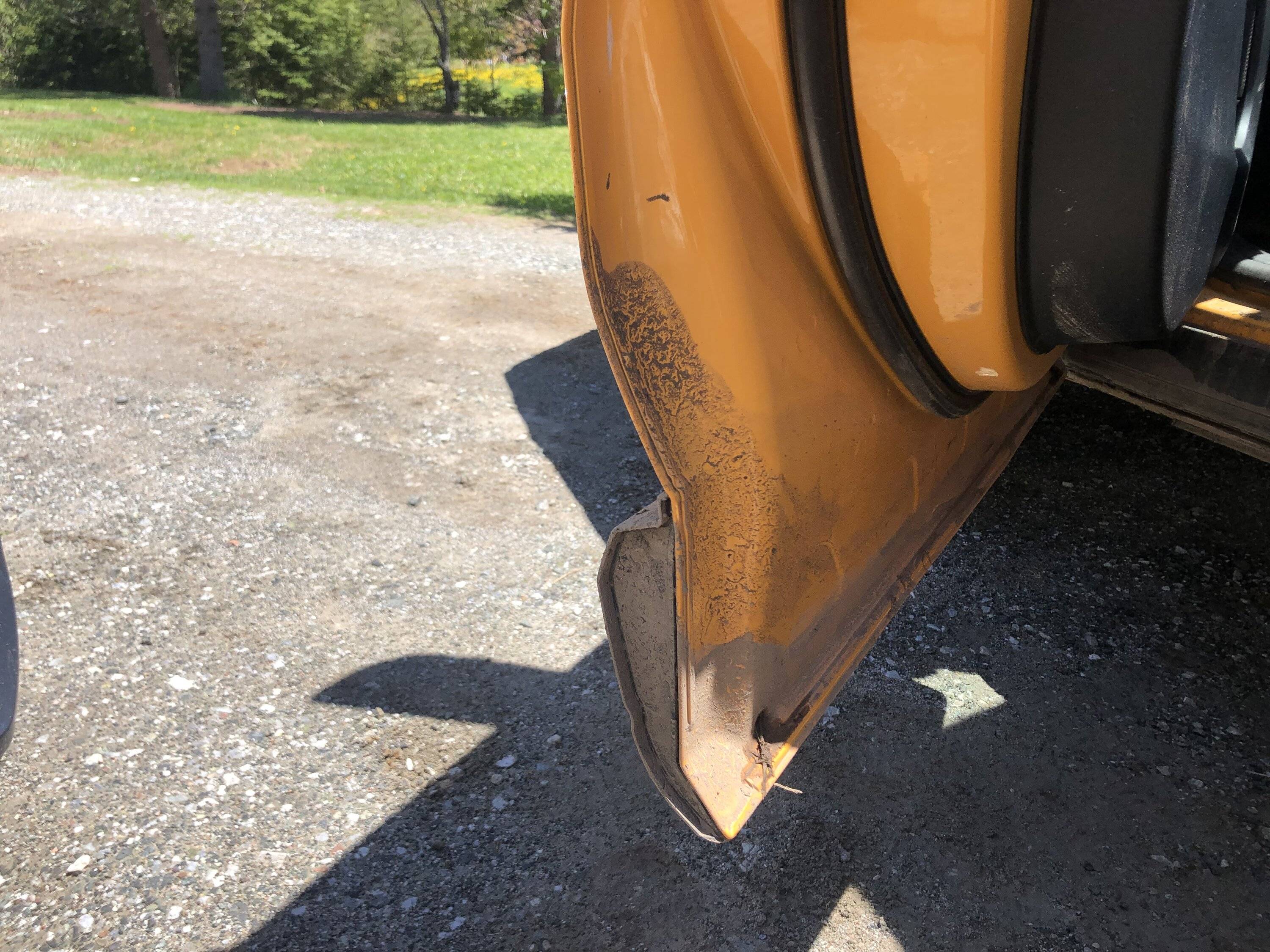

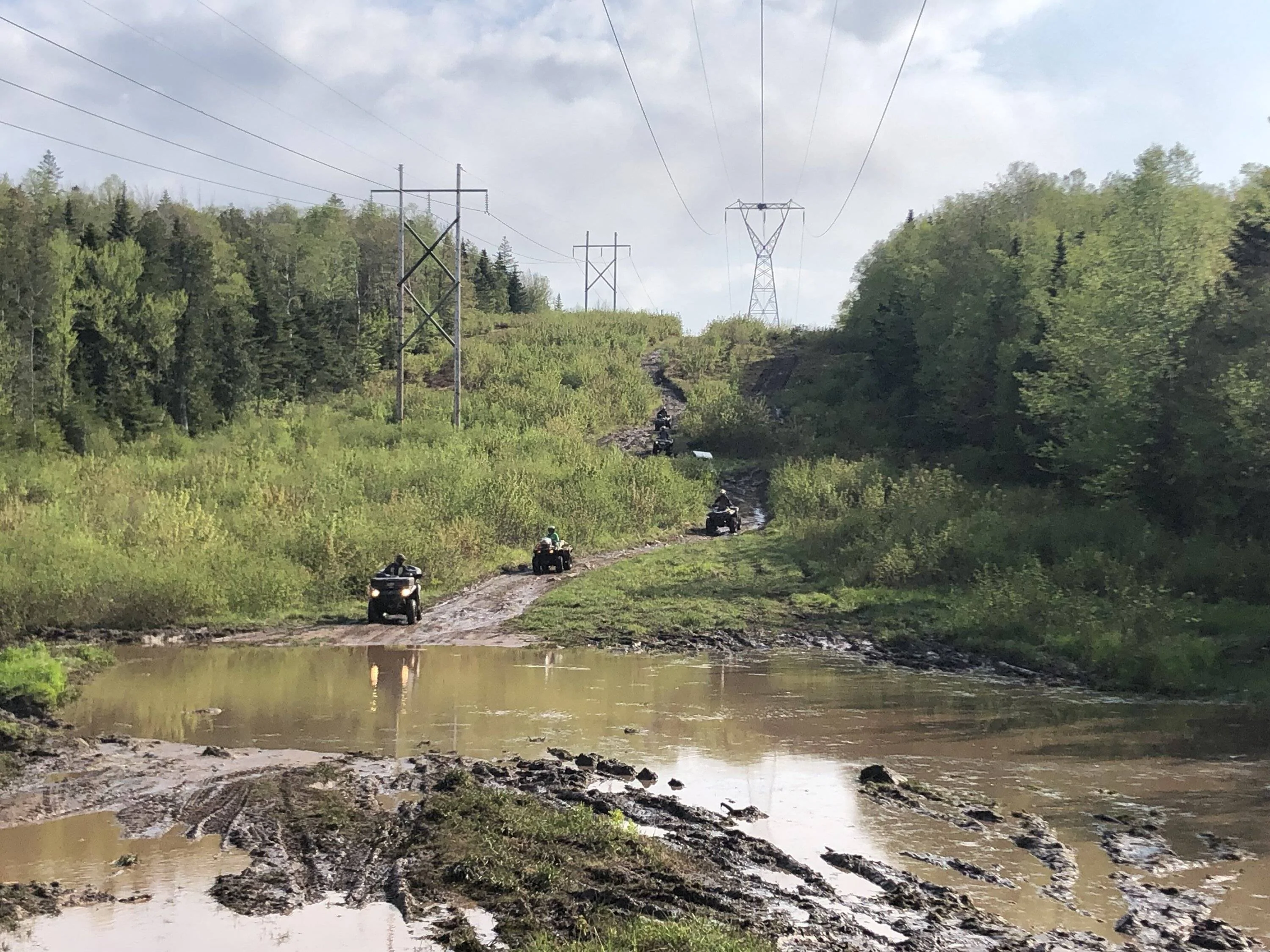

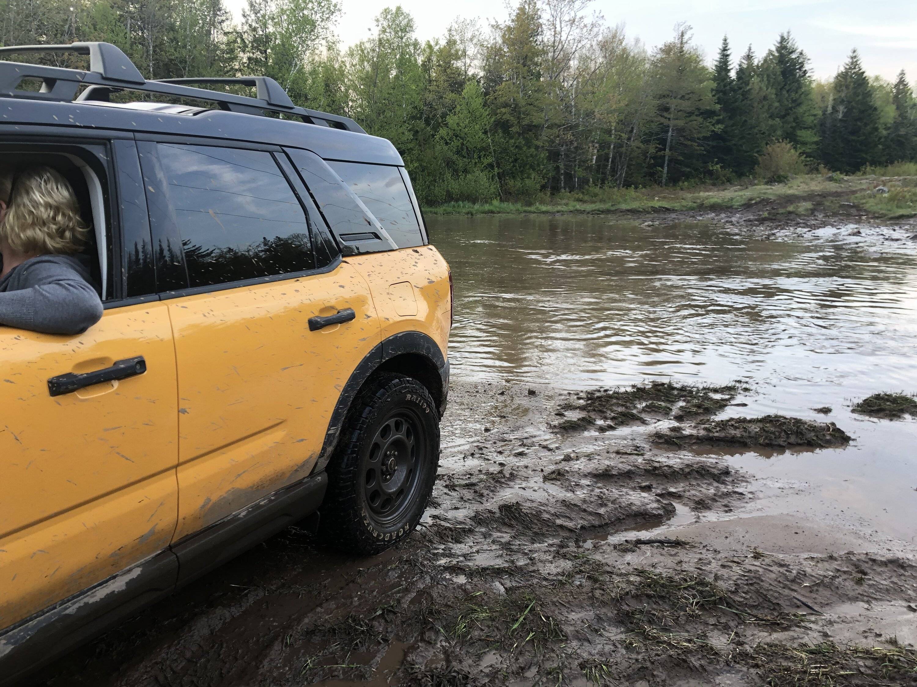

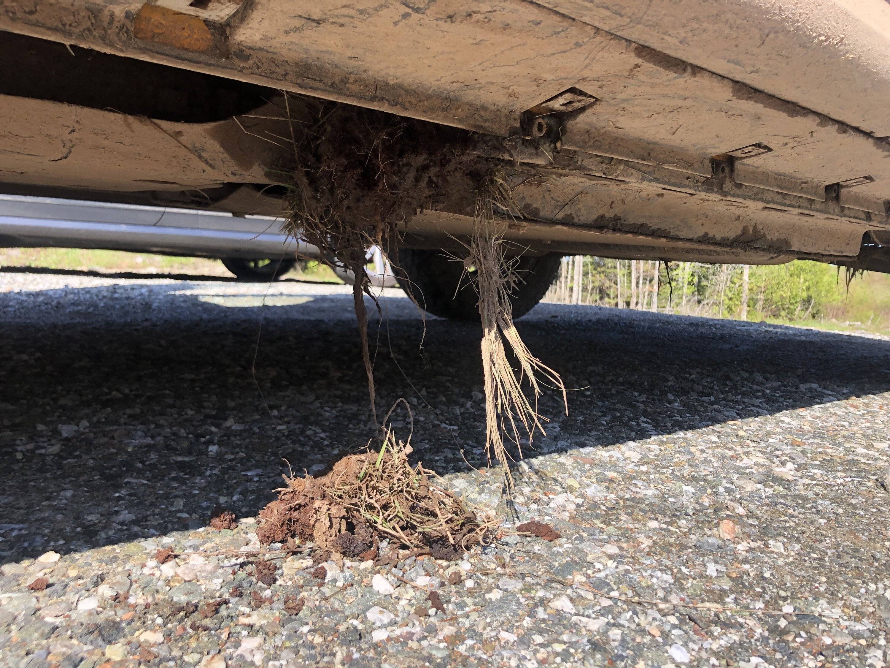

Well, I was the only one not on 35’s or bigger and only one of a couple of newer vehicles. One guy had a stock Toyota 1/4 ton with 31’s and turned around??
Don’t notice the difference too much on the rocky stuff, just have to go slow and pick your way. The mud and water? It’s either go through or turn around. (We never turned around)
Drove 5hrs there, two days of mud running and then drove it 5hrs home.(after a pressure wash before we left)
