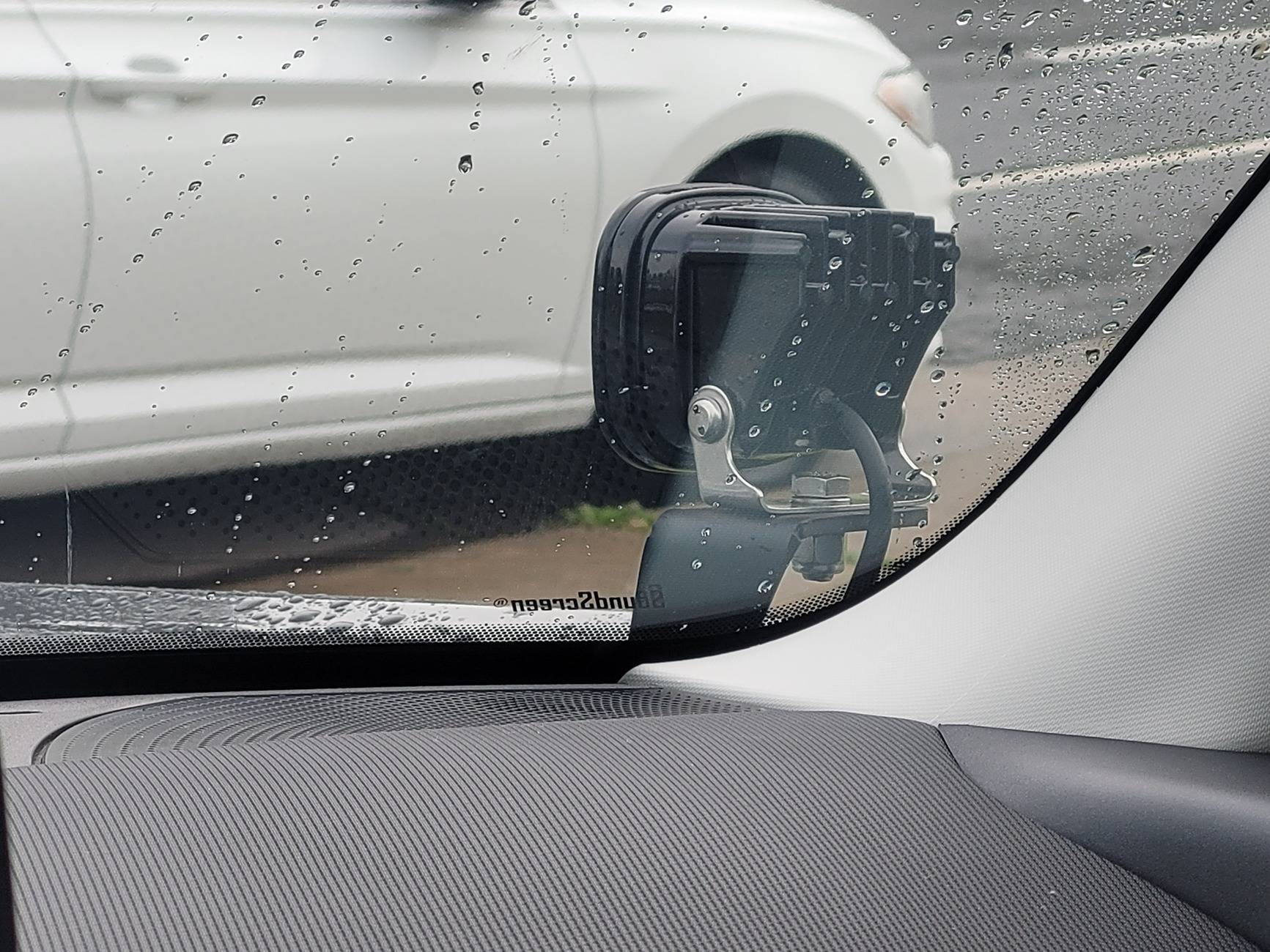

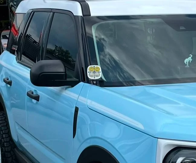

Here are my fordrangerlifts brackets. They get the light pod out of the drivers view and the light doesn’t shine on the hood. Definitely no flex or shaking. They are solid.
Ford Bronco Sport Seeking A-Pillar Light Help IMG_0341
Love the color! I owned a 1966 Galaxie 7-Litre in Arcadian Blue. ?

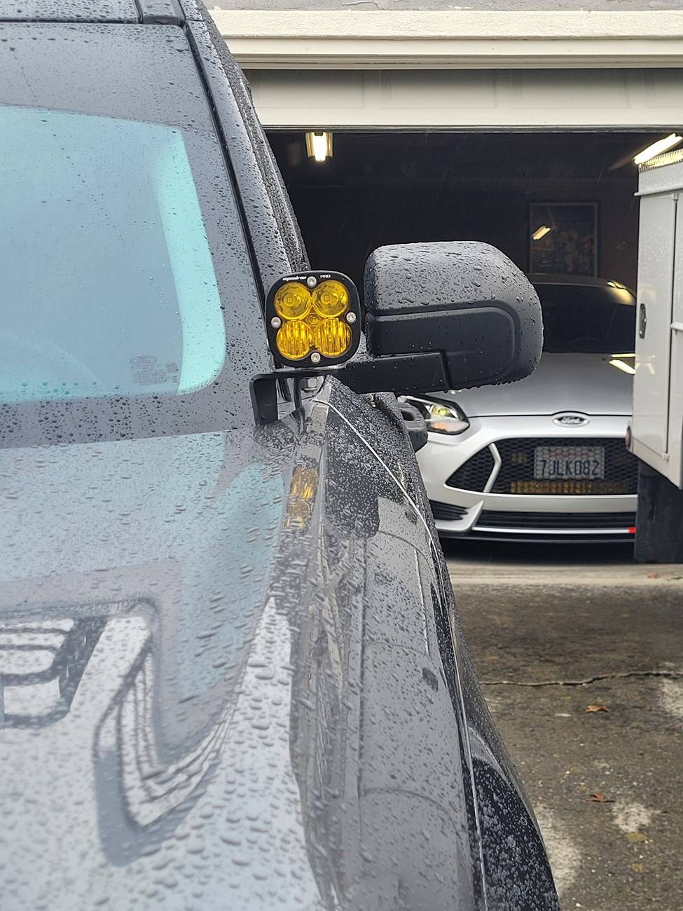

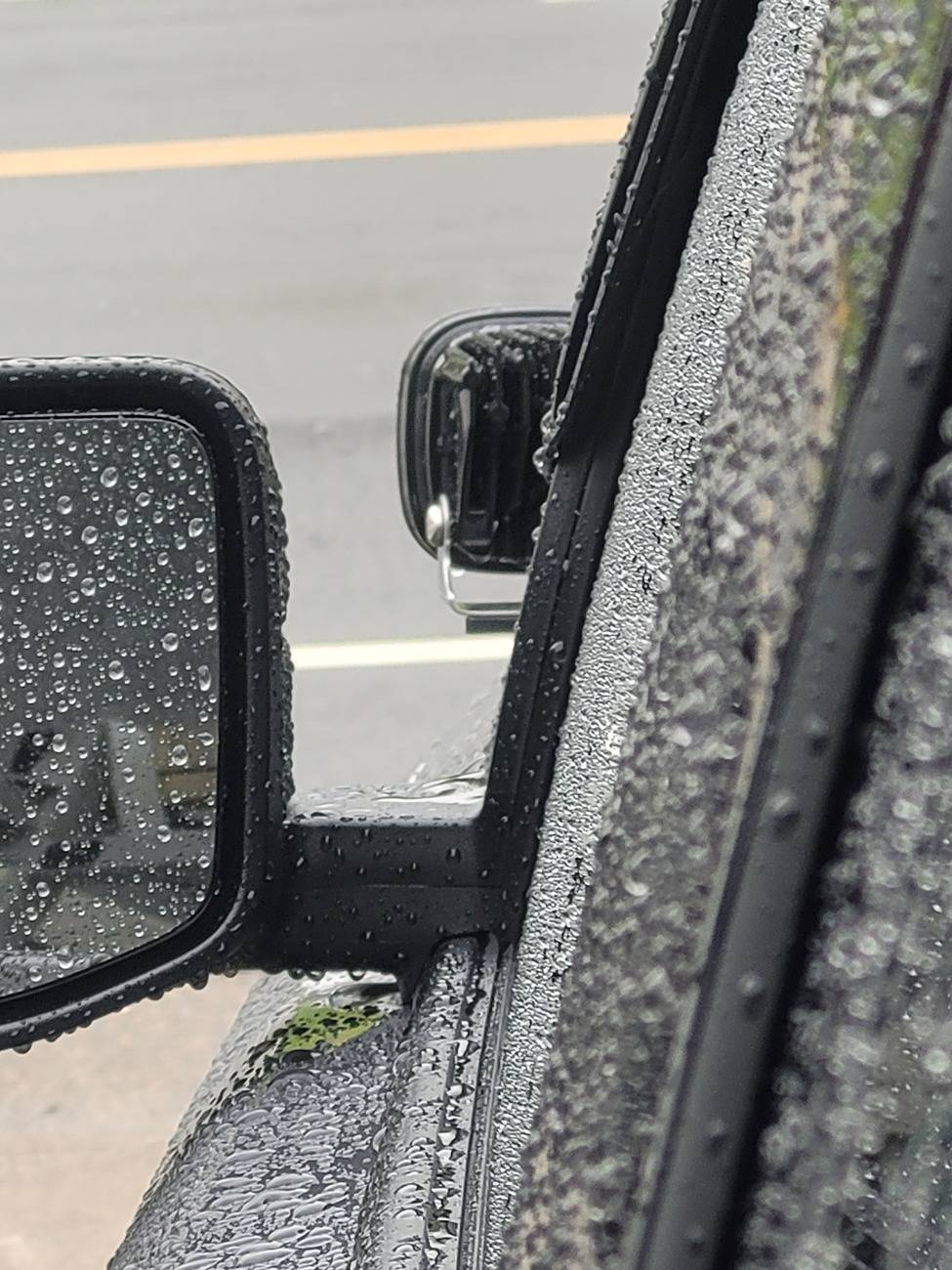

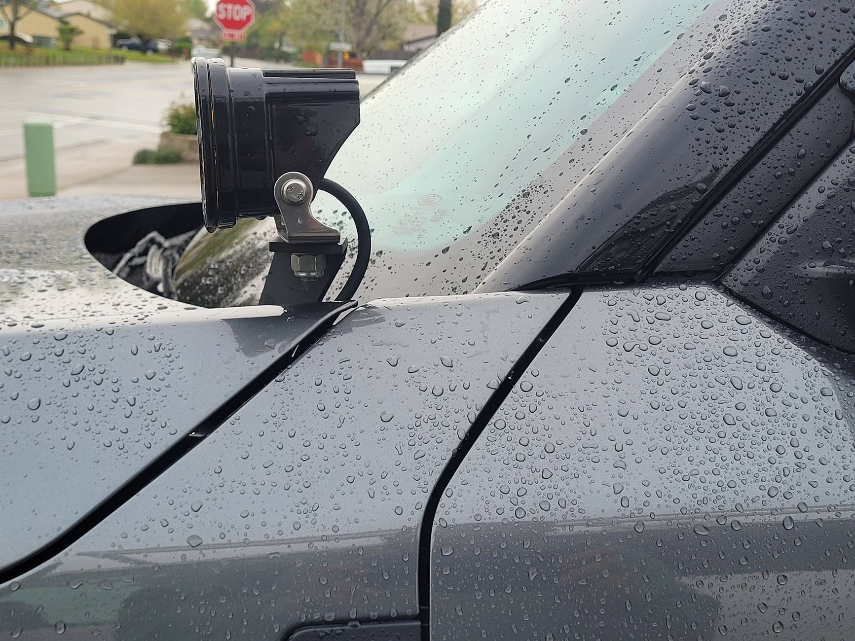

Played in the rain a little bit. Swapped brackets from baja designs, to the ford ranger lifts brackets.

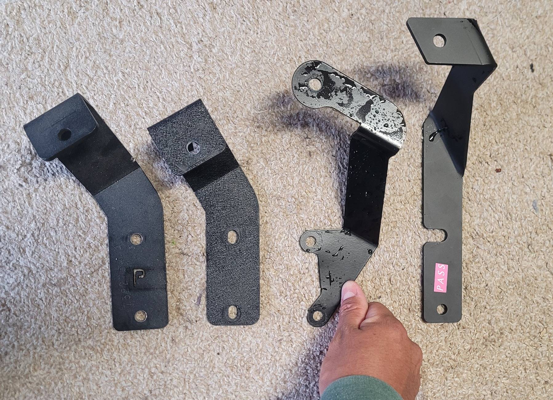

From left to right, go rhino made to fit, HRG, baja designs, ford ranger lifts

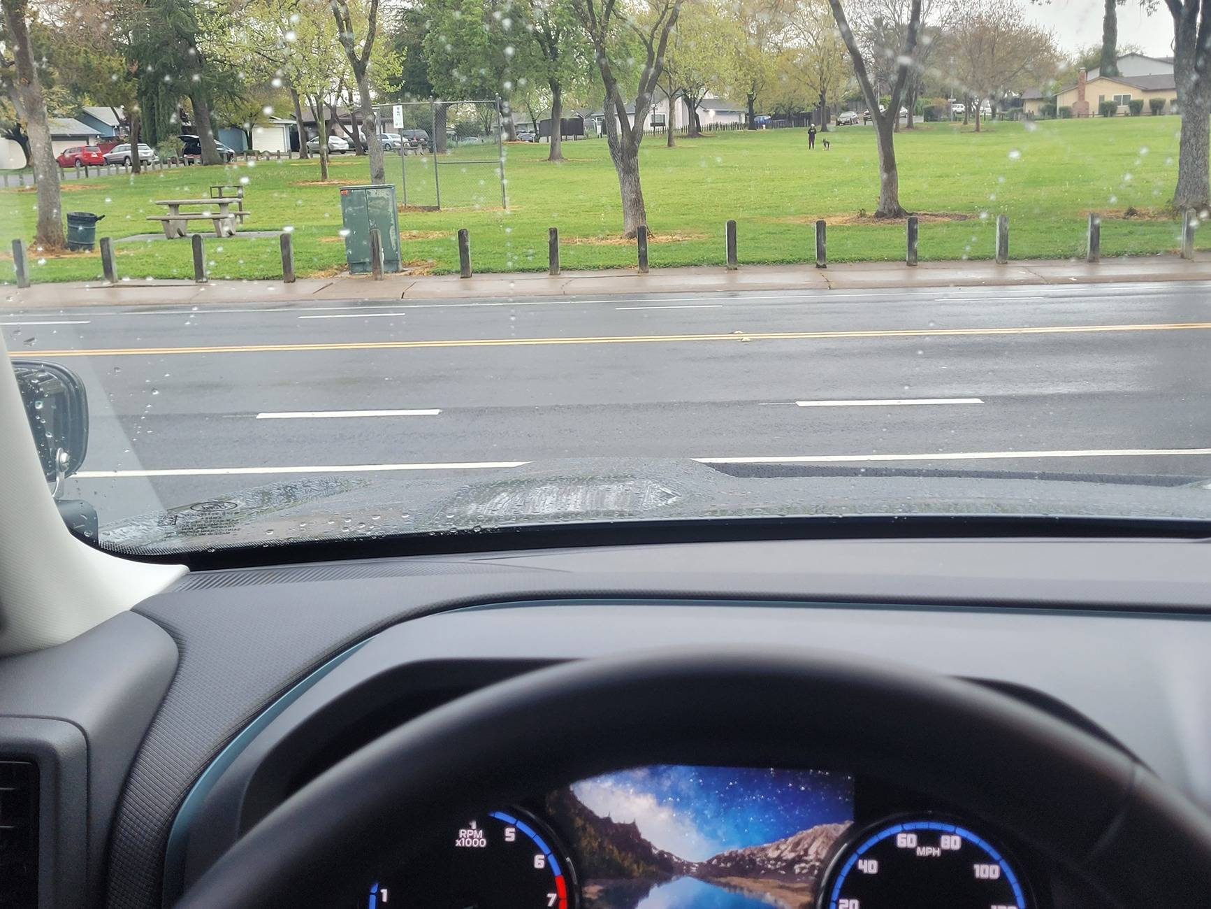

Definitely taller which is good for light projection, not as sleek as BD, but out of drivers view a little farther. Shouldn't shake. Thickness is same as HRG.
If I can make a set of brackets identical to the ones from baja but thicker material they would be perfect for me. These are nice but more obviously present being taller and more outward. They don't look bad, just different. Just takes some getting used to change.

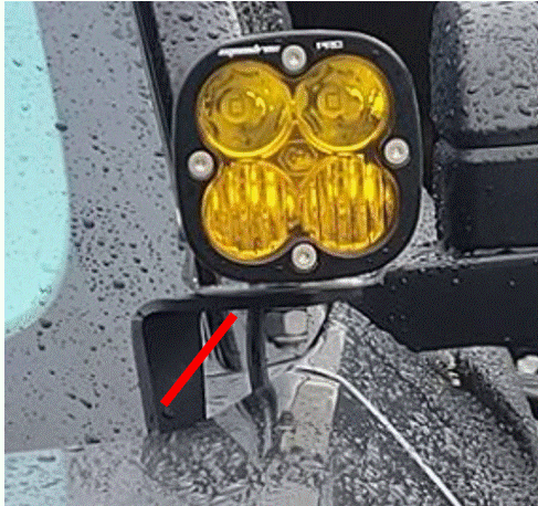

I like that design about the best. Perhaps a small gusset in the corner
