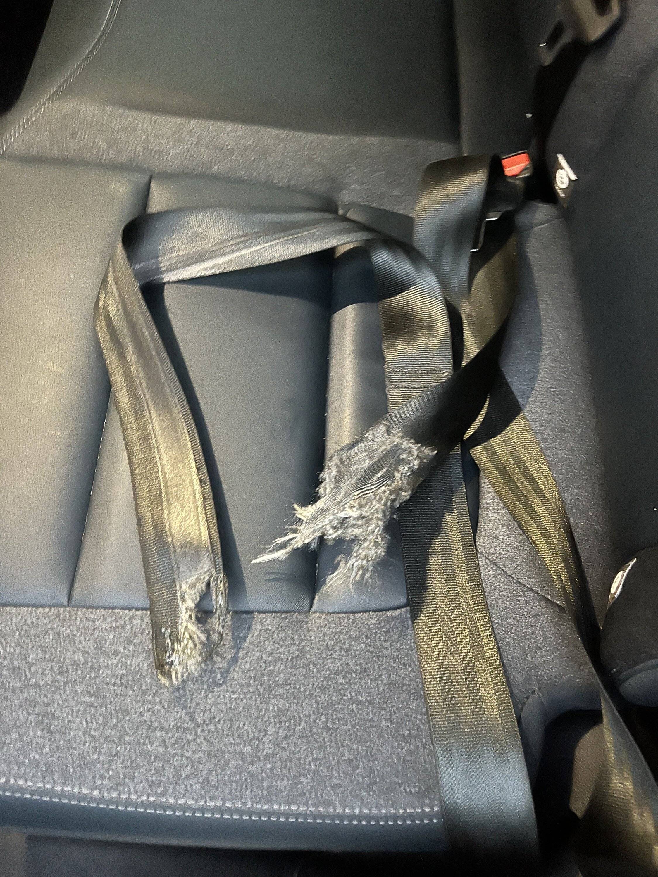

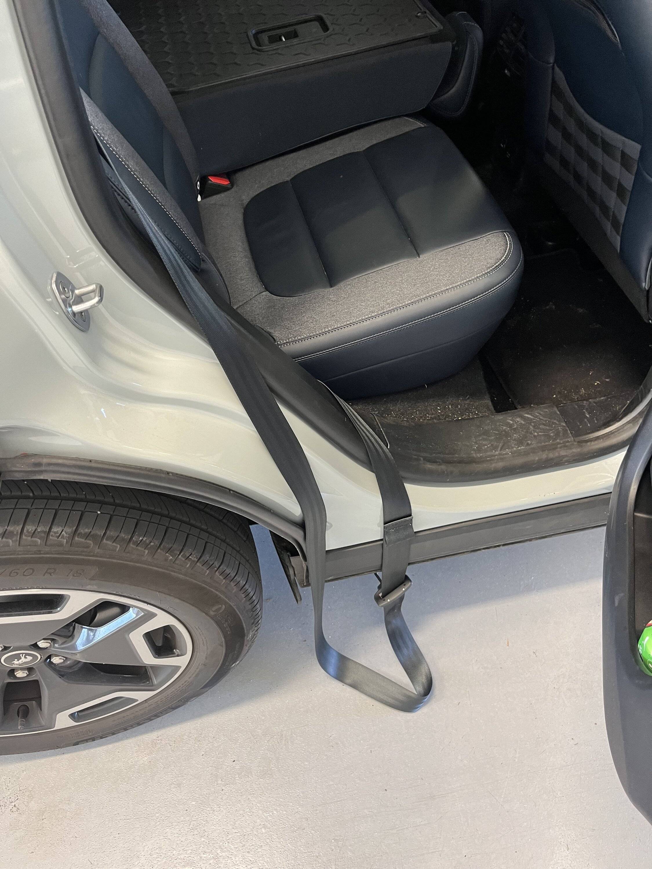

The Ford Bronco Sport has a manufacturing defect – – a design flaw – that causes the rear passenger seatbelt to get stuck between the car seat and the frame of the car. As a result, when passengers get out of the backseat, if the retraction device gets stuck, the seatbelt will dangle outside of the closed car door.
Our rear passenger seatbelt was broken as a result of this and we have been waiting 14 days for the dealership to address the problem despite the car only having 8000 miles on it and being fully covered under bumper-to-bumper warranty.

It looks more like you didn't move the seatbelt out of the way when you raised the seat back into position from having it folded. This causes the seatbelt to be trapped. How did it tear like that? Shutting it in the door will not tear a belt in half.
I also don't see this being a warranty claim.

The seatbelt gets stuck between the seat and car frame. It has nothing to do with seat being flat and then put back into position. This prevents the belt from getting retracted.

The belt was extended and the passenger didn’t notice when they shut the door that it was extended and dangling out of the door. The driver did not notice either and proceeded to drive away, snapping the belt when it went under the tire.
If the belt wasn’t prone to getting stuck between frame and seat, then it would retract and this wouldn’t be an issue. It’s a bad design unfortunately.

Not to say I haven't seen other vehicles driving around with a seatbelt thats been shut in the door. I would think in most situations the person exiting the vehicle would notice and simply reopen the door and put the seatbelt back inside or tell the driver there is a problem that needs attention.
this was an elderly passenger that got out of the car and did not notice they left the seatbelt dangling out of the side of the car when they close the door… It is an extraordinary design flaw. I have over a dozen cars and I’ve never had this kind of issue before. Passengers when they get out of the car, expect the seatbelt retractor to work.
Passengers and drivers should not have to double check every time they get out of the car to make sure that the seatbelt is not caught between the car seat and the car frame.
Again, this is a very simple and dumb Ford design flaw — the retractor is poorly designed and in the wrong place – – just as it was in the big Bronco.

I just came back from walking my dogs, walked past a Nissan Altima and the rear passenger seatbelt was hanging outside the bottom of the closed door, lol.

I'm sorry to hear about your trouble. I just inspected the rear seatbelt & retractor, and saw how the belt can be trapped between the seatback and the plastic side panel:
1) Without moving the seatback, the belt can slip between the seatback the the panel. If this happens, it is still easy to extend the belt, so the user might not realize it. However, There is enough friction to prevent it from retracting.
2) If the seatback is in the folded forward position, when it is restored to the upright/normal position, it is very common for the belt to get pinched, and perhaps prevent the seatback latch from working.
#2 should be noticeable to the person who repositioned the seatback.
#1 is different. That can happen at any time, and may not be noticed by the user. The effect is similar to a weak retractor (typically in older cars).
You are correct that the design leaves something to be desired. OTOH, it's not clear to me how to improve it. Perhaps the seatback could be slightly narrower, so that there is a slight (~1/4") gap between it and the side wall. That would allow the belt to retract even when it slips into that gap.
Regarding getting the belt replaced, your position is that it would not have been damaged had the design been better, and I imagine Ford is saying it's your fault -- that you should have checked. To that I'd say that very few people (approaching zero) do a comprehensive exterior inspection of their vehicle before driving it. If Ford continues to insist that you should have done that -- then that 'rule' should apply to all Ford owners. In fact, it should be in the owner's manual and all buyers should be informed of that requirement by their salesperson.
I'm not suggesting that your case is a slam-dunk. Ford is not 100% at fault, but this is a situation that calls for "goodwill assistance". Ford should replace the belt at no cost. In addition to the moderate expense however, they may be concerned about setting a precedent. Also, doing the repair for free could be seen as an admission that the damage was primarily their fault.
