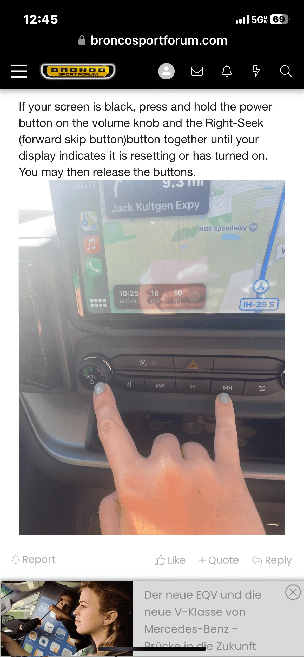

Hmmm that sucks…Another thing to try is do a hard reset.
Press the power button plus the right search track button for a few seconds and the radio should restart with the bronco logo completing its cycle.
This is a soft reset. A hard reset requires disconnecting the battery for approx 15 min. I would try a factory reset of the SYNC system.
