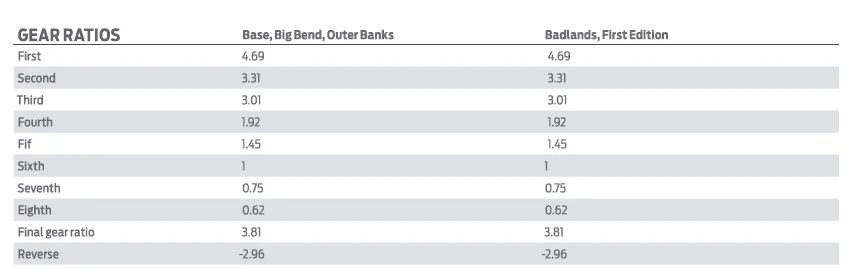

Show us all a list of the gear ratios in the 8F35 transmission , highlightjng this special "L" gear. You won't find it.
The Badlands uses the same transmission, and labels the button "M." It is "M" on the Badlands, rather than "L," because of the paddle shifters on the steering wheel allowing for manual gear changes.
RushMan
Russ
Oct 28, 2021
846
1,087
NW NJ
'24 Shadow Black Badlands
Gear Ratios from the Ford Tech Spec document sent to Dealers. Someone posted this on social media a long while back.
Note there is no "special" Low Gear and also note that the gear ratios are identical between all the trims.

Incorrect (according to the owner’s manual)The “L” indicates low range in the Sports, “Hill Assist” in the Escape, Explorer and Lincoln Nautlis
No. “L” simply forces the transmission to stay in lower gears. From the owner’s manual:
Low(L) (If Equipped)
In low (L) your vehicle holds low gears.
Press the low (L) button when your vehicle is in drive (D) to enter or exit mode.
Note: We recommend using this mode for driving on hilly or mountainous roads or when towing a trailer.
The Badlands replaces the “L” with “M” for manual mode, because the Badlands has paddle shifters to manually change the gears.
There is no low range transfer case in any Bronco Sport.
