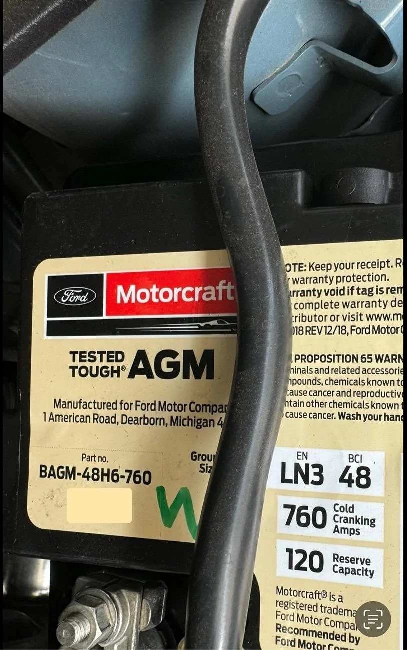

Today Ford installed a new AGM Battery under warranty.
The OE Battery had been working fine including maintaining its voltage (which is not a great test) even after 3-5 days (and more) of non-use. However, the OE Battery declined quickly in the 7 weeks following having Recall 24S24 completed. In the past week, voltage on the OE EFB Battery dropped from 12.6V to 11.8V after only 24 hours of non-use. The vehicle started up just fine but in the past week the voltage dropped to a low of 9.8V during a crank cycle which is unusual for me.
It might be just a coincidence that the OE Battery has failed to hold a charge after just 7 weeks from Recall 24S24. No way to know for sure why the battery declined quickly, could be was just its time to fail.
Recent timeline for those interested:
7/29/2024: Ford Mobile Service installed a new AGM (BAGM-48H6-760) Battery under warranty (OE Battery was the EFB). I have a ‘22 Badlands with 26,000 miles.
The OE Battery later that day failed the Load Test at the Dealership so definitely the OE battery went bad after 2.5 years of use.
Mobile Tech did not perform the Battery Sensor Reset (Battery Management System (BMS) Reset); so I performed this procedure.
Battery disconnect/replacement causes:
Fuel Economy: reset (long-term average)
TPMS: reset
ECU: reset, the ECU goes through a 150-250 mile drive cycle to relearn emissions info
TCU: reset, transmission relearn cycle
Reset the Menu > Select Screens (needed to restore the 7 screens I use)
06/05/2024: Ford Mobile Service tested the battery (not a load test): battery tested good then applied Recall 24S24 (BCM/PCM Configuration software update). Mileage: 25,287 miles

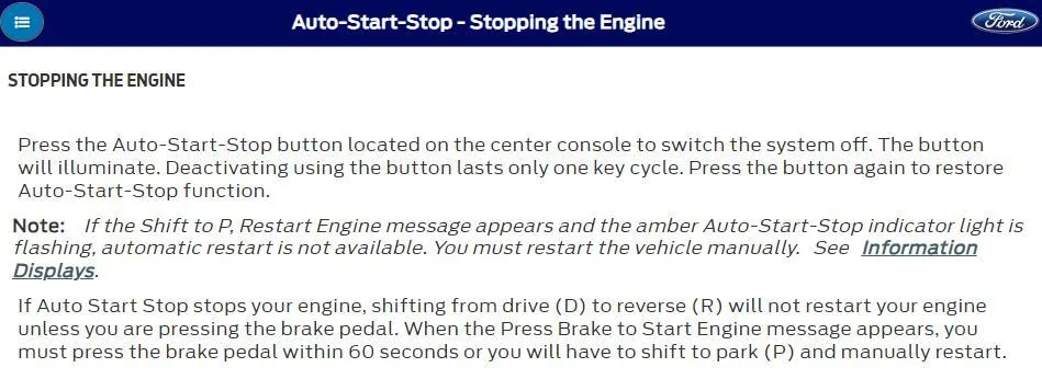

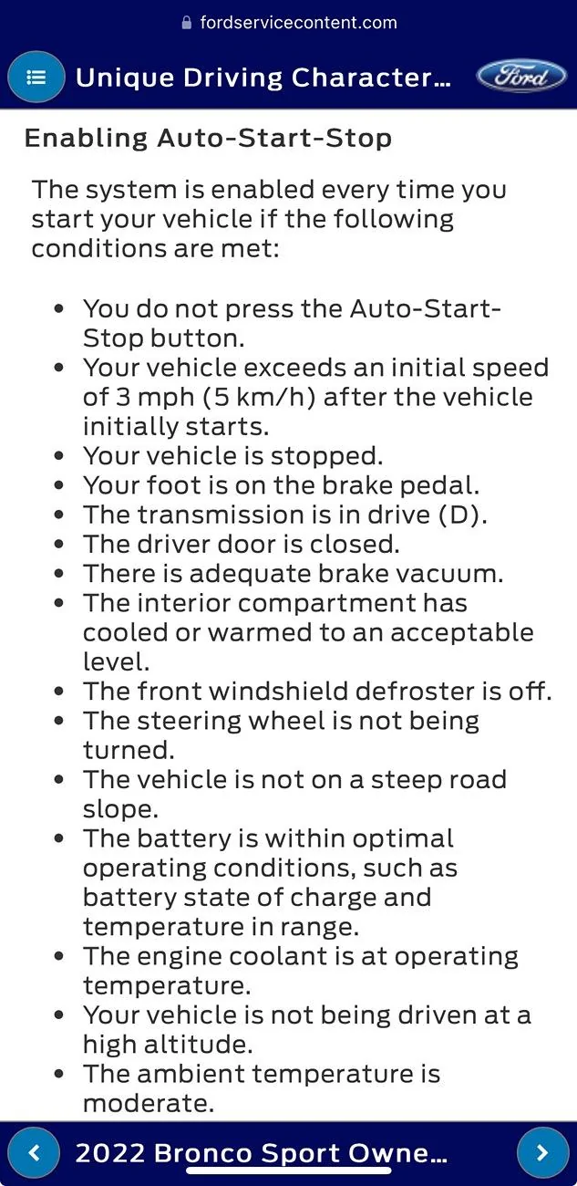

@João Leme There is a lot to unpack in your Post. I’ll provide some info but cannot provide any solution to your reported issues.
1. .. “is it normal not having the automatic restart available? in the manual it doesnt say anything about which conditions trigger this message.”
Pic 1 from the 2022 Owners Manual shows a list of conditions required for Auto-Start-Stop system to be enabled every time you start your vehicle.
2. Because you “did not have the Auto Start Stop issues prior to Recall 24S24 BCM/PCM reprograming (calibration updates) performed last May”, and because you have a pretty new battery, it sure seems likely the calibration updates do relate to Auto Start Stop not working properly.
But you have stated before your battery is good and the dealership recently “re-assembled many conecctions, cleaned and dryed a possible humidity situation” which although you haven’t had time to fully test the behavior of your vehicle you did state “prior error of engine not starting at first attempt did not occur again” so that suggests there was an issue with wiring connections which may have solved that one error.
Could you explain more of what was the source of the “possible humidity situation”? For example, at any point in the life of the vehicle is it possible the vehicle was under water say 15” (38.1 cm) or deeper? What else caused the “humidity situation”?
Ideally Ford Corporate would step in and take your vehicle to tear it apart and find the source of the Auto Start Stop issues while giving you a new vehicle but perhaps that humidity situation means the vehicle was exposed to environmental conditions that are not the fault of the vehicle?
Thank you very much for your good answer, I had not checked that image of necessary preconditions before and there may be something useful for the next steps to be followed. Regarding your question, yes, the car got stuck in a puddle of water and mud at a depth of approximately 16 inches, I commented on this in another post here on the forum, in this case since I had been at the scene for half an hour waiting for rescue there was excessive contamination in the car's lubrication system (there was no hydraulic lock), and my insurance covered the replacement of a brand new engine, along with the replacement of the turbine and parts necessary for this assembly. Everything was done at the local Ford. I imagined that during the assembly of a new engine any moisture that might have been present would have been removed but maybe not, I don't know. Maybe the battery was damaged in this episode and that is why the engine is dying in the condition I mentioned after ASS at a stop with the auto hold engaged.
and Yes it is exactually like that the Auto-Start-Stop indicator light flashing..
