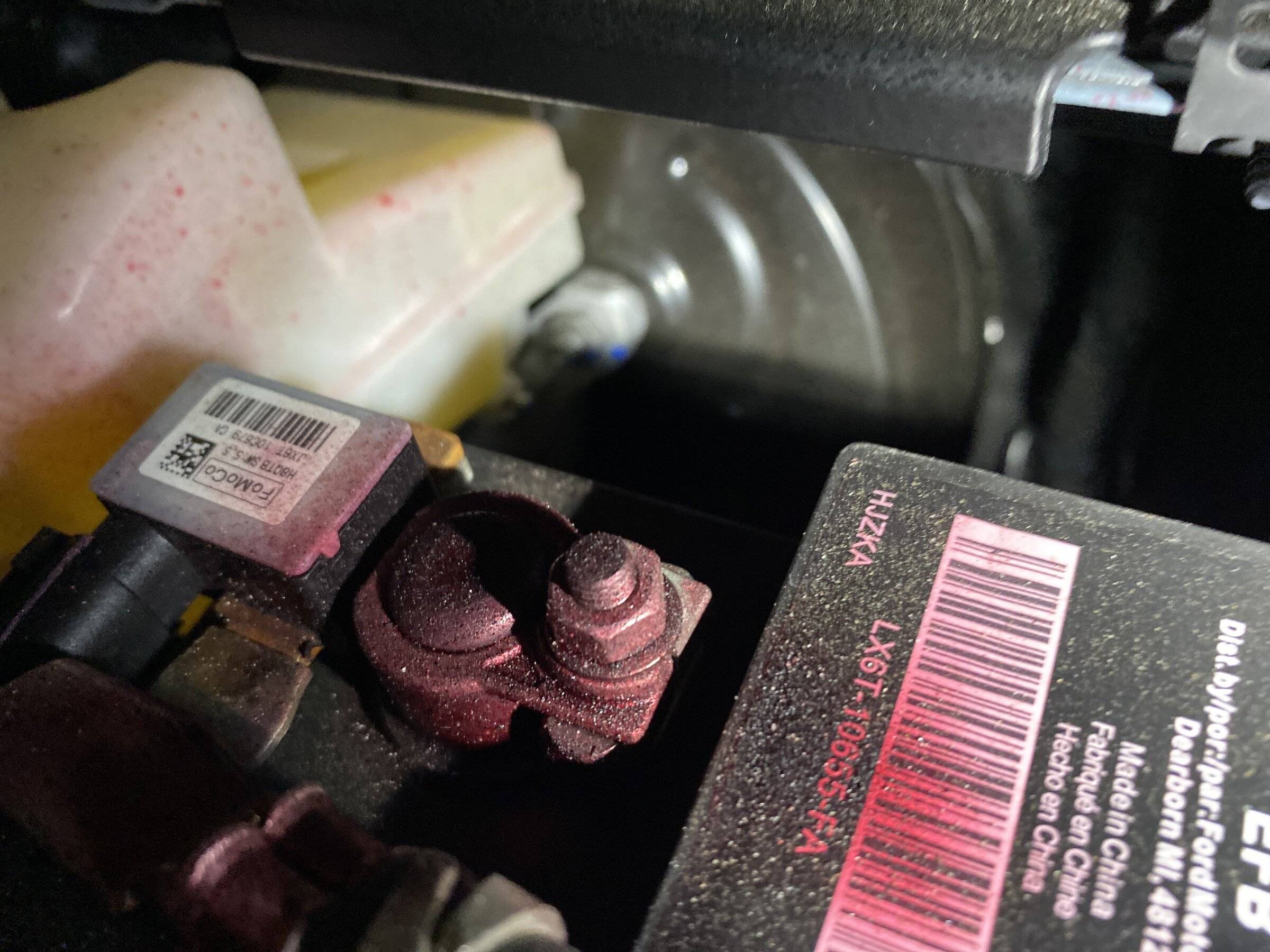

Turns out it's not easy to get a decent photo of it. It's mounted on the firewall almost directly behind the battery. The photo below is is the best I could do. It's take from the middle of the engine bay looking back and toward the driver's side.
Ford Bronco Sport Recall 21C31 20220117_090446
You can see the fluid reservoir in the upper right of the photo. The two small-diameter tubes that come down out of the reservoir and bend 90 degrees to the left run to the ABS module on the passenger side of the engine bay.

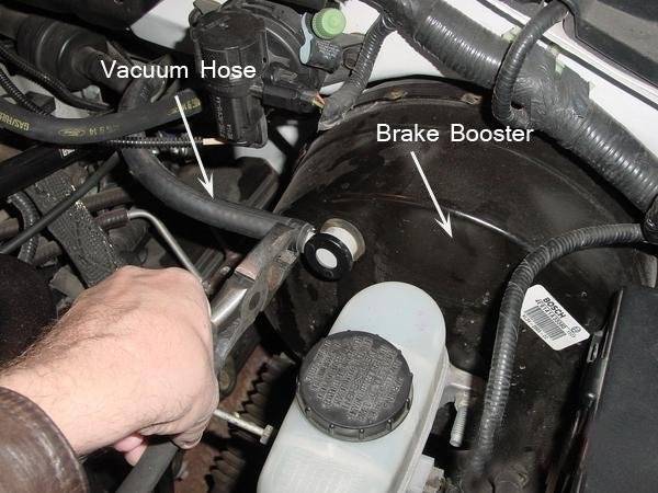

The photo below is the brake booster on a Ford F-150. If you could get all the stuff out of the way, the one in the Bronco Sport would look very similar. The vacuum hose on the Bronco Sport is in the same place as in the photo below.
Ford Bronco Sport Recall 21C31 16215-20759

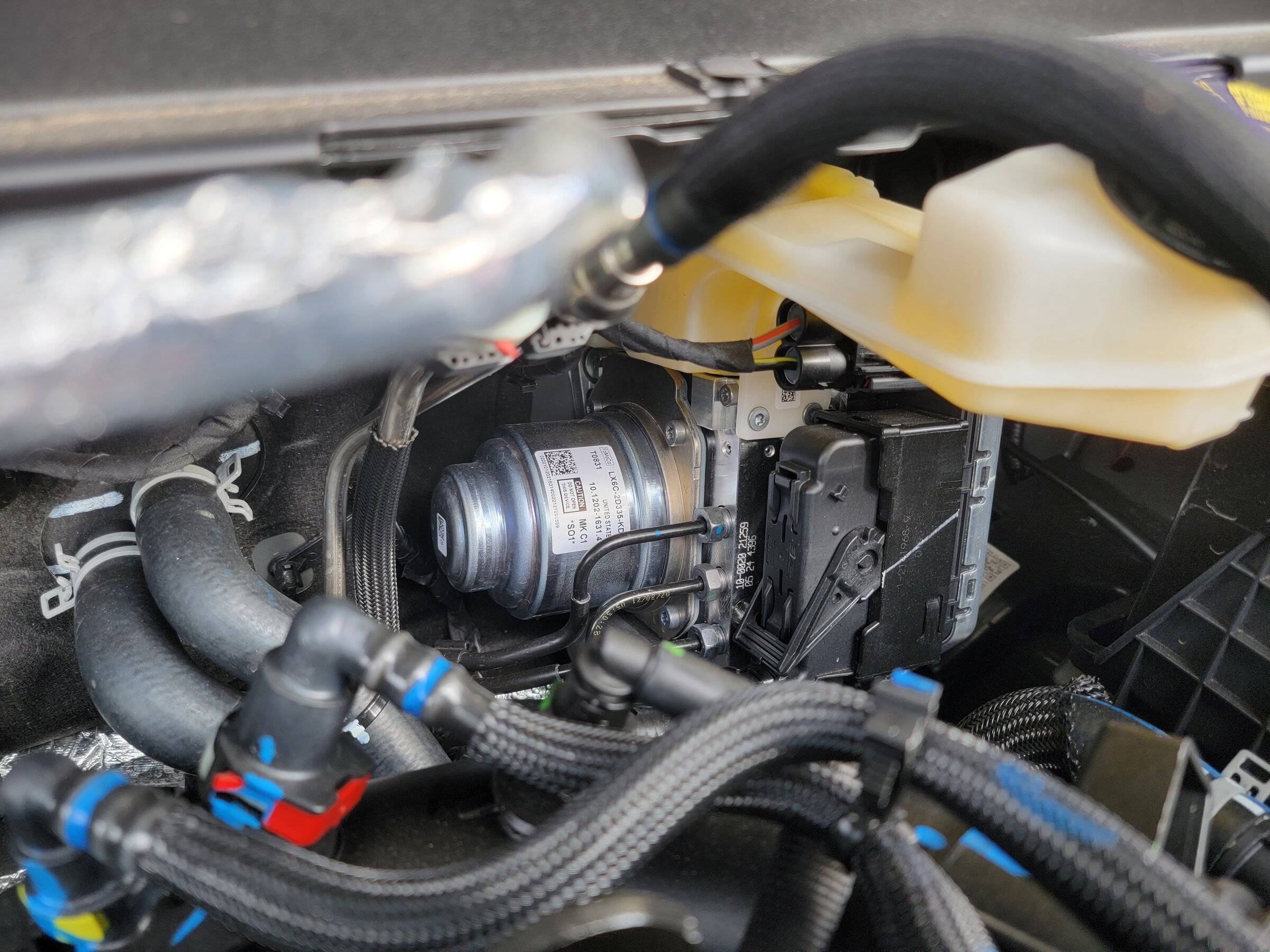

Here's mine. With the 360+. As you can see no vacuum lines or vacuum canister. So does appear there is 2 different boosters used.
Agreed. The electric booster strongly resembles the ABS module on my car, with the four brake lines going out to each wheel. It appears yours is an integrated system, i.e. the brake booster and ABS module are one assembly.

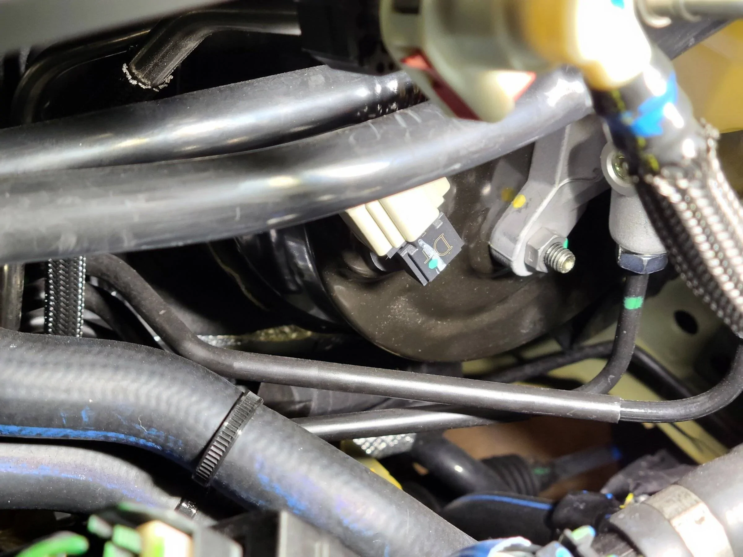

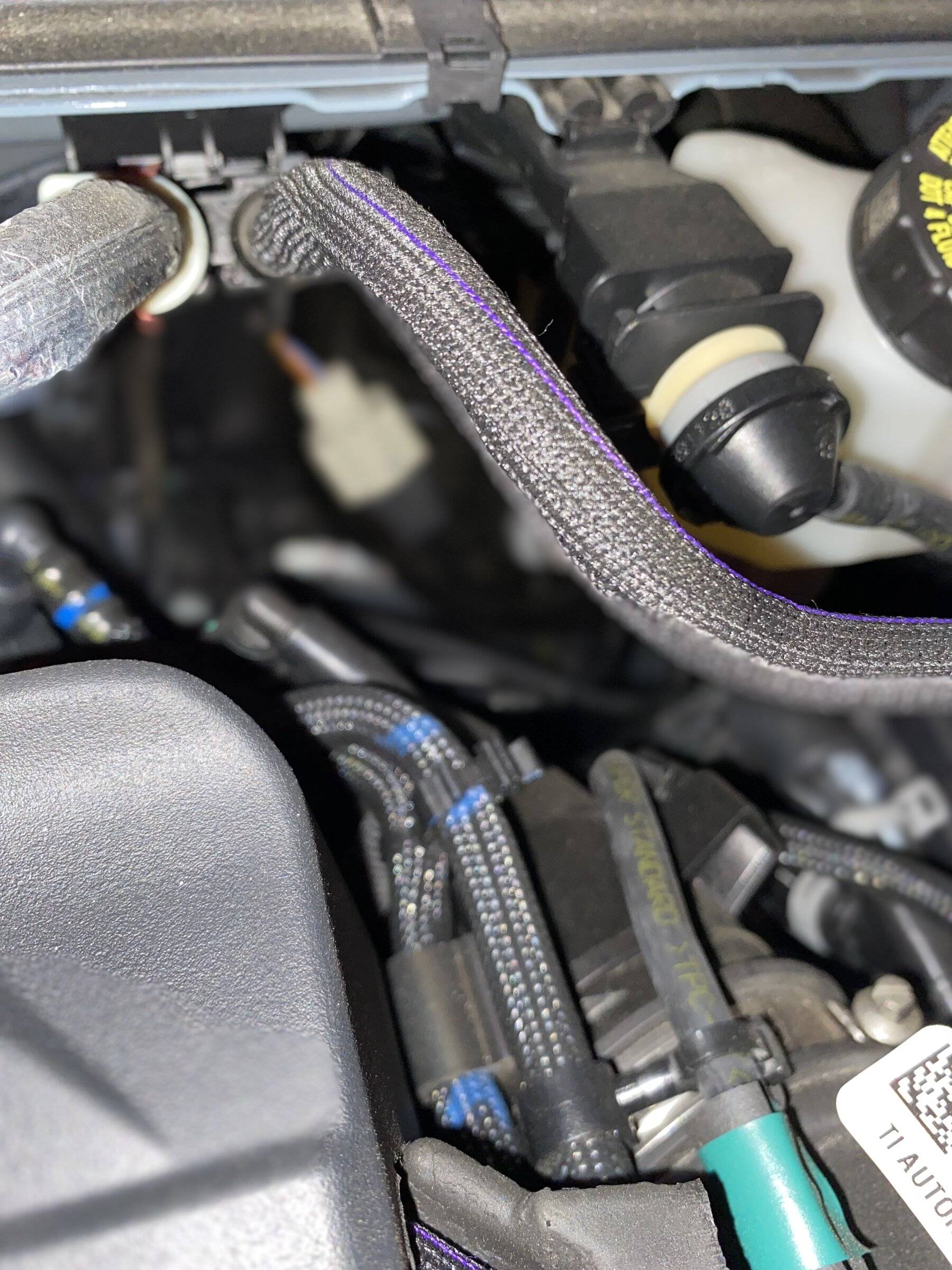

I looked at mine & took some photo's , ours has a Vacuum Booster , which is fine with me . The only thing I can see that looks like a sensor or what may be plugged into an electrical connection on the Booster assembly, is the white Plug that is blurred in the background of the first photo, if that is indeed what this issue may be about . We just done know yet .
