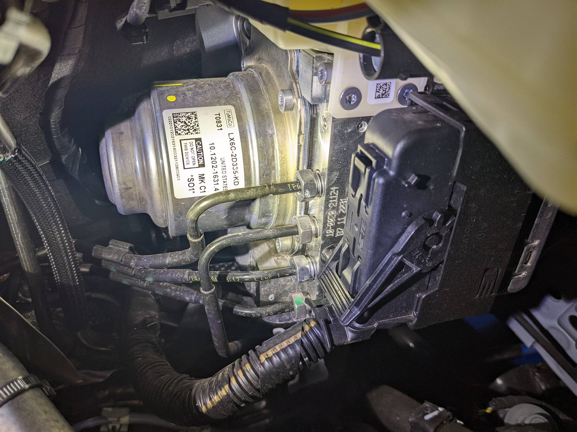

Reading the recall details, this recall will only be valid for Escape and Bronco Sport models utilizing vacuum brake boosters. My OB with Co-Pilot360 Assist+ is using the EBB Electric Brake Booster.
Interesting. Have you confirmed the brake booster in your car is not vacuum powered? I was fairly certain that Ford used only vacuum powered brake boosters in all Bronco Sports. Have you looked at yours? I'd very much like to see a photo if yours is different.

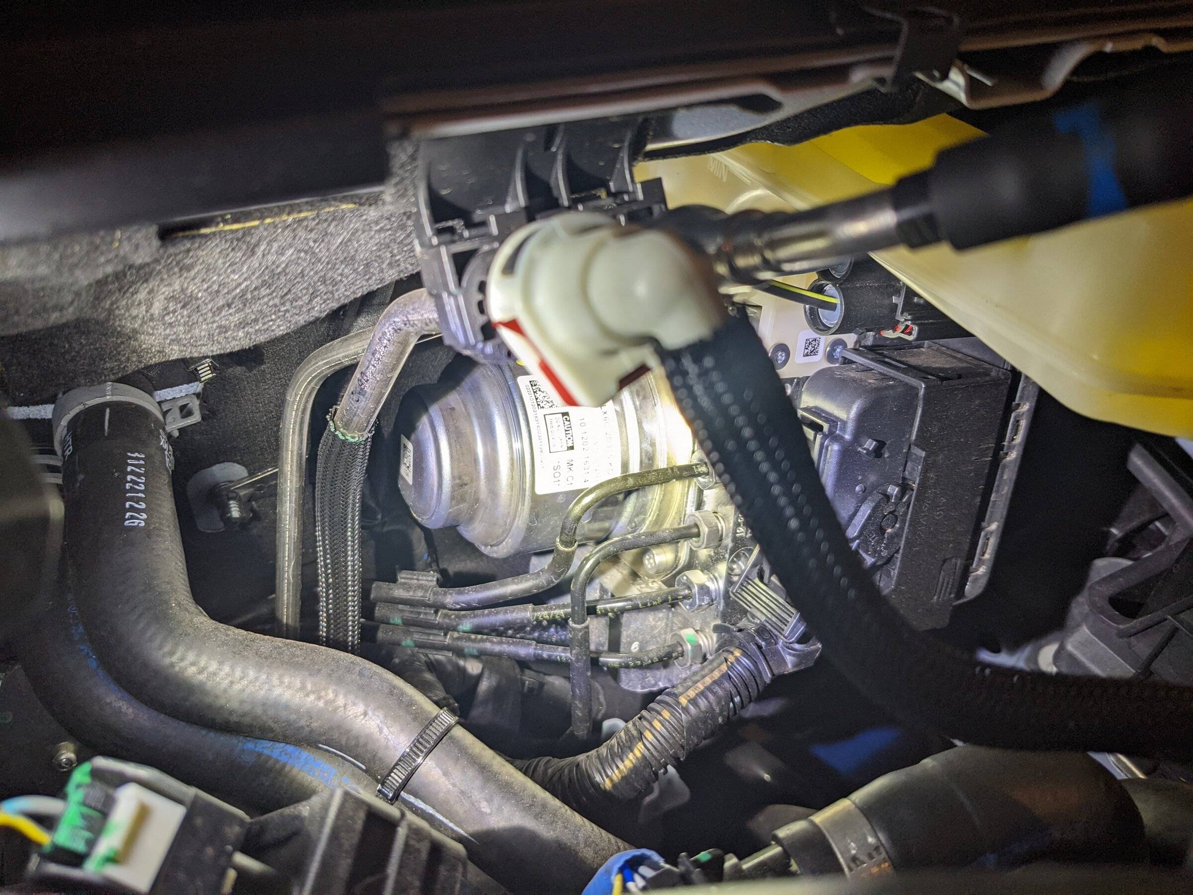

I do not see any vacuum lines connected to it and it does not look like a vacuum assist booster to me? Mine has 360 Assist+ option.

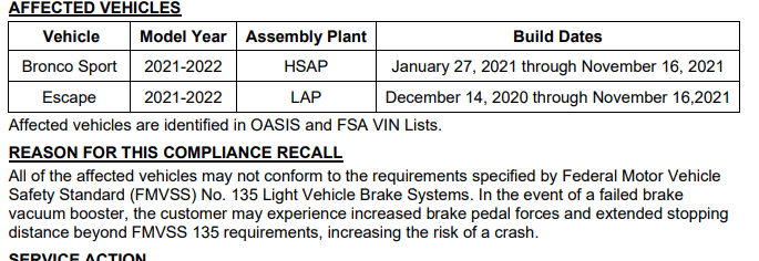

Short time lurker, first ever comment. I am a Service writer for a local ford dealership and a Bronco sport owner. There is a lot of confusion on this recall and not a lot of answers yet from ford (like any advanced notice). What I have been telling people is that if it was bad enough to cause a major concern they would have a fix already. I know that is not a great answer. but, we as service writers are given two paragraphs on an explanation and have 100 people calling asking about the recall a day.
As far as what is going to be replaced - we do not know. The recall on the app (yes I have the app too) says front brakes, the recall is titled front brakes on FMC dealer (what we use at the dealership). however, in the recall (see attached) it says about a brake vacuum booster. If I was to guess, they are going to replace the master cylinder and possibly a check valve. I do not think they will be replacing the actual pads, unless damages were done to them caused by another affected part.
